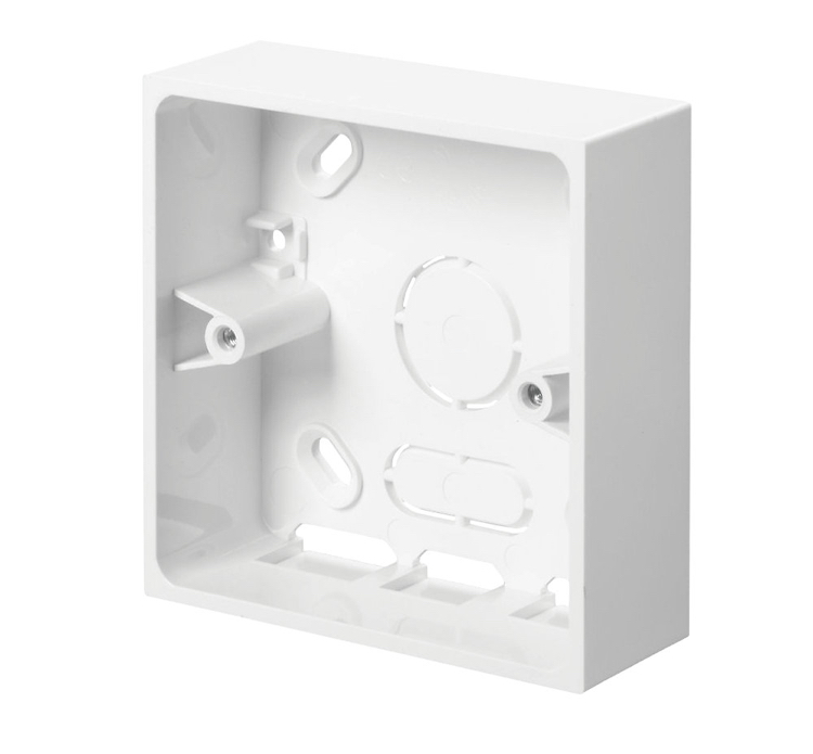

I am planning to poke a hole in the back of an existing socket box and use this to feed a FCU.
Once the cable goes through this hole and into the room behind it, it will travel upwards (in trucking) and then terminate into the FCU.
q. when I poke a hole through the wall, it is likely to be messy and wont be covered by the width of trunking. Should a different fitting be used on this entry and then merge into the trunking heading upwards?
Thanks in advance.

If it’s going in a cupboard, inside the cupboard, fit a 1 gang patress that has holes for mini trunking. Screwfix sell them. Part # 33772
pop a blank plate on the front, then you have a nice entry for your trunking and the monster hole you created will be covered up.
