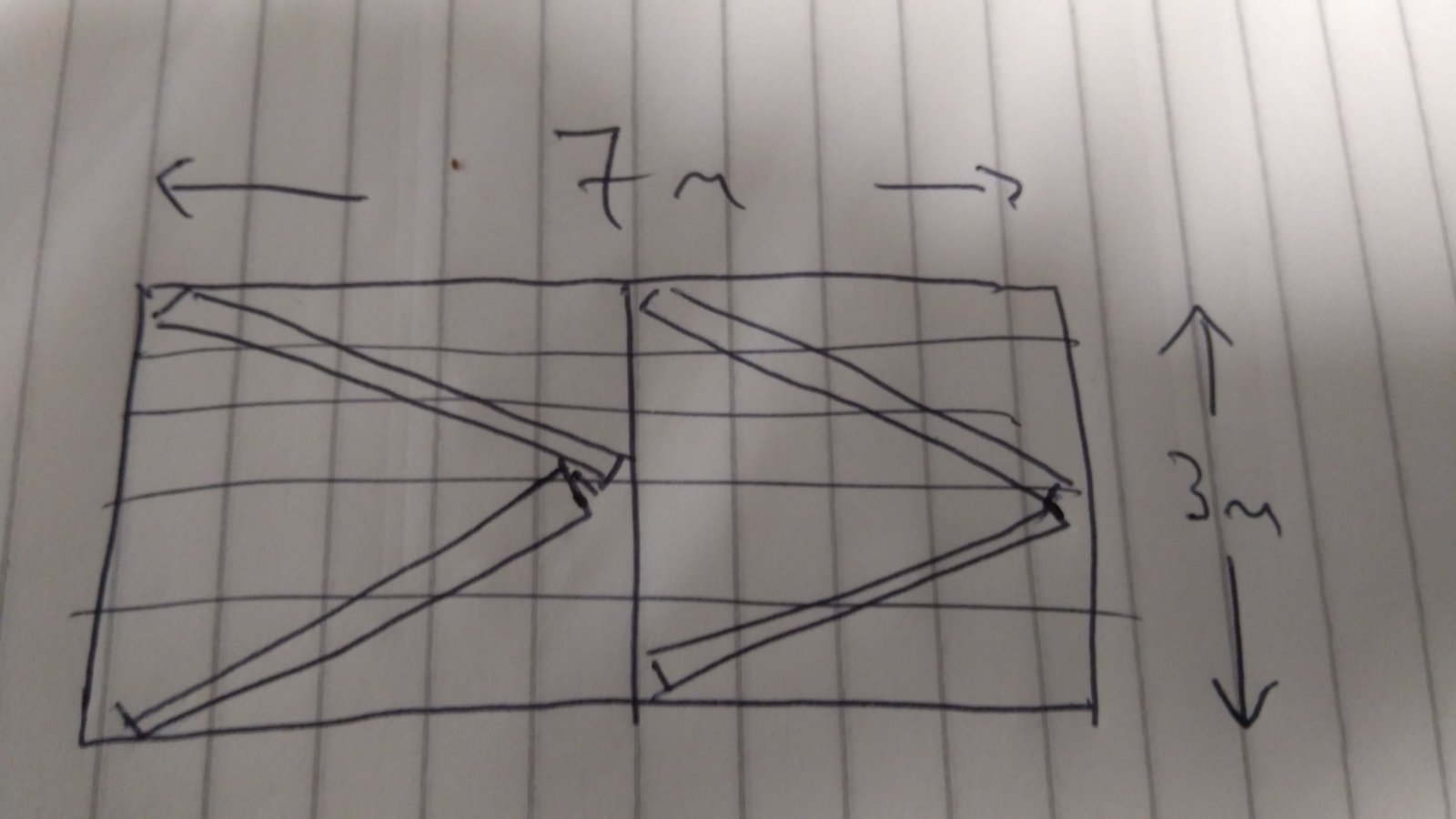

Thanks woody, yeah I wanted to do a W pattern but because the roof span is twice the width, the diagonals would be nowhere near 45 degrees. So I think I need to go with Xs. But if as Tony says I can just cross em over bending one across the other then it's not a problem
So if I do what I've sketched (badly) below, that's what I'd like to do, but it's my understanding that it's not valid as they're at nowhere near 45 degrees as it's such a narrow roof. They're at more like 22.5 degrees if you see what I mean

Where are you getting 45° from?
You brace from one corner to one corner under the top chord (rafter) and from center to corner on the bottom chord (tie), and then across the trusses at 90° at each junction of the chords and braces (ie whereever there is a nail plate)

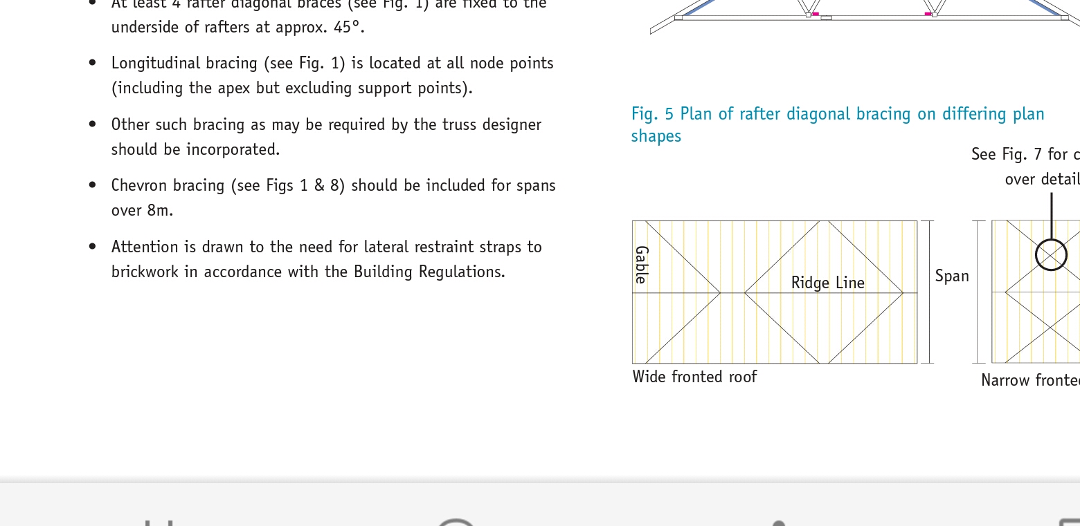

From the doc you linked to above
Top left corner of screenshot = says 45degrees
Pic in bottom right corner = mines a 'narrow fronted roof '
Tempted to just do as you say, but definitely suggests otherwise in the doc
