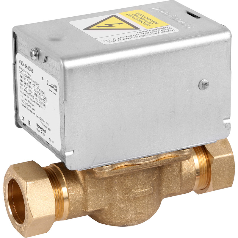

Firstly I’d be checking the motorised valve, as this would be sending a signal to be on, not the trv. These have an end switch that when activated send power to the pump and boiler to fire up.

What valves are on your downstairs rads ,post pics please. Do you have two timers for up and downstairs zones ?

Valve(s) usually where the hot water tank is, sounds like you have zoned heating.
A bit like one of these:
@ianmcd yes he def said the radiator valves as he was saying we needed to replace them all. If he had meant zone valves surely we would only need to replace one as the upstairs and hot water are ok.

Changing the TRVs will do absolutely nothing
I think your heating valves are the Siemens ones below, the switch is inside the valve, and it’s not always possible to know by looking at the lever as not all of them move.
Ah, so one for the hot water (honeywell) and two siemens - one for each zone of heating. That makes sense! Thank you.
Yep, got it. Now to figure out if one is keeping open. Try moving the lever/slider for any resistance.
