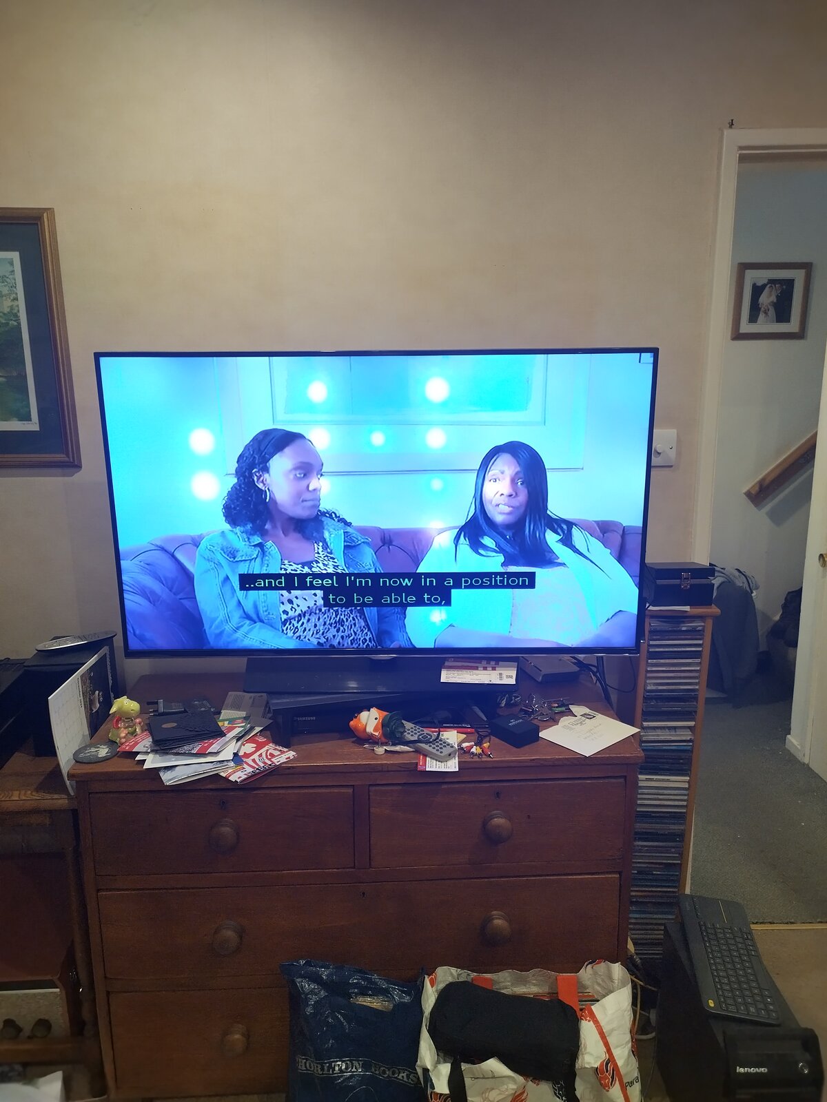

Here is our existing TV. It's a 48" set, but we will be replacing it with a 55" set, mounted on the wall behind.
The current TV is almost the width of chest and the larger TV is approximately 150mm wider.
I propose to move the light switches over to the architrave, possibly mounting them vertically.
My dilemma is: do I fix the TV direct to the wall and sink some trunking into the wall, or do I fix some kind of timber structure to the wall, behind which I can run the cables?
The cables will be the power supplies for the TV and a streaming stick, a gaggle of HDMI leads, co-ax, soundbar leads and a Cat 6 cable.
If I go for a timber structure, I'm not sure of the extent of it?
Should I go floor to ceiling and if so, should I continue the coving around it?
Or should I just finish the timber just above the top of the TV?
I need some pointers really, about what looks good and what would look ridiculous.
If it's a solid dividing wall, you're gonna struggle with getting that many cables in the wall. There is guidance on how much of the wall you can chase, buts it's something like 20-30% depth.
Also, your point about moving the switch, if it's a stud wall, you're gonna have studs around your door frame that might spoil your plans. Or if it's a solid wall, to keep your zones correct, you'll have to rechase the whole cable.
All of the above means a custom timber type structure would be much easier and less messy.
This kind of stuff is pretty popular nowadays! You could build it off the wall a little and run all your cables behind it and be able to run new cables in the future.
Thanks, guys.
Is it a solid wall or a stud wall?
Either way, why not run the cables in the wall?
Cinder block.

I'm familiar with the chasing depths. I will make sure the wiring is still in zone.
Yeah, I think I'm leaning towards this solution.
