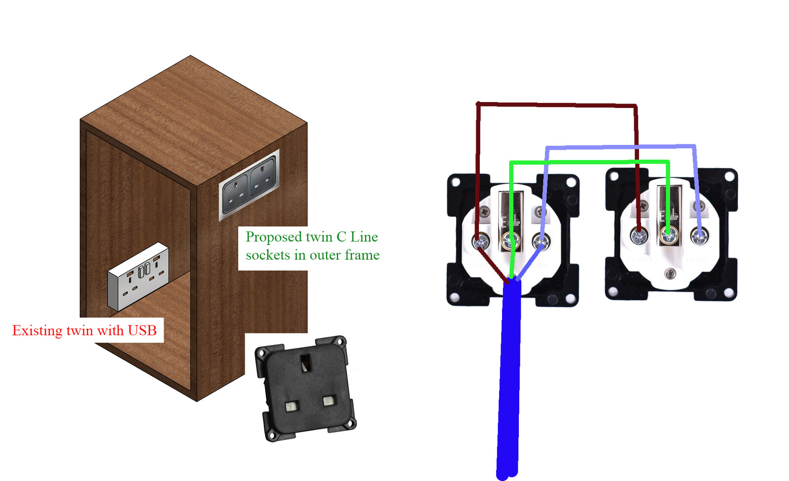

For some reason the manufacturer decided to place the power sockets inside of existing cupboards. This is inconvenient and we want to relocate position to outside of cupboards. To this end I have just purchased a couple of C-Line sockets and a double face frame.
The attached image shows the original twin switched plus USB socket and the proposed new install to outside cabinet. At this time I am unsure if we should keep the interior twin with USB charging (just for charging purposes only) and just take a plug and lead from one outlet to the new site or remove completely and replace with a junction box and cable from there to the new site.
In either case is the proposed wiring shown on the right hand side acceptable/good practice?
Thanks in advance for your opinion/suggestions

I can'see any reason not to keep the exsisting one, but I would fit trunking running around the inside of the cabinet rather than just clipping it.
DO ensure you use flexible cable(s) and NOT twin + earth for this boat/caravan mains wiring.
You will, of course, also need a suitable double back box to contain the exposed terminals on the rear of the C-lines. Or two single back boxes when there'd be a need for some outer sheath on any exposed bit between the two.
+1 for leaving existing in situ.
There is no point in two sockets like that, each supply needs its own RCD protection. And if two sockets, what else has been missed, a TN-C-S supply is not permitted. And one has to be careful with galvanic protection. It can get rid of your anode in days if not correct.
Hull material is important, aluminium is a big problem. Steel not quite so bad, but likely needs some earth diodes to stop erosion.
This is rather a specialist subject, may be better on a narrow boat forum.
Thanks definitely planned on flexible cable in trunking. Back boxes are supplied these are round seperate for each socket. Will look to see if there is a suitable double back box or may even resort to design and print one!

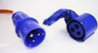

You're looking at section 709 of BS7671, I only have the 2008 edition, 709.553.1.8 Socket-outlets shall comply with BS EN 60309-1 above 63 A and BS EN 60309-2 up to 63 A.
I don't think a 13 amp socket complies with BS EN 60309-2, you're looking at these
I think.
I don't think a 13 amp socket complies with BS EN 60309-2, you're looking at these View attachment 398331 I think.

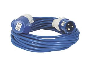

Not that type as that is what I would class as a shore power lead, i.e. from the marina outlet to the boat to supply 240 volt. My shore power lead like this

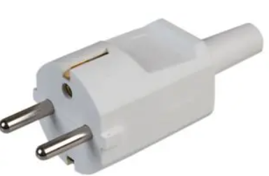

I do however have another area where there are the original twin Schuko sockets. I intended to use the free socket to plug in an extension to the engine room which will be fitted with a Powertxt switch to operate twin tube heaters for the up and coming cold months
To that end I purchased this:
https://cpc.farnell.com/pro-elec/ec...6730&s_kwcid=AL!5616!3!491034915811!!!network
The assumption being that as these are sold in the UK from reputable(?) suppliers that they would be legal!

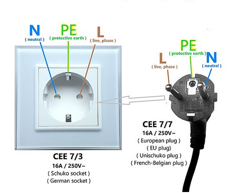

I can see that there could be issues due to potential wrongful reversal of live and neutral. I believe that this (attached) is the correct wiring for both socket and plug.
So now my dilema. Should I continue with the neater solution of the purchased Schuko into the original twin socket Schuko install ? Or take the less favourable route (to me at least) and see if I can fit an adapter to take a standard UK plug, which makes for an unwieldy install ?
The point is that the Schuko plugs can be inserted upside down thus reversing the polarity.
This doesn't matter where a suitably rated circuit over-current protective device is in the Line conductor.
The trouble is with the U.K. Ring Circuit which require a fuse in the plug [edit] to be in the line conductor because the appliance flex is too small for the circuit OPD.
So if I am understanding correctly it looks like it may be a better/safer way to go with something like this to convert the Schuko F sockets to a UK standard fused plug? :
