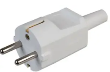

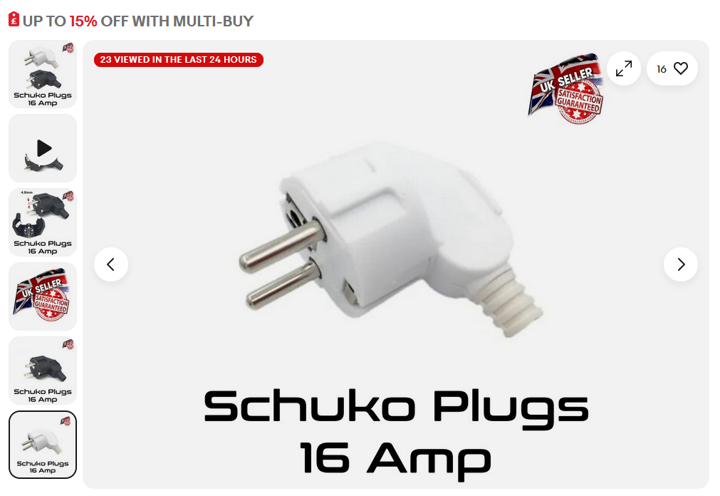

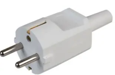

Yes it is the type F, actually the one I have is right angled and due to the flap on the socket could not be inserted upside down anyway.
This is the one:

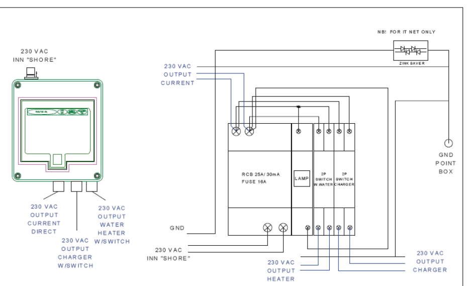

Is the Schuko socket protected by a 10 or 16 A MCB?
All sockets protected by a 16A RCB (see attached) for shore power. There is also a generator on board which I assume has been correctly installed and would be covered ?

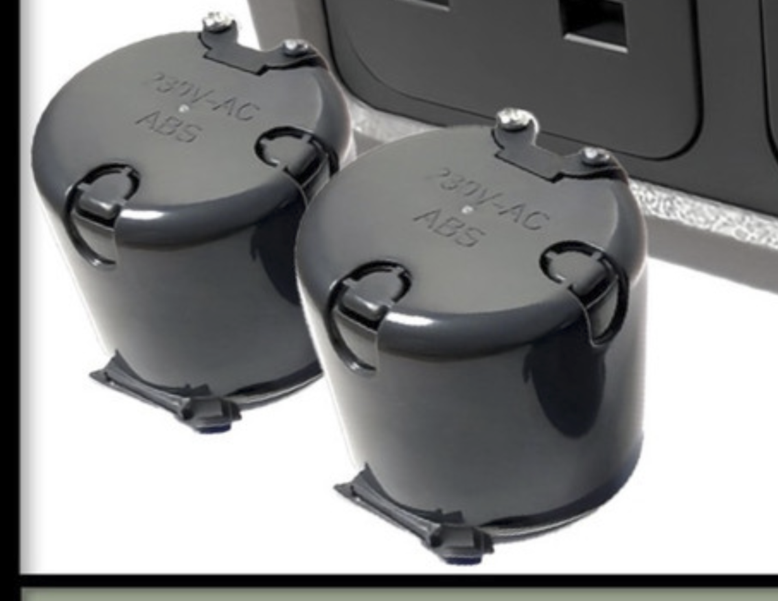

For the sockets that have been fitted in cupboards I have purchased twin C line surface mounted (image attached) to be positioned on the outside face of the cupboards. Rather than remove the original sockets I have decided to leave them as is and just wire the new C line sockets as a fixed plug in extension and run the cabling up in trunking, thereby keeping the original system intact at least for now (other than the holes in the cupboards) :LOL:
As to the Schuko type there is only one double socket fitted currently with one in use. The plan is to now use the spare Schuko to run a lead into the engine bay which will serve to allow a couple of tube heaters on a Powertxt unit to automatically switch on when temperature drops below a certain point and off again once the temp back to normal level.

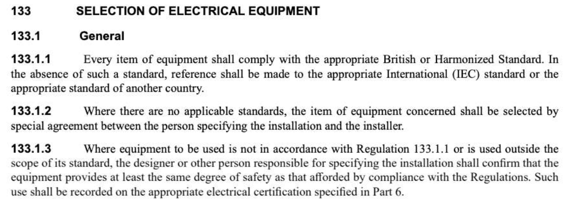

I do not really think there is a problem with Schuko or 13 amp sockets, I know my son's boat had a warning lamp to say if reverse polarity, and his shore supply only powered a class II battery charger, all the boat's 230 volt sockets were supplied from the inverter, so the shore supplies earth did not connect to the boat.
However, if inspected, it depends on how pedantic the inspector is, Schuko sockets are not permitted in the UK, you can have Schuko plugs, and 13 amp to Schuko adaptors, but not a fixed Schuko socket to comply with BS7671.
BS7671 also requires the use of the blue plug and socket for the main supply to the boat, I am not sure about the RCD, poor name as easy to get recreational craft directive (RCD) and residual current device (RCD) mixed up. He fell foul of the RCD with his AGA stove, and I could see no problem with it, and the use of the diodes in the earth I know are required, but it goes against the grain. The idea is you can have 1.2 volts before any earth current flows, so it does not damage the hull, I see you have it fitted
but with a plastic hull not sure if it is required or wanted? The idea with a metal hull is the hull as a very good earth, not so with a plastic hull, and since piloting a narrow boat seems to be a contact sport, not sure, I like the idea of a plastic hull.
I would suggest going on a narrow boat forum, as it is really a specialist subject.

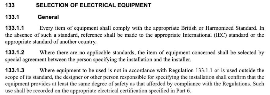

709.553.1.8 Socket-outlets shall comply with BS EN 60309-1 above 63 A and BS EN 60309-2 up to 63 A.
553.1.2 Except for SELV or a special circuit from Regulation 553.1.5, every plug and socket-outlet shall be of the non-reversible type. With provision for the connection of a protective conductor.
