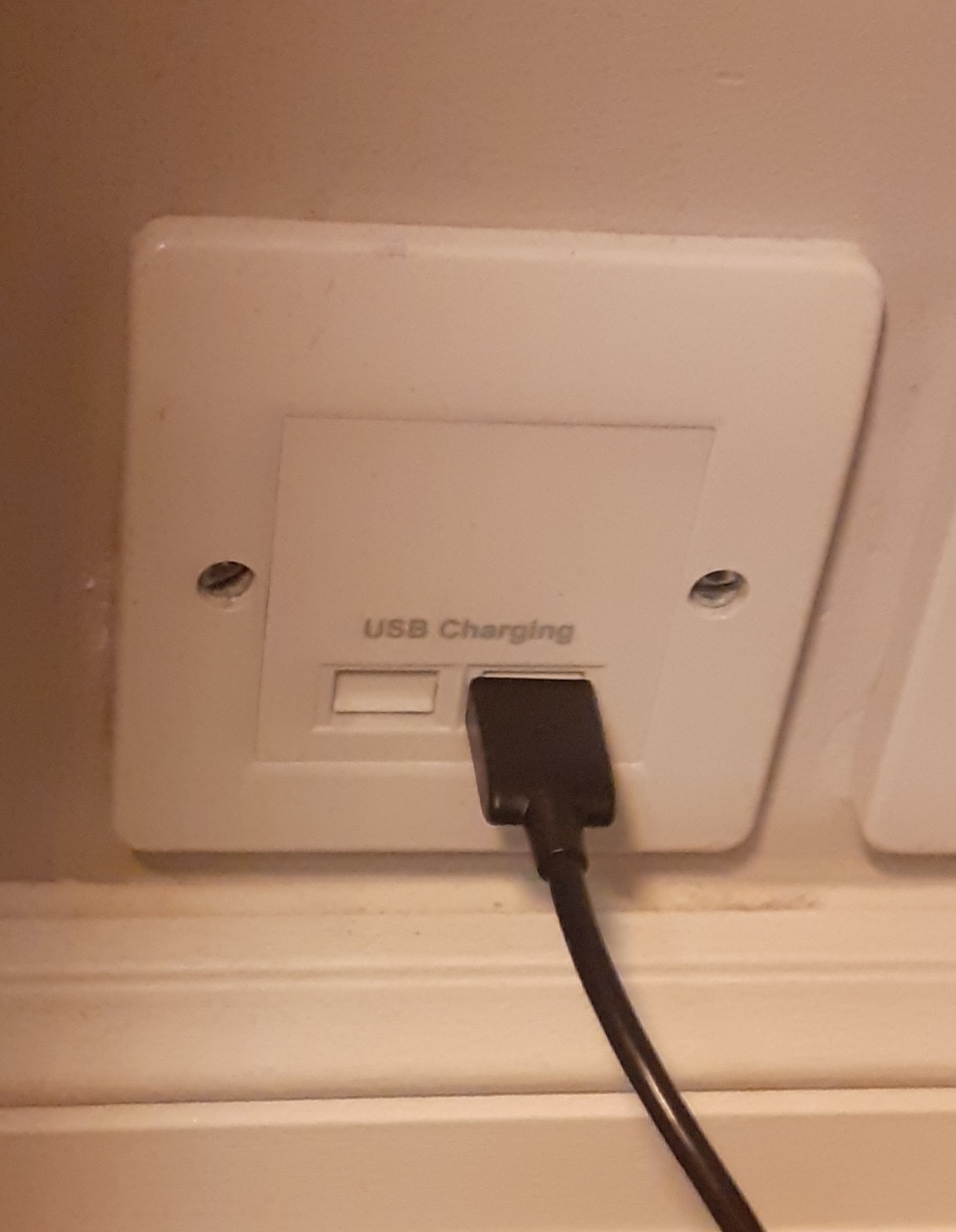

A 2 gang back box will be fine, USB module in one side, single socket module in the other. 20210902_195120.jpg20210902_194601.jpg

According to the catalogue, the MK Logic Plus 2G socket with USB switches off once the shutters are down.
But they need a deeper box than 25mm. With three cables in the back box, I just about got away with a 25mm recessed box and a 20mm spacer between the wall and the socket front plate.
I don't think they have shutters though ! :LOL:
From the current catalogue:
'MK Electric USB charging solutions are also designed with inherent safety features such as overload protection and automatic disconnect on the modular product when the cable is removed.'
It refers to the module I've already mentioned, not the 2 gang sockets :)
