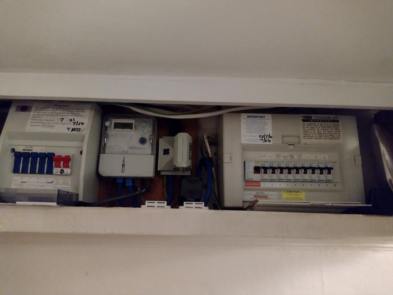

We have recently moved house.
The new house has two consumer units.
One for the main electrics (lights, plugs, kitchen etc) on right side of photo.
The other is purely for electric radiators (not storage heaters) on left side of photo.
The one for electric radiators only gets power during economy 10 off peak hours.
We want to keep the electric radiators but be able to use them when we want.
Any ideas on what is required to do this? (in dummy terms) :)

... The new house has two consumer units. ... One for the main electrics (lights, plugs, kitchen etc) on right side of photo. ... The other is purely for electric radiators (not storage heaters) on left side of photo. The one for electric radiators only gets power during economy 10 off peak hours.
That sounds a bit daft, the E10 off-peak hours are presumably the very time when you do not want electric heaters to be on, aren't they (unless you are a permanent 'night worker'!)? I would guess that there once were storage heaters.
Probably very little. You probably simply need to get an electrician to move the connection to the second (heaters) CU to the same electricity source that is powering the other CU. An electrician who had seen the current setup could easily advise what would be needed.
You then will need to decide whether it is in your interests to retain E10. I (with my E7, but no storage heaters) am seemingly an exception, but for the great majority of people E7/E10 tariffs end up being more expensive if one does not have storage heaters.
Kind Regards, John

Hi John Thanks for your reply. Yes I believe originally storage units were in the property. The previous owner changed them all to electric radiators, however the wiring was not changed/tariff remained on economy 10. Exactly as you said heating comes on at completely the wrong times.
Indeed.
We definitely want to change to a one rate "normal" tariff, however the energy company aren't much help.
You perhaps need to suggest to them that you are seriously considering 'swapping' to a supplier who is prepared to change it to a single-rate tariff - they might then become 'more help'!
Would it be better to combine both consumer boards into one? Or does that not really matter?
The latter, really - "doesn't really matter". If/when it comes time to have your electrical system upgraded (or completely re-wired) you might then want to 'tidy' it all into one CU.
Just one point. Not unreasonably, regulations require that there be a 'single means of isolation' of an entire electrical installation. You therefore probably need to talk to your electrician about having an 'isolator' fitted upstream of the two CUs, otherwise you would have to 'switch off' two CUs separately to kill the whole installation.
Kind Regards, John

So I assume the order would be:
1. Electrician to move the connection
2. Current or new energy supplier to change tariff
3. Current or new energy supplier would change existing dual rate meter to a "normal" single rate meter?

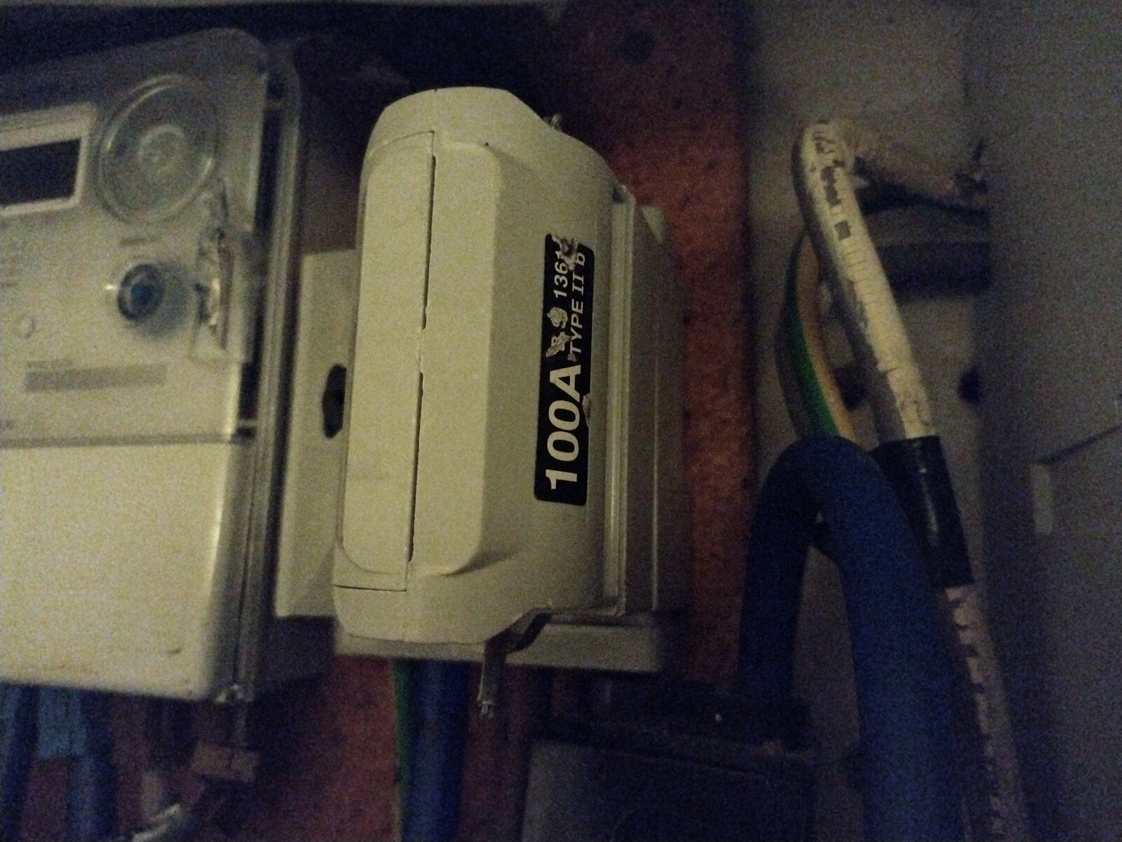

It is common for buildings to have multi-supplies, and only real way to have common isolator for an economy 10 and standard supply would be the fuse or isolator provided by the supplier, it would be impossible for anyone but the DNO to arrange it.

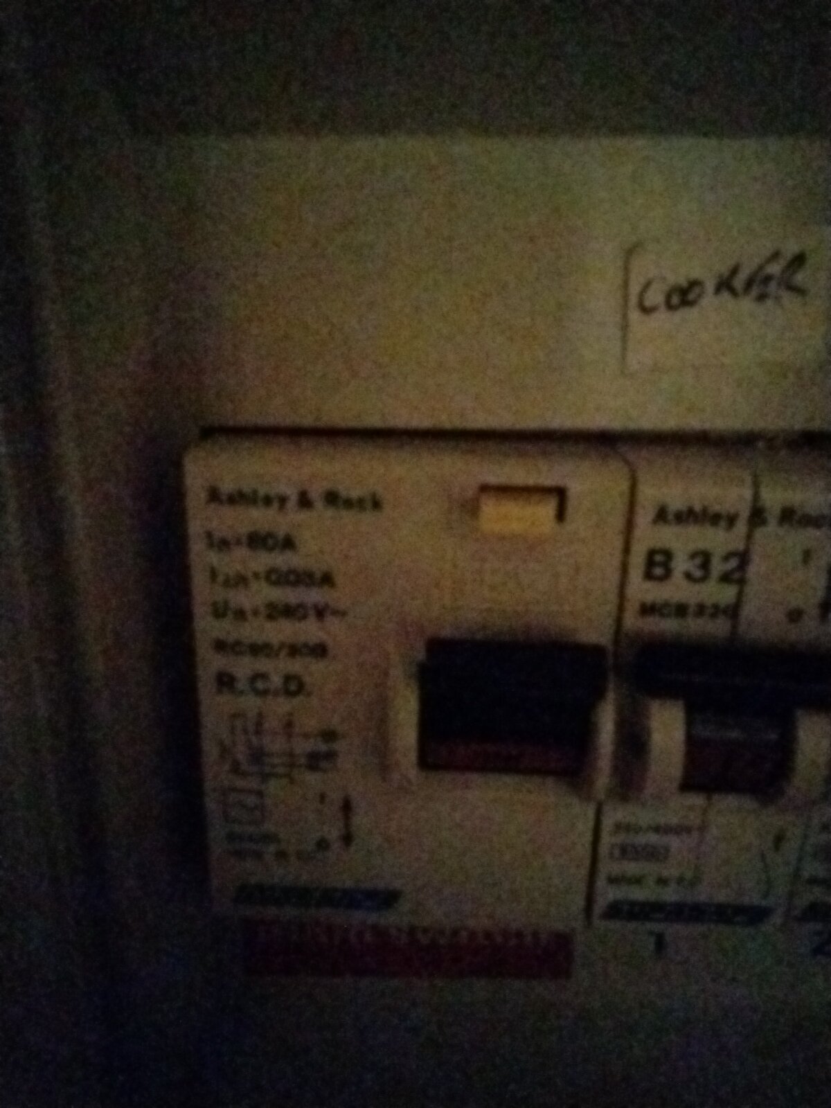

What I see as a problem is the single RCD, can't read what size, may be 100 mA or 30 mA, but seems likely some one has changed the isolator for an RCD, personally I would use RCBO's but the off peak box has no RCD or enough room to fit one unless it replaces the isolator.
Hi
Have put a photo attached of what I think is the RCD?
This

Are you sure ...
Well, it's what I have always understood, and it certainly sounds reasonable/sensible to require a single point of isolation for an installation. Do you not interpret ...
BS7671:2018 said:
462.1 Each electrical installation shall have provisions for isolation from each supply.
462.1.201 A main linked switch or linked circuit-breaker shall be provided as near as practicable to the origin of every installation as a means of switching the supply on load and as a means of isolation.
... as having that meaning?
It is common for buildings to have multi-supplies, and only real way to have common isolator for an economy 10 and standard supply would be the fuse or isolator provided by the supplier ...
I must say that I've never really thought of that issue. However, what you say is not really true, since it would be simple enough to isolate both supplies (standard and E10) together with a 4-pole isolator (i.e. one 'designed as'a 3P+N one).
