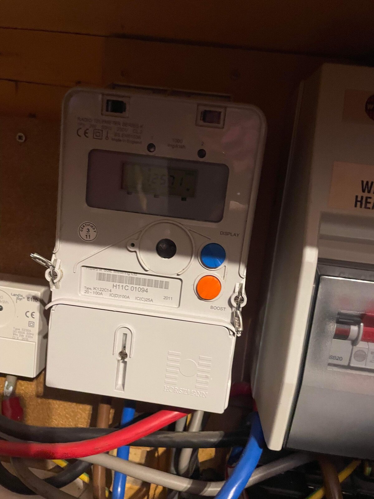

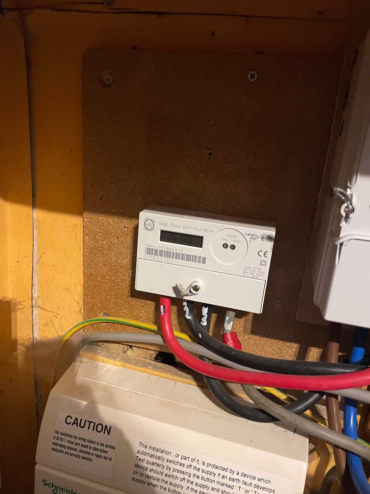

Hi so basically I’m writing this to find out about these two meters in my old grannies house. I don’t think it’s right or she’s doing something wrong.
She has these two meters! She gives two readings.. which I don’t understand really as I only have the one meter.
They have put up her direct debit to £485 a month and I’ll more than half that in my home. She’s on her own there and basically stays in the lounge.
Can anyone explain why two meters and also how to read them properly.
Many thanks

The one on the right looks, to me, to be a smart meter.
Is the one on the left the meter she has always had? If so, then that should have been disconnected when the other meter was installed.
It may be that, because the old meter was not removed at the installation of the new one, the supplier now thinks she has two supplies on the one account. Hence the extortionate DD
Contact her supplier for someone to come out urgently as they have scared the living daylights out of her by asking for so much each month.
If she gets paper bills, (and keeps them), have a look at them to see when the new meter was installed. The first bill should be with an original reading of the new meter starting at 00000 The old meter bills should show the reading for the day the new one was installed. Anything after this date should not be taken into account because the new bill is registering anything used after that date.
Does she have solar panels? I believe the one on the left is a feed in meter to track how much is generated by the panels to feed back in to the grid. That's just from a quick Google search though so I could be wrong.
Also, the "boost" button on the other one suggests it could be a dual tarrif meter (e.g. economy 7). Does she have storage heaters? They can be expensive to run if they're not setup right. And make sure if she's on economy 7 that she's getting both readings from the main meter. There'll probably be a button on it to show the two readings. If she's submitting the reading from the feed in meter instead of the off peak reading, that could throw her bill way off. Again, this is mostly just guess work, someone more knowledgeable might be able to help.

I’m guessing she’s been supplying the reading from the one on the left and the one on the right instead of.. the two readings from the main box on the right.
On reading I see that if you press the blue button it gives day time reading and press again for night time so maybe she should only be doing that??
Unfortunately she’s miles away but I will be going down on Wednesday and trying to work this out, she’s been paying it for years and it’s going up and up. She doesn’t have storage heaters.. she has two Fischer heaters. One in the lounge and one in the hallway. All very odd to me.

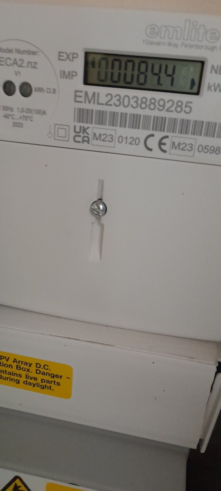

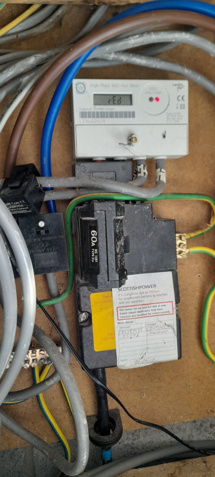

I also have two meters. 20230908_131457.jpg this shows import, and this Export meter reading 13-9-23 3 pm.jpg export, it does seem strange as the second meter seems to have the option to do both, but the import meter shows two readings when solar panels are working one a number the other rEd and it alternates between the two readings. I am told it stands for reverse energy detected.

The Horstmann meter with the orange and blue buttons is a dual register, normally used for Economy7 heating or similar.
It has 2 readings, which can be seen by pressing the blue button multiple times.
The other smaller white meter is single register, and would be used for a standard single rate supply.
If all 3 are in use, then it may be one of those 'total heat total control' efforts available in some parts of Scotland and possibly others where you have 3 readings for hot water, heating and everything else.
No point in having E7 or anything like it then. A single rate supply would probably be cheaper.
