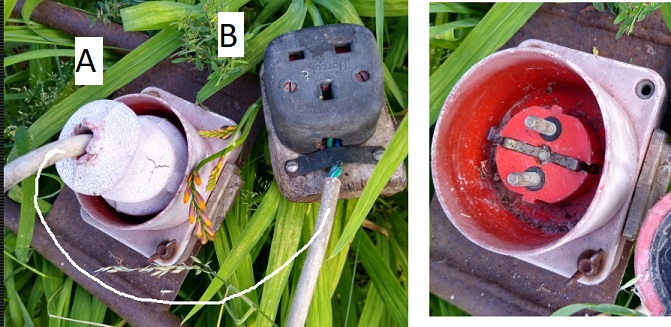

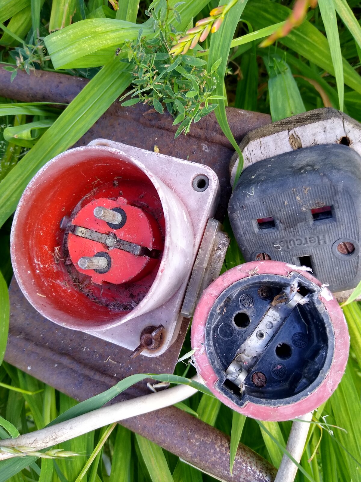

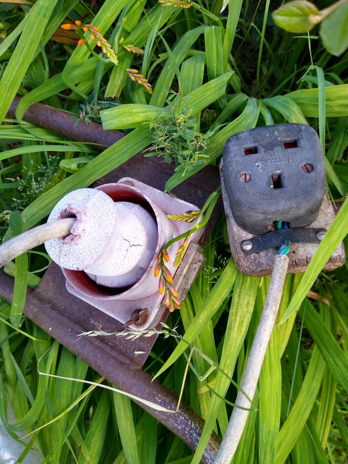

Dodgy set up on wolf tools hover mower here. Very old machine.
From pics can you advise what lead to search for.

It works though.
Just would like to know what 2 pin lead with cable to search for.
It's a German Schuko trailing socket and plug.
It might have only two pins, but the other bit of metal is the earth connection.
Just get a new three-core cable and fit British socket and plug.
Does socket A connect directly to socket B via that white cable. ?
If it does then the exposed pins in the red plug would have to be Live to get power to the 13 Amp socket via the white lead,
Exposed pins that can become Live are extremely dangerous,...
You need an electrician before you get a need lead.
Second thoughts
Is the red plug fitted on the mower, if yes then where does 13 amp socket B connect to ?
Still dangerous if the power comes out of a 13 amp plug into socket B
Yes. Red plug socket is on lawnmower.
The other on short white cable is the dodgy connection setup which I have removed
As as you say it must be dangerous.
