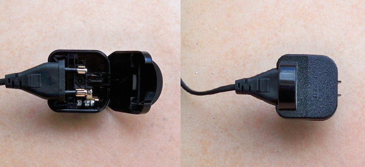

I have a battery charger with a European 2 pin plug fitted . I have just noticed that the three pin plugs on other appliances I have are actually adaptors which accept the two pin ones inside and the pins locate in the live and neutral terminals .
How do I identify the positive and negative pin on the european 2 pin plug on the charger so I can fit it the right way ? There's a "N" and a "D" on the plastic plug , I'm assuming that's neutral.
Also what fuse would you use , the appliance manual says 3 amp, if a 13 amp BS1363 and 5 amp for "other" types of plug ?

It's a car type 3 stage charger . I'm putting the attached 2 pin plug into the 3 pin for use here in the UK. to use manual says to be connected to 240V 50Hz . The 3 pin plug is the type that opens up and you place the 2 pin one inside locating the pins in the live and neutral positions .
There is no such thing as
in AC circuits!
The pins can go either way round.
If manual says 3amp fuse, then 3amp is what you should use.

To comply with the law a UK supplier has to either fit a UK plug or attach a converter, supplying a converter socket does not comply, it needs to be fixed to the original plug, so the converters you are looking at are a way around the law, rather than some thing strictly required. If the suppliers cuts off the plug and replaces it, he needs to show the staff used is qualified to do the work, but using the adaptor gets around the problem, they simply can't be fitted incorrectly, so skilled staff not required.
Because I worked around the world I liked the adaptors, easy to remove when I went abroad, however your unlikely to take your car battery charger abroad so cut off the original plug and fit British is likely best option.
The type C plug is rated at 2.5A in Europe, so 3A fuse is ample.
I have two options there , the adapter is the quick option there , fitting a plug would be no problem either (does that make me skilled staff ?):)

Like my pictures?
Line and neutral, as has been said. It doesn't matter which way round.
