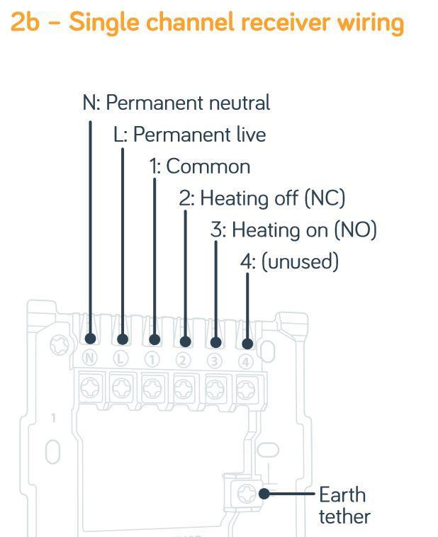

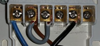

I have just bought hive single zone kit including hub. I have underfloor water heating in one zone, which I intend to control via hive thermostat. This would have its own two port valve.
The second zone is upstairs with radiators, with a dedicated 2 port valve. I plan to control this via a wired thermostat
My boiler is Vailliant ecotec, its a cobi boiler with no tank
Can you advise how to wire the above setup please, thanks.
Don't underestimate the work involved in this. I don't know your level of skill, but this is only a job for someone who has a high level of electrical competency, and can understand what they are doing when connecting wires from one point to another.
The Hive single channel Hive receiver has the connections below:
The Hive (N) & (L) should be connected to the N and L 'load' terminals of the same 3A fused spur as the boiler.
The Hive (L) will also need to be linked to Hive terminal (1) 'common'
Hive Terminal (3) 'heating on' is the live supply that goes to the underfloor heating motorised valve's live wire. The motorised valve will also need a neutral, again from the same supply as the boiler.
The upstairs zone will be the same in principle, but as you don't give a make / model of the wired thermostat, I can't tell you what terminals to use. If it is battery powered it won't need the N & L
Each of the motorised valves will have an internal microswitch (orange and grey wires) The orange wires from both valves are connected together, and the grey wires from each valve are also connected together. They will now provide a voltage free switch. When the existing room thermostat is removed, the two thermostat switching wires now go to the orange and grey wires.

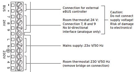

Could you please tell me where does LR orange wire go. It's mentioned in the top left hand box. It's says. Let orange to boiler terminal, which terminal would that be??
If your underfloor heating has it's own zone valve you wire hive into that valve to control it
Like I said..
the orange and grey wires would go to the terminals inside the boiler that are provided for use with an external room thermostat.
There are several of versions of the Vaillant ecoTEC and the terminals are not the same for all of them. Here's an example of one, but it's quite possible your boiler's connections are different. If so, you will have to consult the installation manual specific to your version of the boiler which will show you which these terminals are. But don't forget!. If you find it is necessary to open up the room sealed part of the boiler to access them it's a job for an RGI.
In this example, the orange and grey wires from the motorised valves would go to terminals 3 & 4. They will work either way around, but convention is that:
3 is the 'Live supply' (goes to MV grey wire)
4 is the 'Switched Live' (goes to MV orange wire). As you don't have a thermostat now, a 'bridge' or 'link' will be fitted to these terminals to complete the circuit. This should be removed first.
Like I said..
