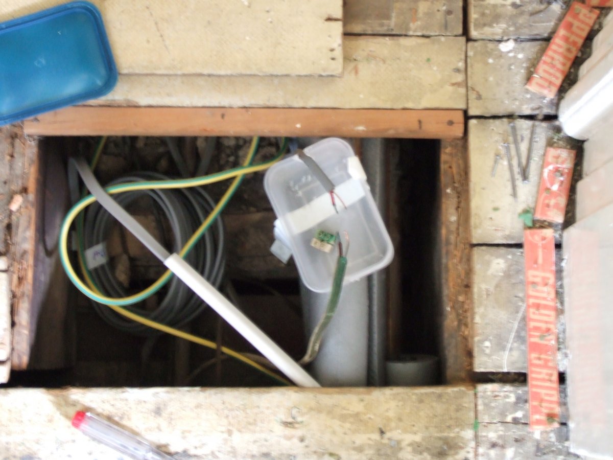

that enclosure
It was to keep it from dripping while I went to get a JB. I came across it while I had the floor up for another reason. I put the floor down to prevent anyone falling down the hole while I was gone.
Lucky I had it handy, really.
Blimey - I don't think I'd have bothered to cut slots in the sides of (and thus ruin) a container like that, or tape the lid down, for such a short-term use. Even if I had to go and buy a JB.
Blimey - I don't think I'd have bothered to cut slots in the sides of (and thus ruin) a container like that...
I get umpteen such containers from the takeaway nearly every week :) They are very much 'disposable' ( keep and use as many as I can, but there is a limit!)
