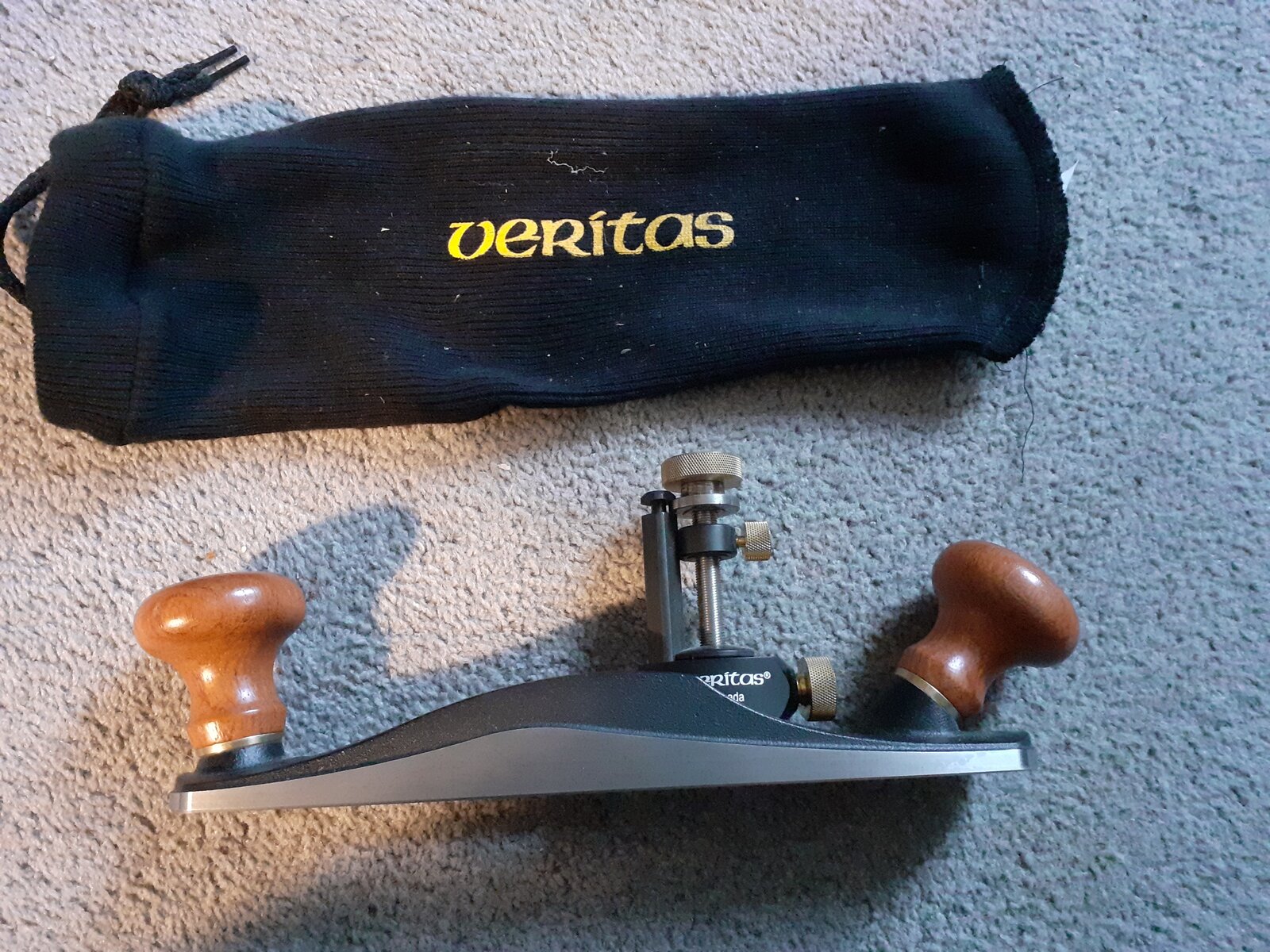

Have one of these...
It gives better results than a chisel. Its also a delight to use.
Gave it to a guy at work recently and he did all the hinge recesses on 8 doors.

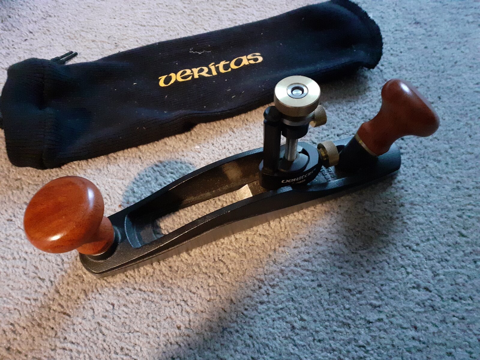

Well, I have one of these:
Which is actually designed to chop out door hinge recesses, lock face plate recesses and the like whilst working on a narrow edge which can be awkward with a router plane like yours. It works well, but TBH I still use a laminate trimmer (trim router) most of the time.

Yes very fancy, but in context, are there cheaper similar planes commonly available? And do they do a similar job with a sharp blade and a skilled hand? That is my argument.
I would also bet that any old skool chippie would be able to knock a hinge or a joint recess out with his favourite chisels in the same amount of time and just as neatly. It's always down to the person, not the tool.
Now I know that you two certainly know your stuff, and presumably can knock out some excellent work, but is that because of those expensive tools or despite them?

Yes of course they will.
Might take a bit longer though.

No. That type of hinge recessor was actually patented about 110 years ago and they were certainty on sale in the USA just after WWI. Even Stanley made a version for a whole (#171). They were originally aimed at joiners on pricework installing multiple doors because they did speed the job up, but they weren't long lived probably because of the rapid take up of the electric router (often coupled with a planer base and hinge recessing jig) by price work carpenters in the USA from the mid to late 1920s onwards. Consequently most production stopped by WWII. Having used one I know of no other plane which performs the task as well, or as quickly. The result from this plane are superior to most hinge recessing I've seen done by hand. I don't use mine much simply because I don't hang many doors any more (and where they are new installs they come in as pre-hung sets in the main) and in any case I carry a cordless laminate trimmer with me (used for multiple tasks) which is far less of a one trick pony.
Based on having refurbished or repaired hundreds of old doors over the years, quite a few on listed buildings, banks, etc I would have to say that the general quality of hinge recessing by hand is often pretty low. Neat, flat-bottomed recesses is what you are taught to produce in college - out on site it asn"t like installing small hinges in nice clrar grained stock as a cabinetmakers might; time pressures often mean that at least some of the quality goes out the window, simply because financial constraints. The other thing is that a lot of the timbers used in doors (at least in modern fire doors) is nasty, rowed, stringy carp which can be awkward to work cleanly with hand chisels
