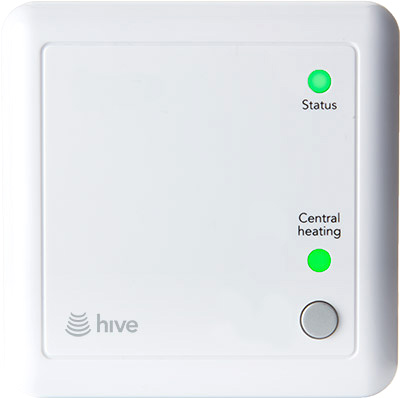

That is the new design British Gas wireless thermostat.
To reset it take the batteries out.
Turn the power off to the receiver.
Turn the power back on and press the button on the receiver for about 10 seconds until the top light starts flashing.
Put the batteries back in the thermostat.
After a short while the top light on the receiver should turn green and the thermostat's display should show the current temperature and set temperature.
+1
No idea what the reset achieves on the stat. You need to re bind them.
I saw one of these once. I thought it may be a early, or simplified version of the Hive, which is a British Gas product and the receiver looks pretty much the same as yours.
If it helps, you can download the instructions for the Hive Receiver by clicking here.
Thank you so much. Followed the guide for the hive switching the power off and then on, waiting 5 seconds and then holding the button on the receiver until it turned white. Put batteries back into thermostat and it paired instantly.

Sorry to bump this thread after a few years, but this is the closest I have got to resolving my issue.
I have the same WL2 thermostat, batteries died and have been replaced, but I can't get it to pair with the receiver. The boiler is fired up and working for hot water, but the receiver will not display any status light.
I have tried switching it off at the fuse board, switched it on and held the reset button.
I have also tried to hold the heating button down to reset the receiver.
Nothing.
Nothing.

If theres no lights at all on the receiver, even on first power up, the receivers dead and will need replacing. These are only available from BG so youre probably looking at a new stat and receiver.
