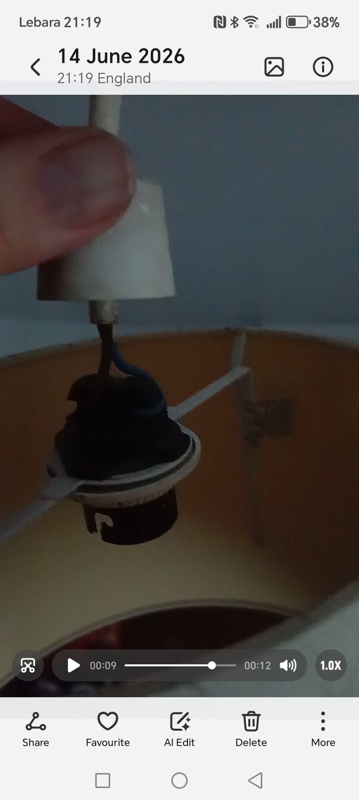

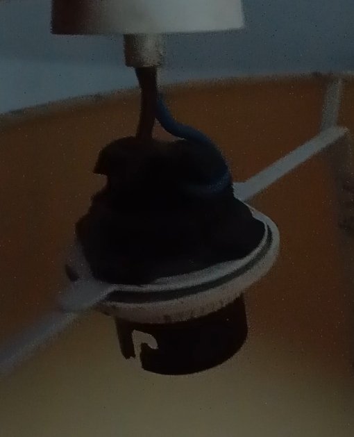

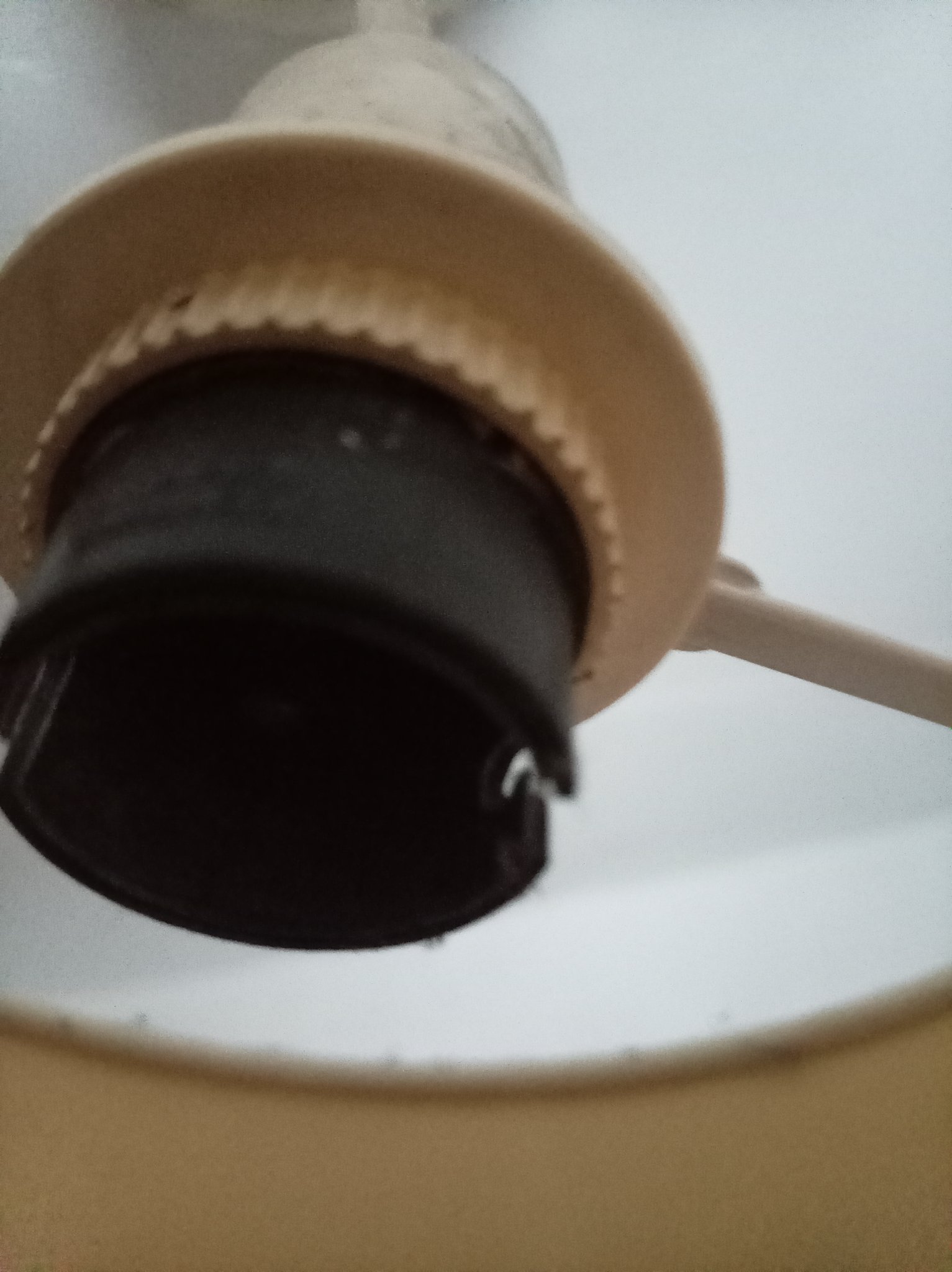

Hi. Can this lampshade come off? I'm sure I put it on a few years ago. I thought there would be any easy screw off method.

You have turned the wrong bit ,screw that back on hold the metal bars of the shade and turn the plastic ring below it, they often jam up, new holder may be best as said above

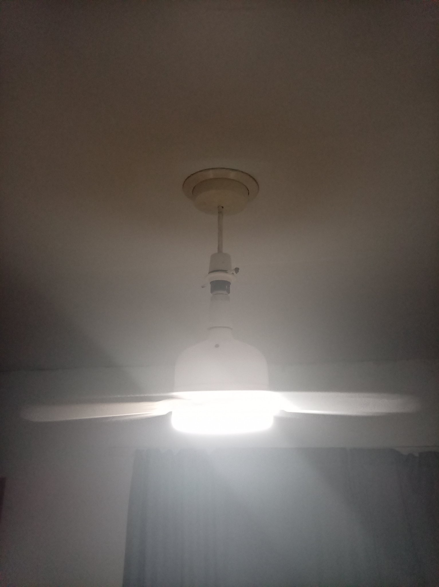

Just thought, if the light goes out, is it easy to replace the lighting part or need to replace the whole thing?
Holy crap what is that
Looks like another mad gadget that’s not suitable for hanging off a pendant
