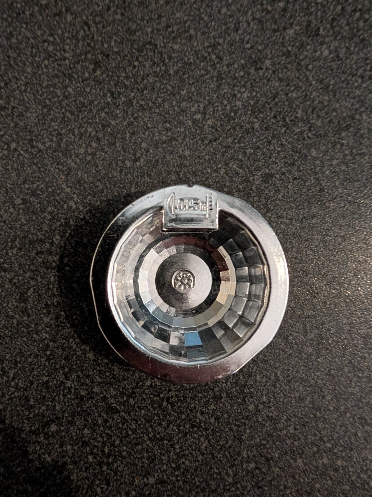

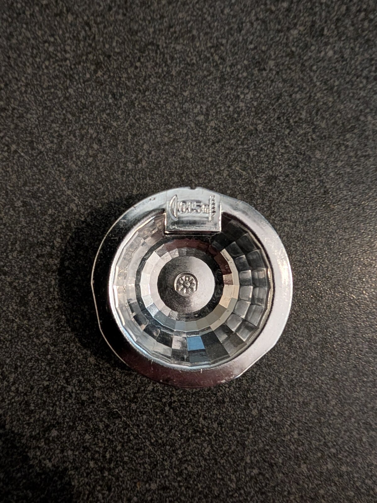

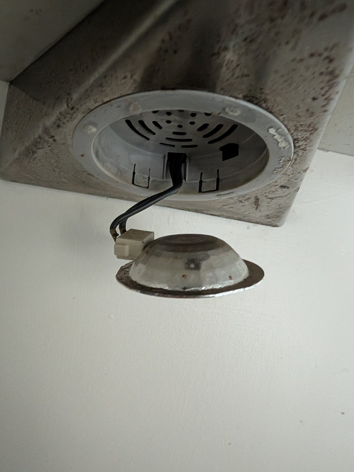

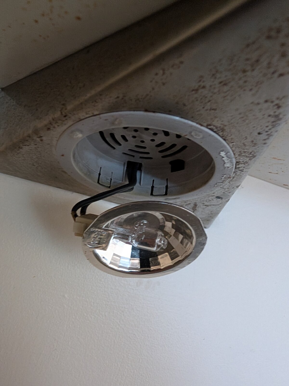

Could anyone advise if I can buy just the housing and bulb for this light as it's broken. Thanks

You haven’t shown us the important bit- the actual bulb holder. !
Note that the one you have, and the one suggested by @Murdochcat are 12v halogen lights. Halogen lamps have been discontinued so it would be better to find a way to fit an LED equivalent light fitting. Something like this
You may find that you need to replace the power supply too.

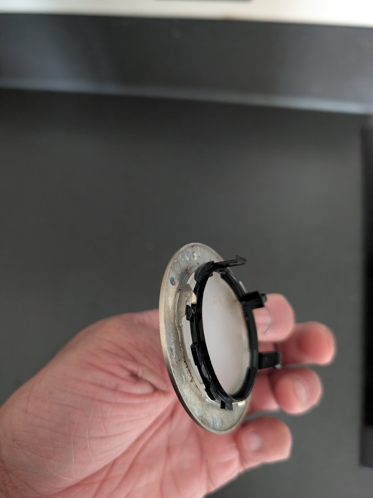

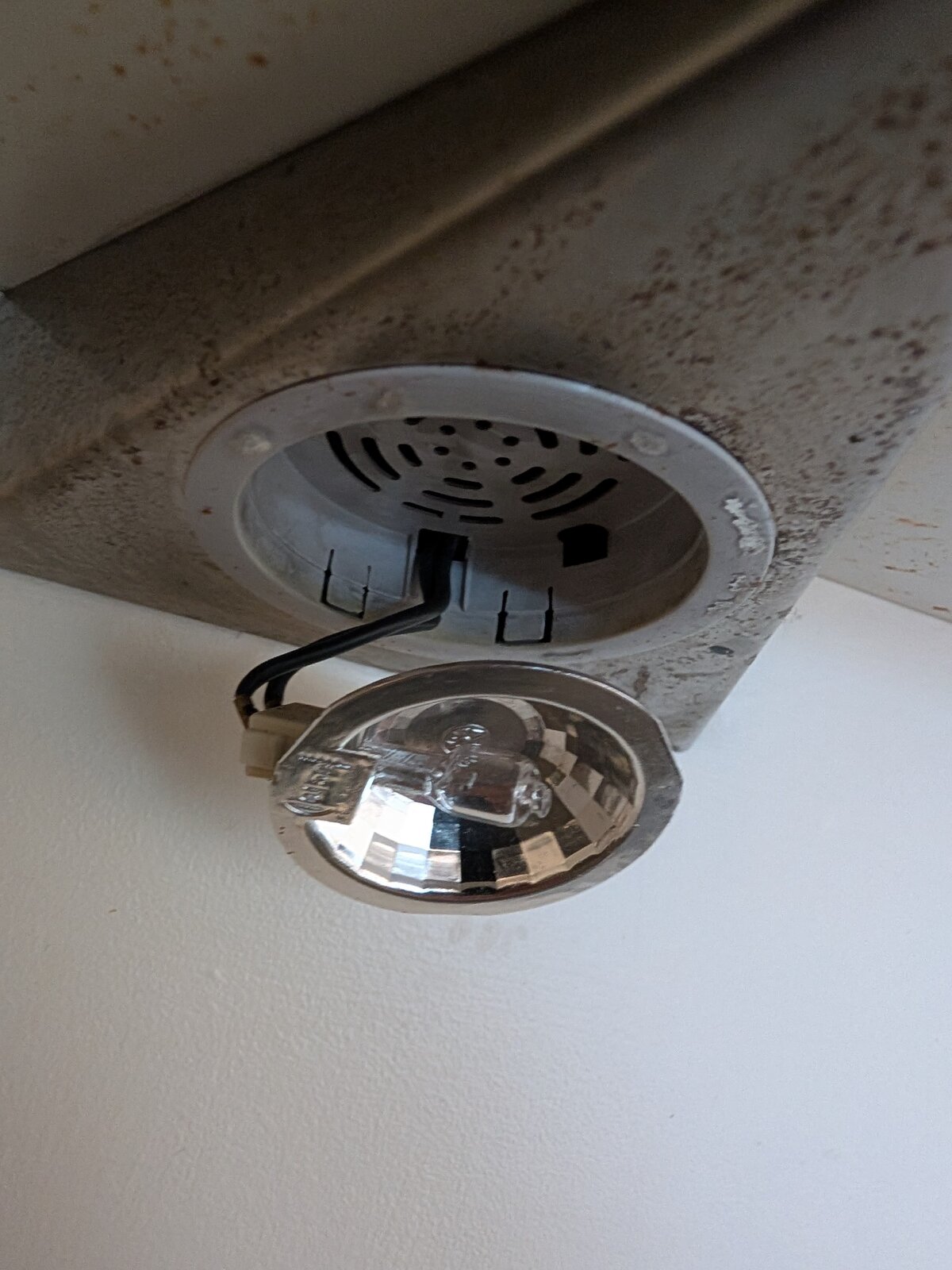

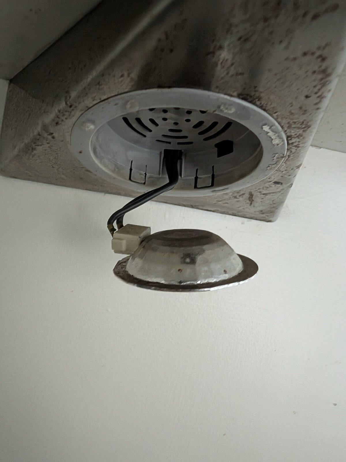

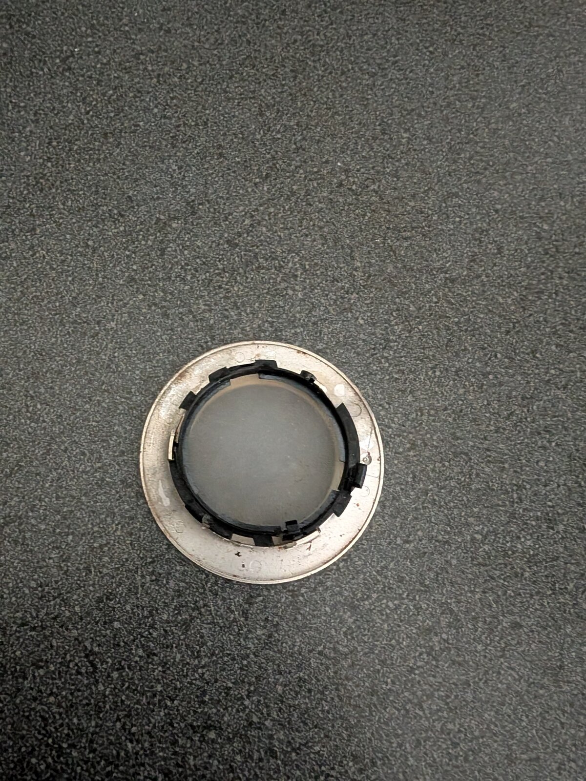

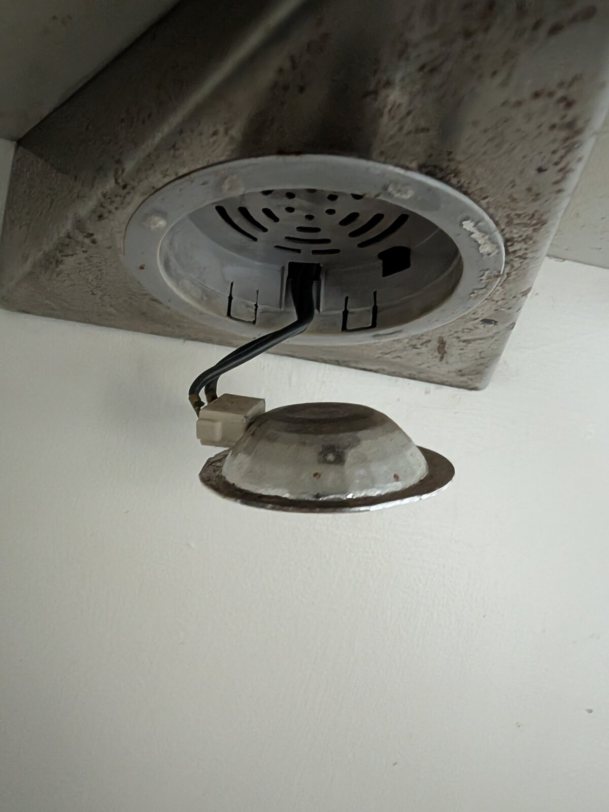

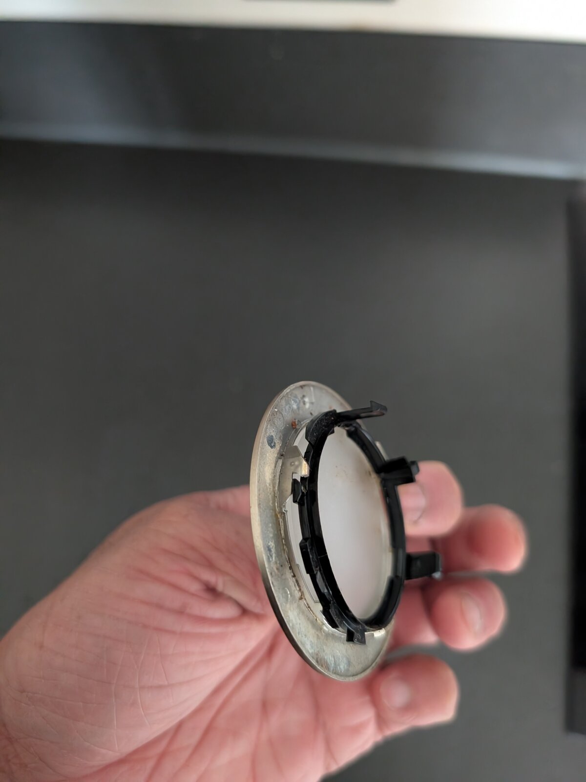

Thanks to you both. Attaching holder picture. I want to try to swap out the bulb and holder bracket ideally. The wire has two small pins that the halogen inserts into. I can get the bulbs but not sure if i can find the right holder/bracket.

The holder and reflector will be specific for that particular fitting. You might be lucky on eBay, but the Knightsbridge one is only £6 for the WHOLE FITTING so why bother?
They probably even cheaper elsewhere because nobody wants them because the lamps have been discontinued. So you’ll need to replace for an LED fitting soon anyways.
We used to have them. I used to buy the bulbs in boxes of 20 at a time - they would blow with frightening regularity. LED's all the way now for me.
Thanks. Those Knightsbridge ones are sold out. I could get these https://www.tlc-direct.co.uk/Products/KLTWW.html
Is it easy to swap the whole unit? I am comfortable working with electrics.
Those ones are 230v mains LED units. They would be ok, but you would have to remove the transformer and use the existing wiring -if that is suitable for mains voltages.
Is that the only under cupboard light, or are there more on the same transformer?
Thanks, the existing transformer is not for LEDs i dont think as these are regular 20w halogen bulbs. Any suggestions what I could swap with? Sorry @Taylortwocities recommended the same one I posted but I am guessing this wont work.
