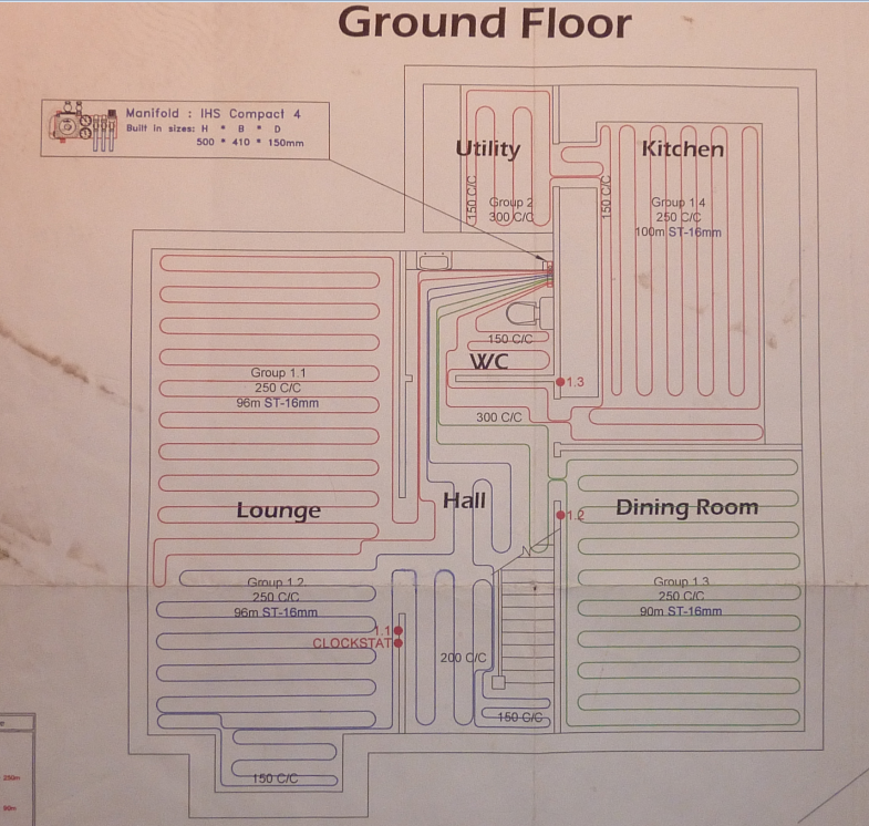

Hello,
I am hoping for some assistance troubleshooting my UFH system.
Background:
House is about 10yrs old, we are the second owners.
Boiler is a large combination boiler, housed in the garage.
Heating is UFH throughout property, on both floors.
There are two manifolds, one on ground floor, one on first floor.
Downstairs, the manifold feeds circuits as follows:
1. Living room one end
2. Living room other end and hallway
3. Kitchen
4.2nd reception room
5. Orangery - this is turned down, as its not used much in winter and would cost a fortune to heat it to normal room temperature.
The downstairs WC is where the pipes all run under, the manifold being hidden in the wall between WC and kitchen . So it doesn't have a circuit of its own, a couple of loops from kitchen circuit run on one side before they go out through the hall to kitchen.
The living room has the controller in it, and a room stat. Controller is set to 30C so when the program is set to be on, the room temp doesn't shut down the whole system.
Room stat set to 21C.
This stat runs actuators for the two living room circuits.
The kitchen, and reception 2 have room stats respectively.
The orangery is manual valve no stat at the moment, hence the throttling of the manual valve to limit flow. This seems to work fine, as its floor isn't warm like the house, but its certainly not cold tiles as it would be with no heating in the floor.
So to the issues:
1. Since we have lived there, I have found one side of the kitchen floor, and the utility (both are one circuit from the manifold) is cooler, but this winter, even though its not that cold yet, the utility is down right chilly.
When we first moved in, I spoke to the manufacturer and they helped me tweak the settings, as we had some other issues (upstairs the water was set too cool and floors weren't heating rooms, and pumps were all set on 1 in manifolds...). They advicsed setting two or three on the manifold pumps, and upstairs its set to three. Downstairs, I have tried 2 and 3 and it has not remedied the situation. Setting 3 makes something in our walls resonate, unfortunately they fitted the manifold to the studding, not to a brick or block support :(
2. I noted yesterday, that despite the room stats all having turned off, and rooms all being at temperature, the pump was still running. Since I had left the pump on setting 3 downstairs I was able to hear it. I double checked and all stats required turning up to get a click, so they were all off at idle. This should mean downstairs system should not circulate as I understand.
I set the controller to off, then back to auto, and the pump did not then come back on, unless I bumped any of the thermostats upward, as expected.
So, my main question is ref the kitchen colder floor on one side, in particular on the further end of the loop on that side, and the utility (both one circuit.)
Secondary question ref the pump behaviour.
My manifold is of this type:
System layout downstairs - orangery not shown, these were plans left from the prev. owners.
As far as I know its correct. The plans from 1st floor didn't quite match the final house - only because they moved a door probably after the initial quoting was done for heating, but walls etc.. all seem to be in the right place.

The manifold has small turn screws on the outlets, you cant really make them out on the photograph above, but the lower connections, on the more brassy coloured bit, there is a slotted bit to turn.
No flow meters however.
Now when I spoke to invisible heat, they said all outlets should be straight down, no balancing required, and that's how it was set when I first looked at it.
I can see why you ask, as obviously , in general, system should be balanced, be that radiators or under floor circuits.
From the diagram, you can see that kitchen is 4m longer than two of the circuits, and those two are 6 m longer than the shortest, but all circuits are within 10m range of lengths.
Would we expect this to require much flow adjustment, and could this be the cause?

So, I realised the mixing stat was actually set up above 50, and was reaching about 60 in practice, so I dropped that down, its now at the more advisable 45-50 or so, and this morning I remembered to take a snap in the cavity when I left house at 5.45ish, so heating been on for about 15 mins.
so the outlet was at approx. 52C and the return was at 45C. Pump is set to setting 3 (jet engine setting)
now one weird thing, only one of my actuators has a visual indicator when its open, a small lump on top that rises, it wasn't up. but the stat in that room was calling for heat, as I could feel heat in the head for the other end of the room, and this one also felt warm where the capsule is. so ill have to look at that.
Also, the pump was again running on last night, even once all downstairs stats were not calling for heat, the pump ran on until I turned the controller off and on again. It then didn't come back on until required this morning.
Is this likely to be an issue with the wall controller or the board in the cupboard which everything is wired to, or is there some recirculate logic in play where its supposed to keep circulating the water?

You give sound logical advice, and your thoughts are along the same line as my own, I was hoping for validation of them, so thankyou.
I agree, the pump running when all stats seem to be not demanding is not right. I need to check if the boiler is also firing, as that would be more annoying! Its in garage so I didn't do so the other eve.
One challenge is whenever I am home in the week, the kitchen is always warm, due to the floor being toasty on one side, and the oven often on and or cooker, so often its up at 23 or even 25 when I get home due to cooking, and with the floor up to temp from the day, its very hard to discern any rise or fall even well in to the evening :(
The utility is certainly cold however. I guess one though in my mind is that the water is cooling too much on the first sode of kitchen and its too cold by the time it reaches the utility, but that would seem strange.
I think I will close the orangery circuit off completely temporarily, to ensure its not robbing too much flow.
Can flow meters be retrofitted to my manifold do you think? Outlets are on the bottom, and actuators are the return correct?

Hello Andy,
I think you might have given part of the answer to your utility heat problem as above.
Could it be a combination of factors, poor / reduced flow and the above quote. ((remove the actuator (which is on the return flow) and set the kitchen stat high to establish what heat you can get into the kitchen / utility.))
My kitchen floor is usually cold because of the heat from other rooms, cooking, lights, humans etc gives me the 22* the stat is set at.
I have a different circuit for the utility so it isn't compromised as yours is but if it was the same circuit then the utility would never come on.
It does not explain the difference between this and last year unless a lifestyle change gives some explanation.

Paul, that's the thing, what if it doesn't have them, when a stat demands heat, it would open actuator and call for boiler and pump. So without a zone valve would you get boiler feed to both manifolds? but only one would have its own pump circulating? Just thinking aloud here.
I did a bit more fiddling tonight, and discovered something odd. The pump was running on lower manifold, but all downstairs stats were off. I went up stairs and checked all 4 stats up there... Two were off, two were on, and when I knocked both those off, the downstairs pump stopped. But turning either of those stats back on didn't restart down stairs pump. But more oddly, turning one of them back on didn't seem to start the upstairs pump?? Turning a downstairs stat up kicked the downstairs pump back to life, and then only fiddling upstairs would stop it as before.
Really odd, but this seems to maybe support some odd wiring and maybe lack of zones which should perform the and/or logic choice for the system?
