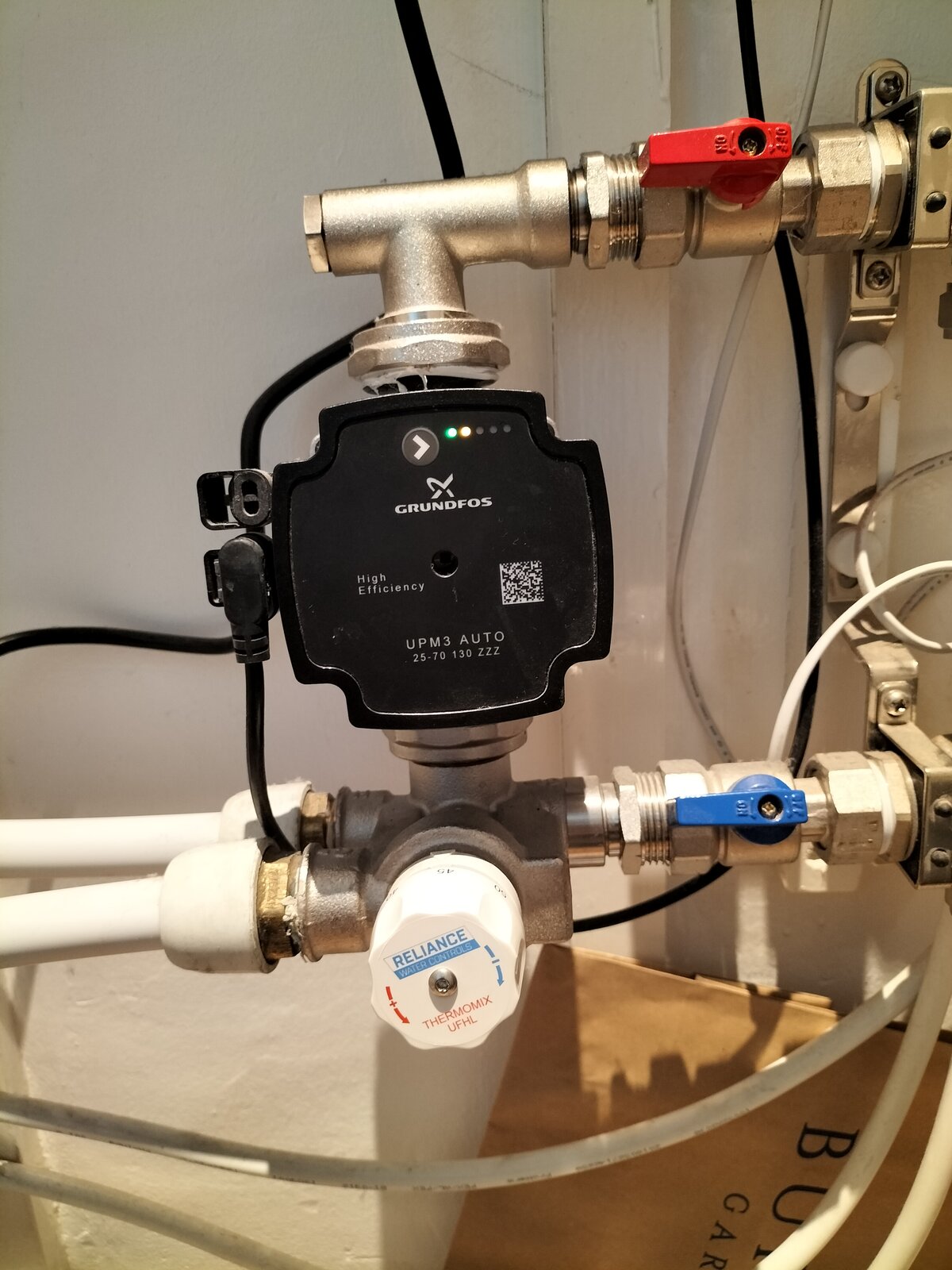

Can you post a photo of the manifold showing the TMV and pump etc.

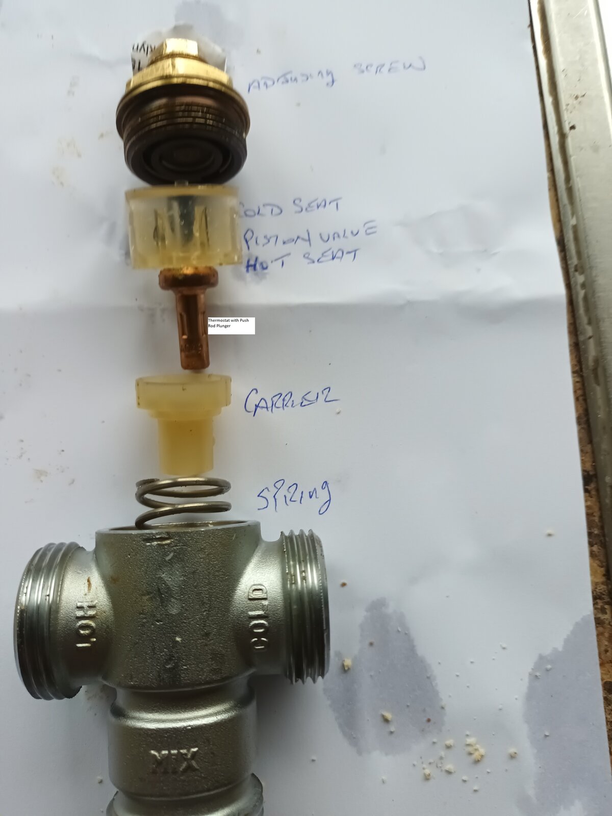

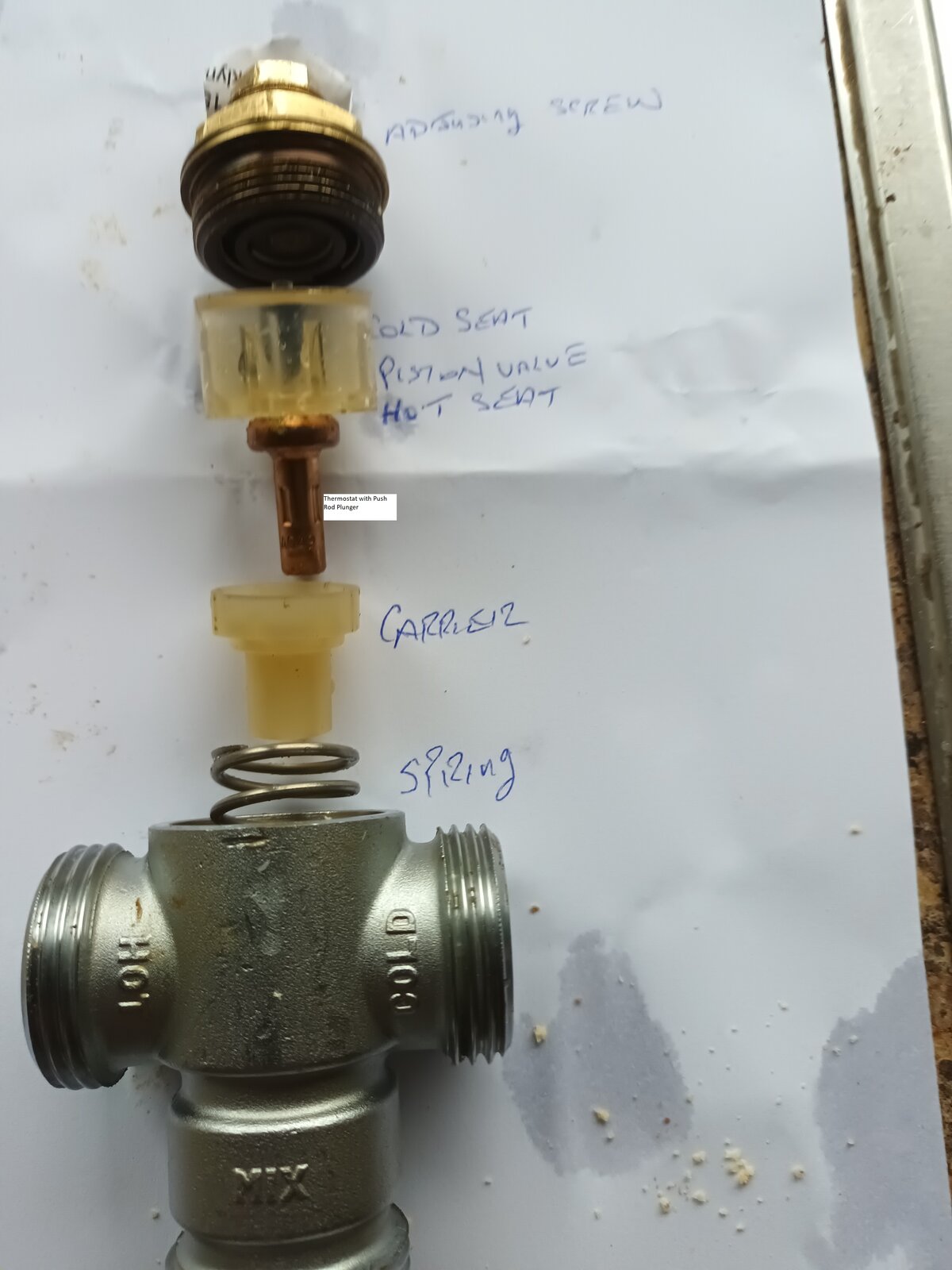

Strange that theres no spring. For interest, here's a TMV I took apart years ago to figure out how it worked.
I presume this will be close to your setup - as you can see the thermomix blending valve components and if you are missing a spring then I don't think that's correct but you would need to get a part number
Without knowing the exact model of your blending valve - can you find a part number? - then a similar service kit would be this
Again it's certainly has a spring and all other reliance service kits are very similar and all have a spring return.

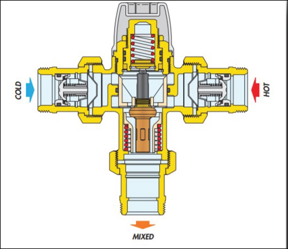

Here's one from Altenic? I think, although it seems to be blinding both the HW and the cold.
After much additional research and thought, I have swapped the feed and return connections to the mixer.
Everything now works how you'd expect: feed gets hot, return slowly gets warmer but stays cooler than feed and you can set the temperature dial to whatever value you want and it works. So it looks like my feed and return pipes were labeled the wrong way around. And that is the cause of all my issues including why I couldn't set it to hotter than 40C!
