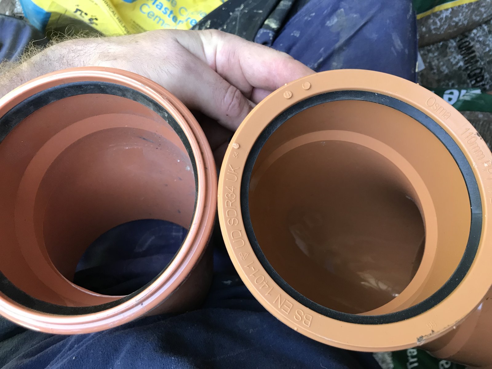

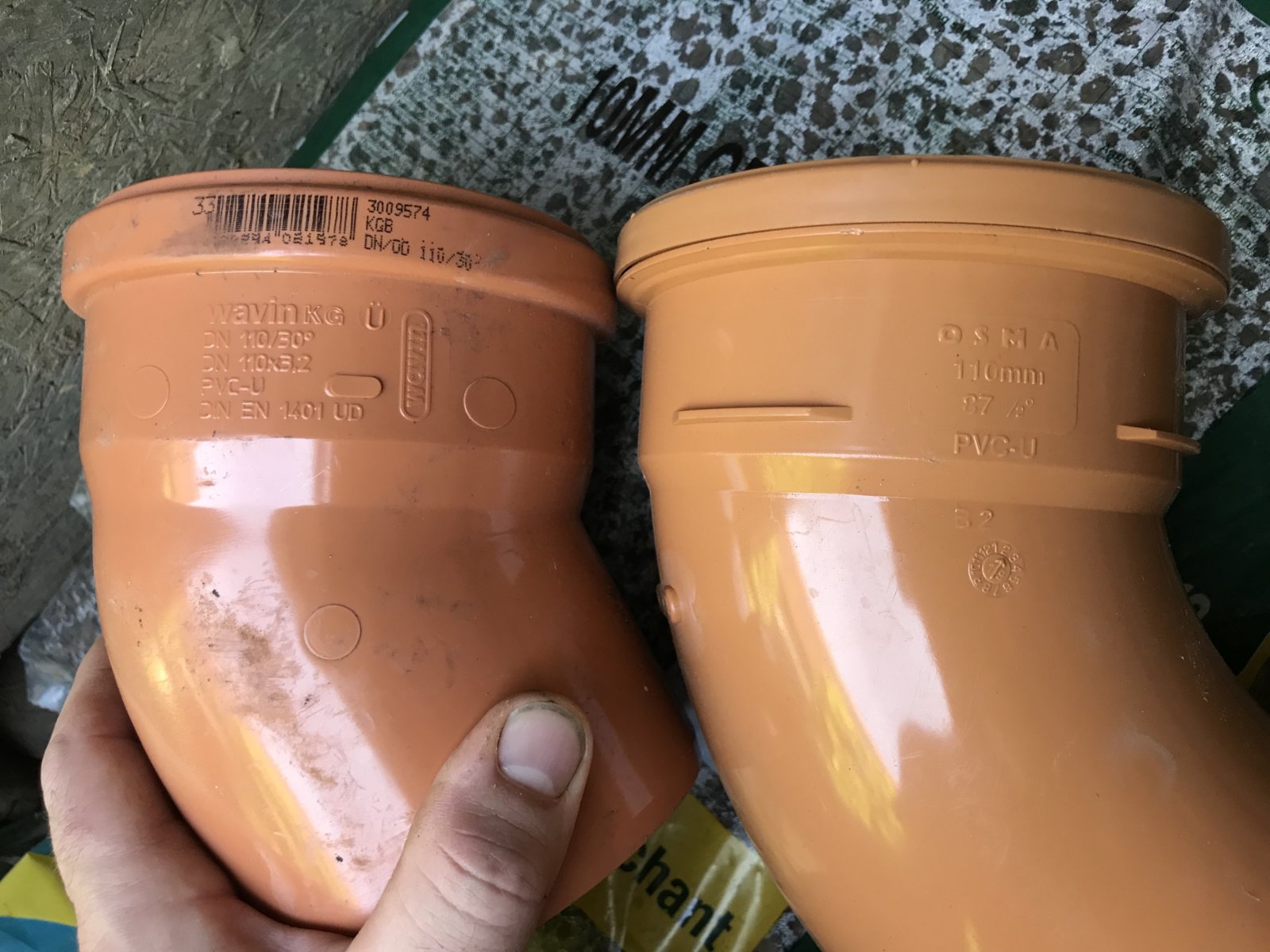

I’d go with Osma stuff, I get it from Travis Perkins but they seem to be swapping it out for Wavin branded stuff which doesn’t seem as good to me.
The Osma has a seal that’s glued to a clip on ring where as the Wavin has a loose seal in a ‘swell’ on the fitting. I might be wrong but the Osma just seems a superior product.
Osma & Wavin are the same company. Surprised there's any difference
Looking at the difference though between Osma and Wavin, have to wonder now if Wavin is the budget brand. I think I've used virtually every manufacturers products at some point over the years, it's all pretty much of a muchness to me.
