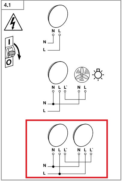

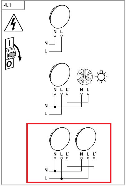

Hu Sunray..... You might have been right. I wired them up today and I can't for the life of me get them to work properly, they are switching on and off all the time on their own.
I've tweaked the lux and sensitivity settings and can't get them to reliably work. I've also noticed that when somebody walks up the stairs they sometimes seem to switch on and off. I've fixed them to the wall so it's not like they are attached to the stairs and the slight stair movement would trigger them. I did wonder if light bleeds through the partition would be enough to trigger the other one but it's not consistent enough to pin it on that.
One thing to note, the instructions suggest that they should be wired as shown below. I haven't done this as I wanted them to function as two independent lights. I've gone via the switch into a junction box and then split off to both lights with live and neutral (no earth as I believe they are double insulated).
Any ideas? Should I send them back and just look at a door switch solution? If so I might need some help with a wiring diagram :)
Yes.
Those lights have microwave sensors, which are more than capable of sensing movement through doors, floors, ceilings and even some thin walls.
Their 8m detection range is grossly excessive for an under stairs cupboard.

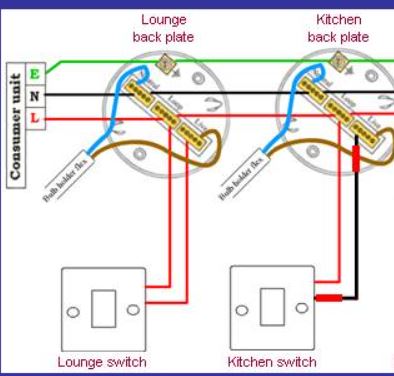

Two of each of these items:
https://www.tlc-direct.co.uk/Products/FM143.html
https://www.tlc-direct.co.uk/Products/CB5851.html
https://www.tlc-direct.co.uk/Products/LTGLS4BCWW.html
Plus some 3 core cable/flex to connect the two lights to the supply and each other, and some 2 core flex from each light to the door switch.
Not wanting to appear a bit dim here but I'm no electrician :confused:

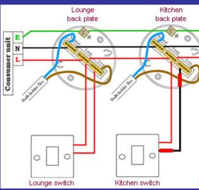

As I've only got the two light fittings and switches, if I wire it like the attached image, will it work? The mention of a switched live always confuses me.
Also presumably, the earth from each switch will wire into the ceiling rose earth connection.
Yes, exactly like that. What's labelled as 'bulb holder flex' in that image will be two very short separate pieces that connect to the supplied lampholder.
In this application, there is no earth wire to the switch, hence the use of 2 core cable for that.
So, is it standard to use 2 core cable for the switches or just twin and earth and snip off the earth?
