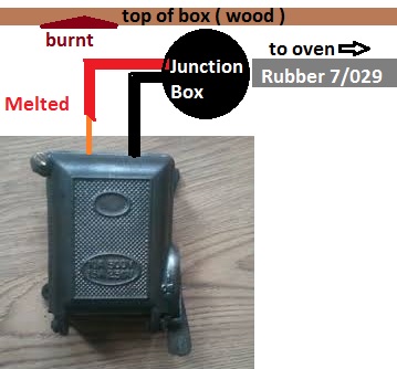

Found this in the meter cabinet at the in-law's house in the 1970's ( "wasn't allowed to take a picture hence a diagram ).
The rubber cable for the cooker had been moved from the fuse box and was too short to reach the "new" switch fuse so it had been extended with PVC. The Live was bare copper where the insulation had melted ( fuse running hot ). Stiff enough to not bend and touch the hole in the Mem box ( No grommet ).
This was considered perfectly OK and safe as it had been installed by Cyril, the brother of mother in law's best friend. Cyril knew what he was doing as he was a "qualified electrician's mate". Finding fault with his work was not permitted.
His other "error" was a 13 amp socket for a fire, a 15 amp ( round pin ) socket, a light and the immersion heater all on the same "radial". He did suggest to never have fire and immersion heater on at the same time.
