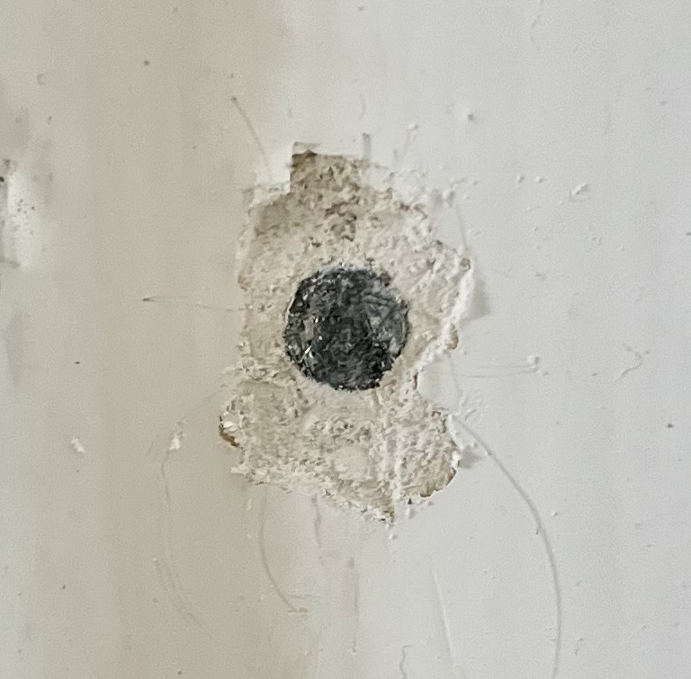

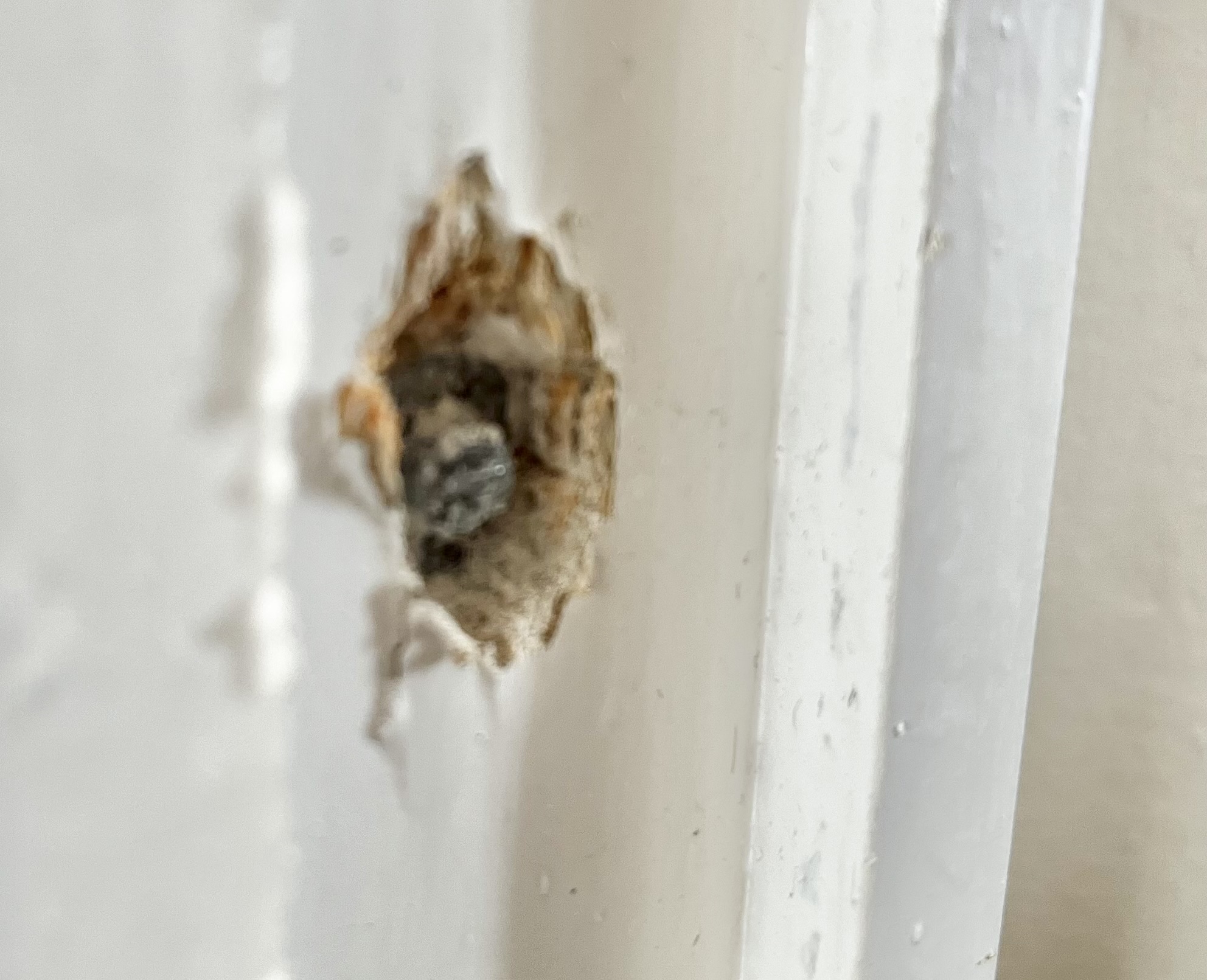

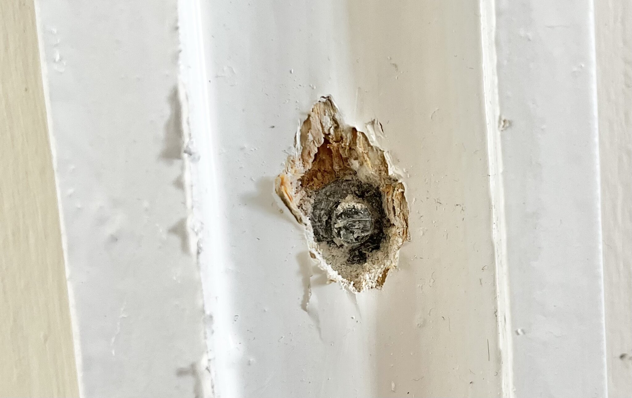

There is a vertical piece of wood (2x3) fixed to the wall. I want to remove it but not sure what is the best method. I was expecting screws but instead I see something like that:
- a metal circle embedded into the wood
- a pin in the centre of the circle
I have never seen anything like that before. What is that fixing system and how to remove it?
I didn’t have an angle grinder, so I decided to leave that into the wall and reuse the wood even if it’s not the exact size I want. Thanks all for your help!
A weird thing to bang into a decorative moulding, so obviously not installed by a craftsman.
Anything nailed will usually come off neatest by just levering the entire thing off the wall rather than attempting to dig the nails out. Put an old plastering float or bricklaying trowel under the heel of the crowbar to protect the surrounding plaster from denting.
