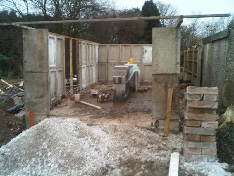

Im in the process of building a garage, its 3600 wide x 7800 long.
Ive got the walls upto nail plate.
Im a bit stuck with the flat roof joist joinery. Im after creating an overhang at the sides of 300mm, easy, oversail the joists.
Im looking at using a lookout rafter on the front elevation to create an over hang of 600mm. However due to the height of the roof and door, I dont have the space to install a lintol. Thus I need the timber to oversail the garage door opening (2300).
To date, my thoughts are to create a ladder beam 1200x4200 to create the soffet detail at the front? However im dubious that it would work?
Is it possible to run a joist over the front door opening then notch in the lookout rafters, so of a canterlever?
Any thoughts?
Im Stuck!
Cheers
James
Can you not fit a a sturdy head to the garage door frame then use this a a bearer for the over-sailing cantilevered joists? So, instead of constructing a standard frame use a 9" x 3" for the door header.
It would mean you having to leave the last few joists off (allow say 2m) then run the remaining joists the other way.
You may have to double up the last joist and spike together, then put jiffy hangers on to this trimmer.
Maybe I'm not getting this but I can't see why you can't just fix the joist to the wallplate that overhangs the front of the garage, it'll still be as supported as any of the other joists. If you are then still worried put a gallows type bracket to support the end of the wallplate that overhangs the front.
