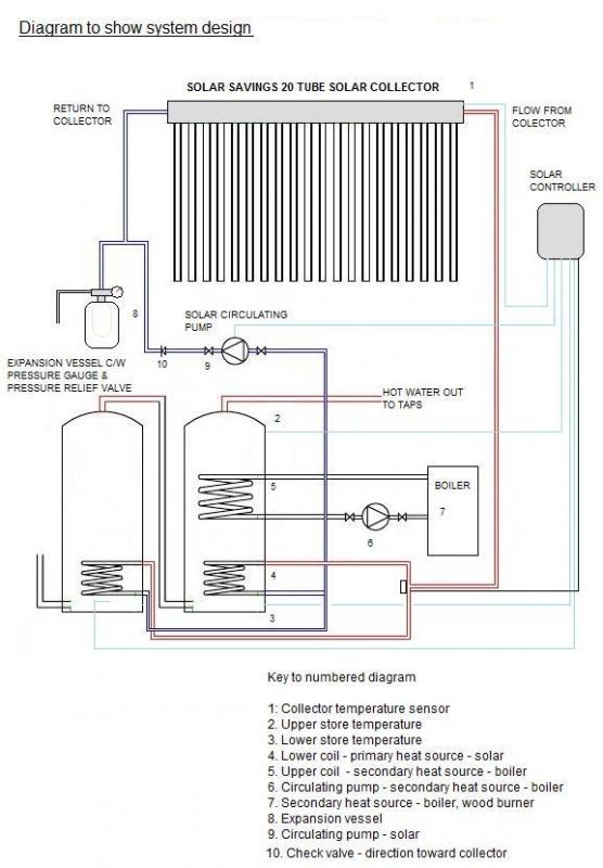

Op you may find the attached useful
Two unvented cylinders? One heat bank/thermal store could do the lot.
yes 1 may do but thermal stores lose heat very quickly and in my experience people are dissatified with them whereas unvented i have never had a complaint
as previously quoted use the correct controller and it should be trouble free RESOL have a controller for most applications
as for East /west collectors these don't produce as much as a south facing collector it also depends on where the OP actually lives as to the amount of solar gain he will recieve
