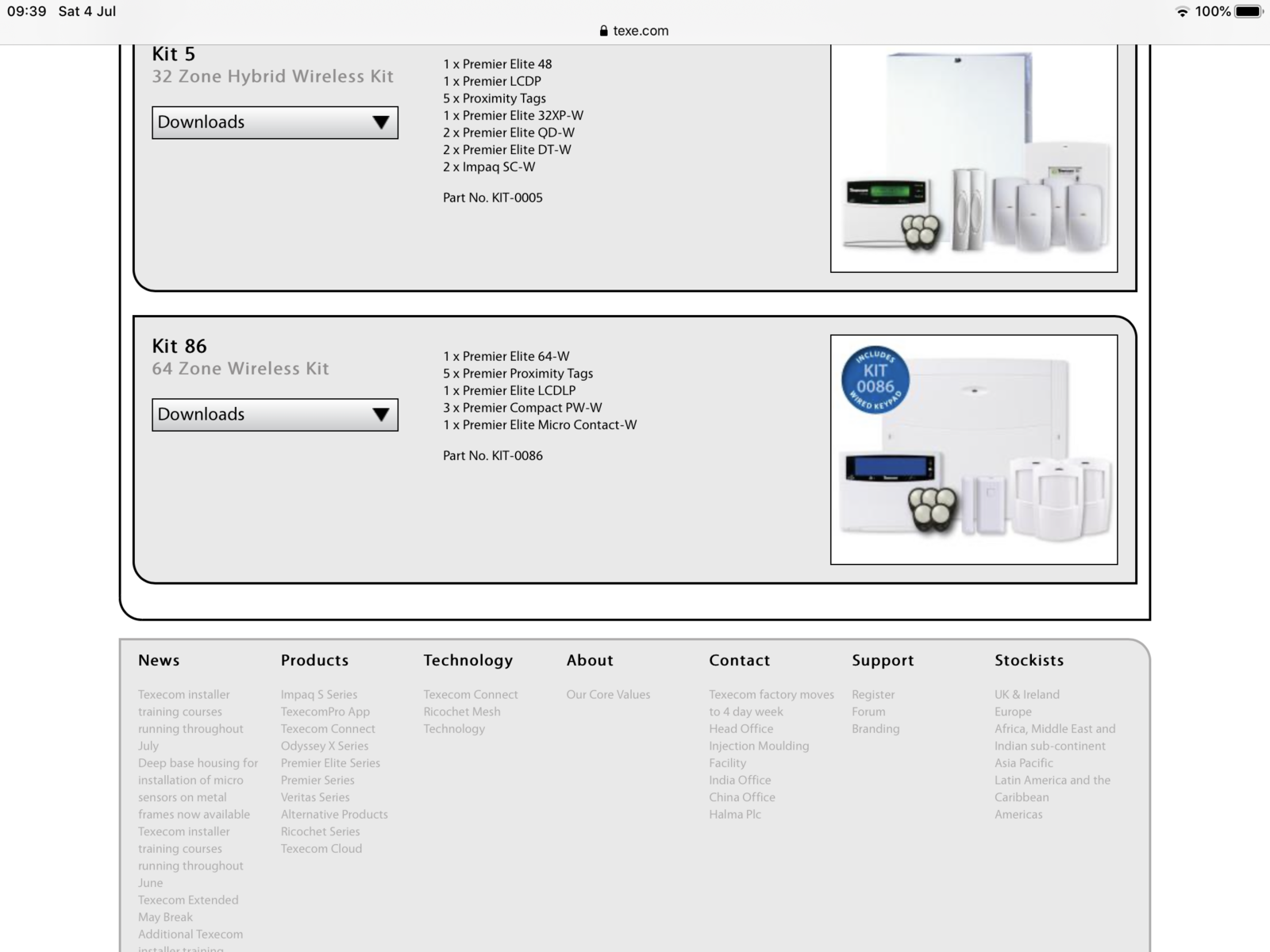

You have all been a fountain of knowledge on previous posts and enabled me to create a really good home alarm system with the help of an installer obviously with a Pyronix Euro 46.
Fast forward to now and i have moved to a new build where i specced a "wired" alarm system for an fair chunk of cash (£500), I moved in a month ago and appear to have been installed a Texecom Veritas, I presume R8 as it has the keypad with no screen.
They have fitted 3 PIR's downstairs and 1 upstairs, no door contacts so when you come in you can pretty much walk round the house before it activates.
My installers option is to rip it out and start again with a pyronix but I cant afford that just yet and wandered if there was any way of making this system a bit better in the interim with maybe a proper display? adding wireless PIR's? tags?
It has been installed by the on site electrician so code is set to what it is so presume it has not been programmed in any other fashion.
Any guidance appreciated
Thanks for the quick reply, would this not involve the total removal of the old one too?
Everything swop over then add wireless contact to front door
KIT 86 Gives you panel , keypad , 5 fobs , wireless contact , 3 wireless pirs ( sell them on eBay ) or kit a euro46 but that’s going to cost more ... 29C38B6F-2816-4EF3-AF84-3C2DFA28EAEE.png
Great, thanks again. for some reason i though the texecom would cost more, I only recall the price of the pyronix stiff as that's all I've ever purchased, i could do the basics of adding to that system and only needed the installer for the tricky programming side, he seems to prefer the pyronix stuff so will ask around for costs on installing this package, looks like you get a fair bit of kit with it!

As sparkymarka says the kit 86 works out at best value.
The petwise PIR's in the kit you probably get £60-75 for all 3 after fees, making the kit cost around £130/140.
The door contact in the kit can be added to your door, be aware that depending on the door construction you may require a micro contact deep base, but rarely needed, unless the door has high amount of metal work in it (some security doors).
as for the programming if you have a list of what PIR's are where, then the programming can be advised.
The zone types would need changing, for some of the PIR's in the house, missed the contact issue posted originally.
