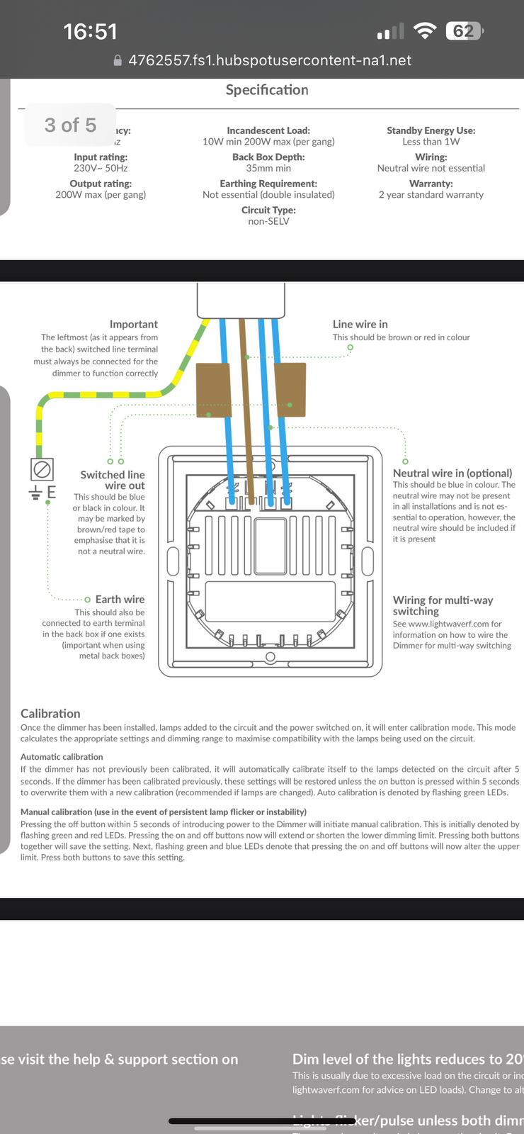

I have attached photos and just need clarification of connecting as I have 5 wires in old switch and the new switch only needs 3/4 wires in
Old switch:
L1 red
L2 yellow
L3 blue
And below it
L1 red
L2 black
L3 empty
New Lightwave switch:
Switch line wire out
Line wire in
Neutral wire in

To return to the basic issue. I guess that your house has two or more lighting circuits. Usually for up and downstairs. If that is the case then that one switch will not work as there is only one live connection and can’t accommodate connections ftom separate circuits.
Further. The Lightwave needs a neutral and your switch does not have one at the switch!
Sorry there’s no simple answer. It is just possible to use the Lightwave product but it would involve substantial re-engineering of your lighting circuits, possibly some additional cables and you would need additional Lightwave product(s) at the other end of the landing circuit.

I guess I'm slightly concerned, they are linking an upstairs and downstairs lighting circuit, but they seam to have thought of this,
You have the version "(With 2 Intermediate Points)"
I would use the blue wire for the ~ terminal
Yellow wire for the S terminal (as they have)
But obviously you need the slave dimmer upstairs
As a temporary measure you could connect the red and yellow wires for the upstairs light together.
Isolate the blue, so it doesn't touch anything.
Then test the product with the downstairs light only, (red L and black ~ wires on right side) and see if it any good, and whether you want to purchase a slave for upstairs
