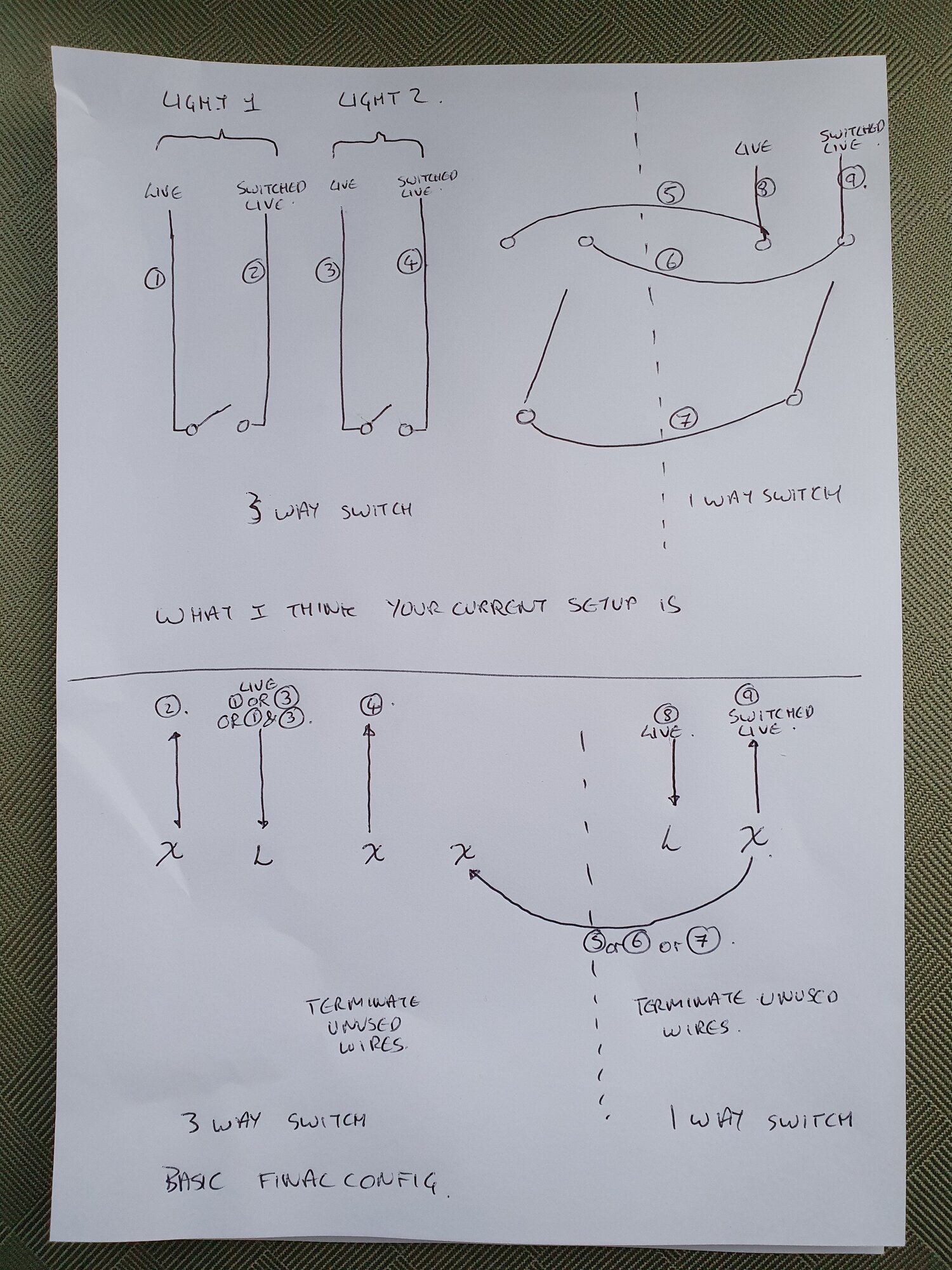

That looks to me like your single light switch has the switch drop from the bulb and a 3 core strap to the three way switch. If I am right, follow the 'two wire' three way switching guidance on LRF's website.
If you don't want to do that, work out which of the cores in the two core cable at the single switch is always live, and wire that into L on the new one way switch. Wire the other into its X together with any one of the cores from the three way cable (one of its black, grey, brown). Safely terminate the other two cores and make sure everything is sleeved.
Return to your three way switch and wire the same coloured core from the three core cable into its 'X'. Safely terminate the remaining cores and sleeve appropriately.
An electrician onhere may indicate that there is a norm for which of the brown, black, grey in the three core cable should be used in this scenario. If they do, follow their advice.
Then, go the app (you must have the gateway for this to work) and create a two way switching automation between the one way switch and the right gang of the 3 way.
Pictorially, the basic setup you should aim for (once completing all the checks already indicated to you) is:
NOTE I AM GUESSING YOUR EXISTING WIRING SETUP BASED ON YOUR PHOTOS. A GUESS IS WHAT IT IS; A GUESS. YOU NEED TO BE SURE OF YOUR SETUP BEFORE PROCEEDING.

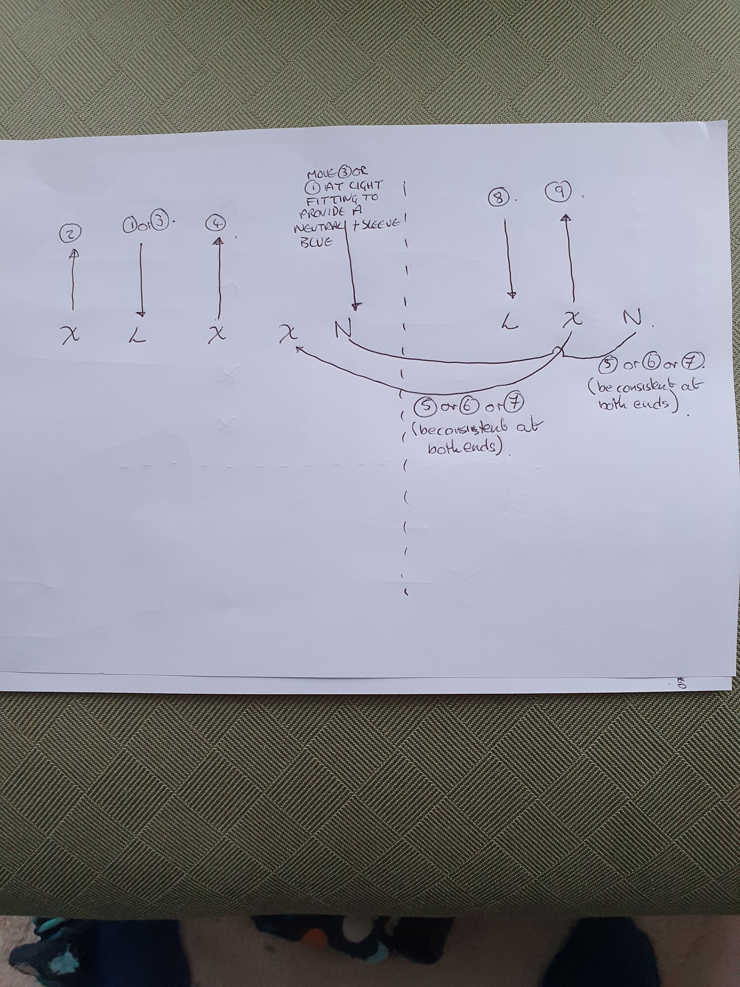

The basic setup will work. This would be better as you can repurpose one of 1 or 3 at the light fitting to provide a neutral:
If you don't know how to do this safely, don't do it. Remember you still need to terminate unused cores, sleeve appropriately and follow the advice given so far.

I am not sure how much dumber I can make it than the diagrams above.
However, we cannot just from your photos give you exact guidance. It is imperative that you know which wires in your existing switches are permanent lives and which are not. It is also imperative you know whether your lights are all on the same circuit. Only you can know this, by checking. Any attempt on our part to tell you to put the brown wire here and the blue wire here will be based on ill informed guesses. At best, it may not work. At worst, it may lead to a dangerous configuration.
Given my understanding that you previously tried stuffing a wire that had been wired into a live terminal on your old switches to a neutral terminal on your new ones, I respectfully suggest that the right level of dumbing down, if you can't fathom it from the images above, is to urge you to engage an electrician.
