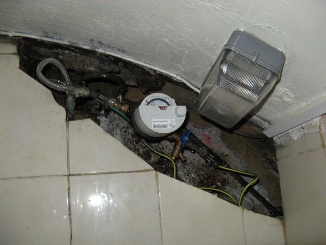

Block of 3 flats, one gf shop.
All fed via 15mm copper, have replaced all plumbing and now running 22mm throughout, to within 2 feet of underground mains water supply, to which a temporary connection has been made (new 22 to the old 15mm stub remaining)
The mains supply, type of pipe indeterminate as can not view, is terminated in a plastic connector / reducer of sorts, which is fairly large (an easy 40mm OD or more). Indicates that up to that point, the pipe must be reasonably substantial, certainly more than 15mm.
So now I have presumably 22+ mains supply, reduced to 15mm for a couple of feet, and back up to the new 22mm pipework.
Question is, how do I connect the 22mm direct to this connector, to eliminate the 15mm, and also should I be doing this or should Thames Water? Water will need closing from the street stopcock.
Thanks...

The images:
First pic shows the general layout, mains supply is from the top left, flats feed bottom right, meter / rest is for the basement. That pic is a couple of weeks old, now there is 22 hooking up to the 15 flats feed.

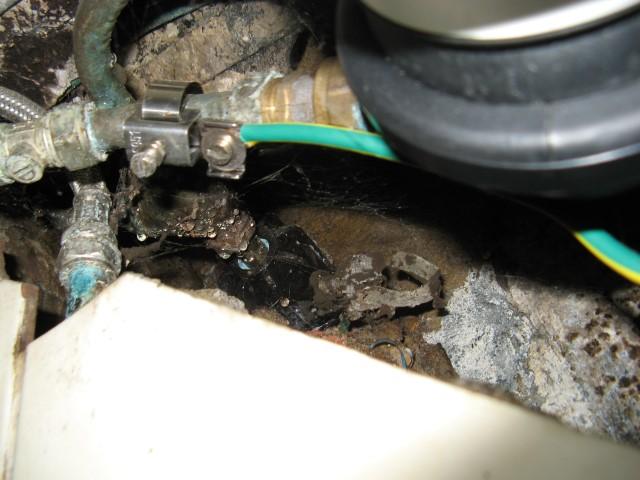

Second one shows the connector, the black ribbed thing with the blue sleeve practically in the middle of the picture.

Took a closeup pic of the connector, I could not get in there but camera could!
The OD is nominally 60mm. The white part is also similarly ribbed, although it's difficult to tell in the pic.
I'd hazard a guess that it's some form of compression join come (proper word censored out!) reducer and that perhaps the buried mains water pipe is plastic.
The stopcock comes very shortly after that connection.
I'd hazard a guess that your incoming mains supply is no bigger than 20mm.
As for that collection of carp attached to the other side of the meter - words fail me!
