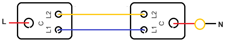

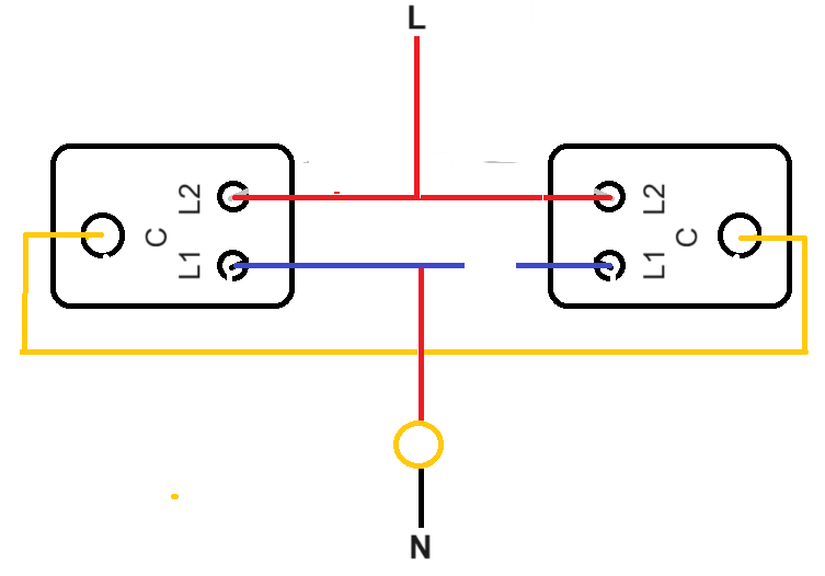

I know the wiring shown is possible, so only three wires to each switch, but never seen it done before. Since there is a connection in the ceiling rose, the fault could be there. Normally we see 5 wires to one of the two way switches, so wired like this
so the com wire can't change colour, with the ceiling rose method colours can change, where it says extra joint in rose. So lets see picture of ceiling rose.
Using logic with light off only one wire on each switch should be live, so we know that wire will not go to com, (note switch markings some time call com S1 if so there will be a S3) but that leaves us with two wires and no easy way to work out which of the two should be com. We would normally ensure same colour both ends, so should be yellow with both switches which is what you have, so theory it should work, so either a wire is open circuit, or colours swapped in ceiling rose.
I may very well be wrong on this one but I can well imagine this being a classic case of either the red or blue wires not being continuous (broken) or screw clamped onto insulation:
The other which I feel is quite likely is the red and yellow wires have been transposed:
Instead of being this:
It's this:
It makes me wonder if the switches were removed without noting the wiring and then replaced using the classic colour combination of the conversion method.

All I'm doing is applying a little logic to the sitaution, my first and third sketch both give those fault conditions and I have certainly encountered both
The red, blue and yellow cable is for the stair lights, which is wired identical to the single switch upstairs(this is the issue, I can switch the stair light on from downstairs, when I go upstairs I can switch it off, BUT, if I then want to switch it back on from downstairs it doesn't work, unless I switch it back on from upstairs first. I'm completely lost with this to be fair.
