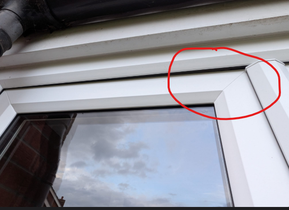

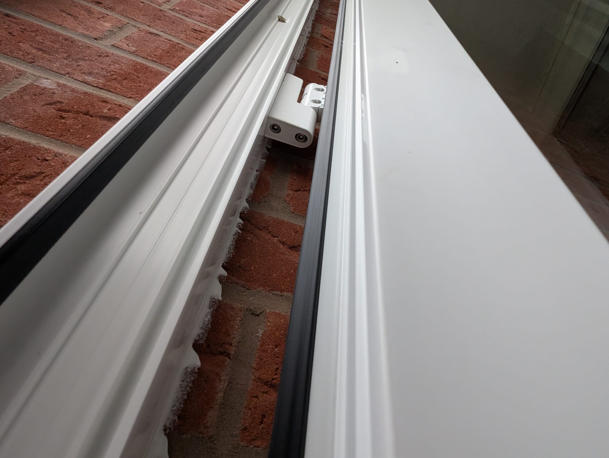

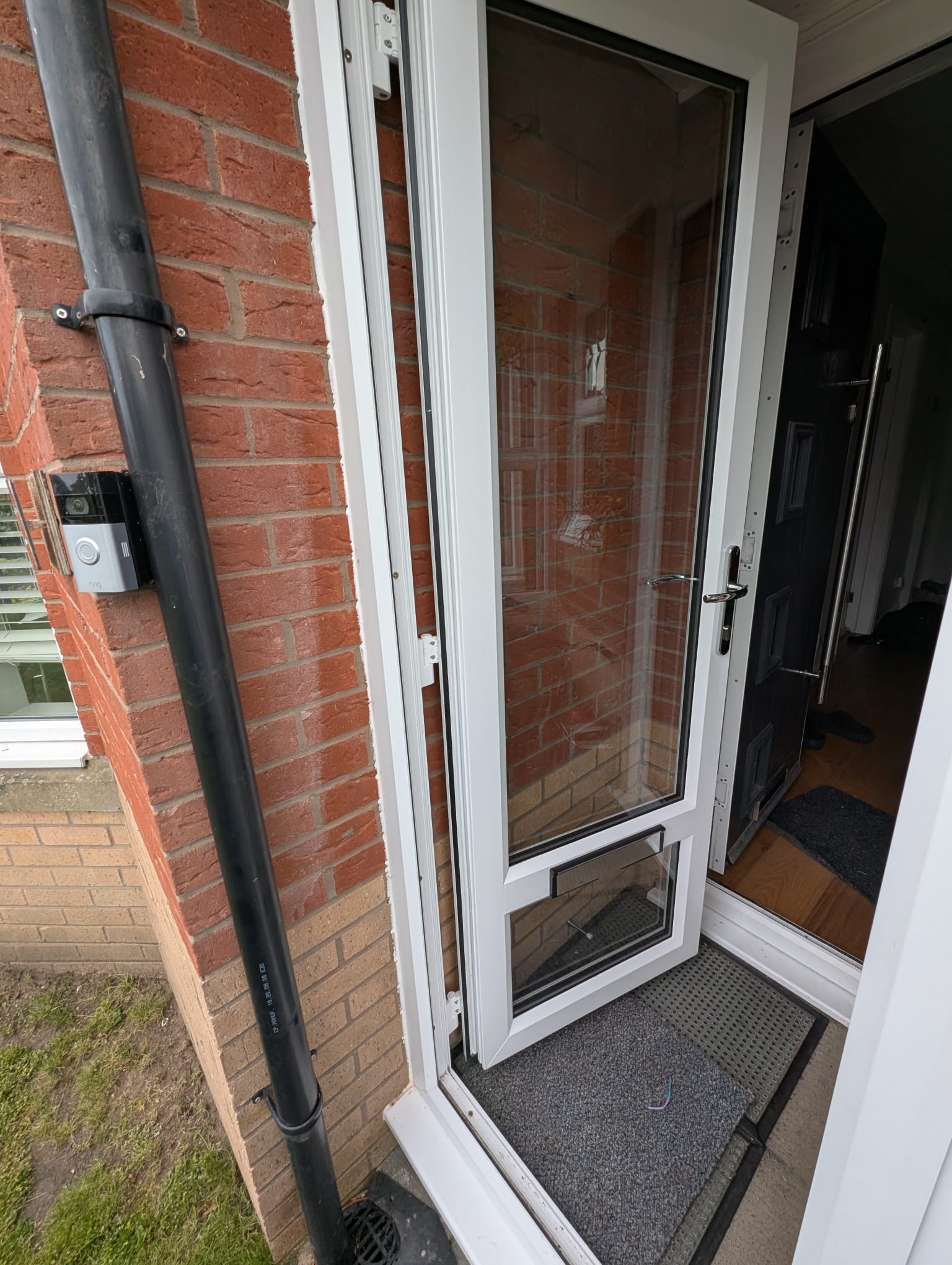

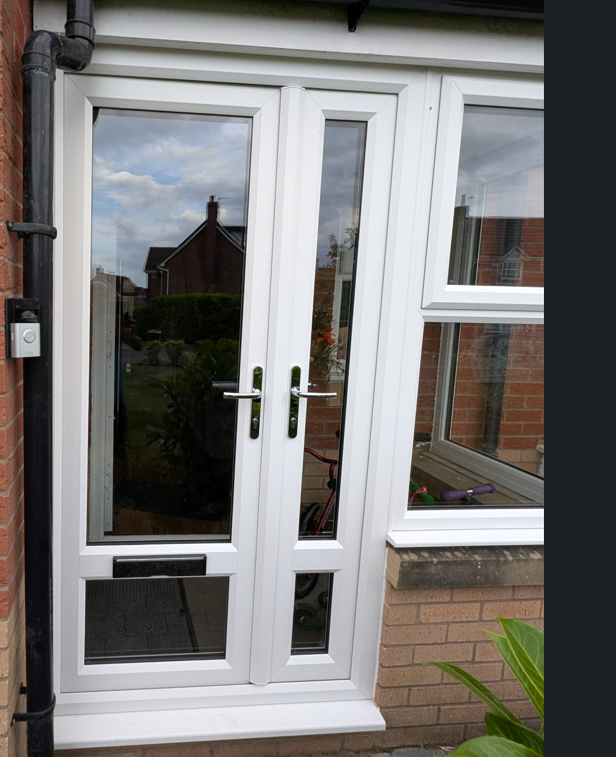

I had a new UPVC door fitted on my porch last year, it shut fine to begin with, but over time I have trouble locking it. The door shuts OK, but pulling the handle up to engage the locking pins when the door is shut is very difficult, I need to exert a lot of pressure to get it to lock smoothly. When the door is open, the locking pins engage fully and the handle moves fully and freely as normal.

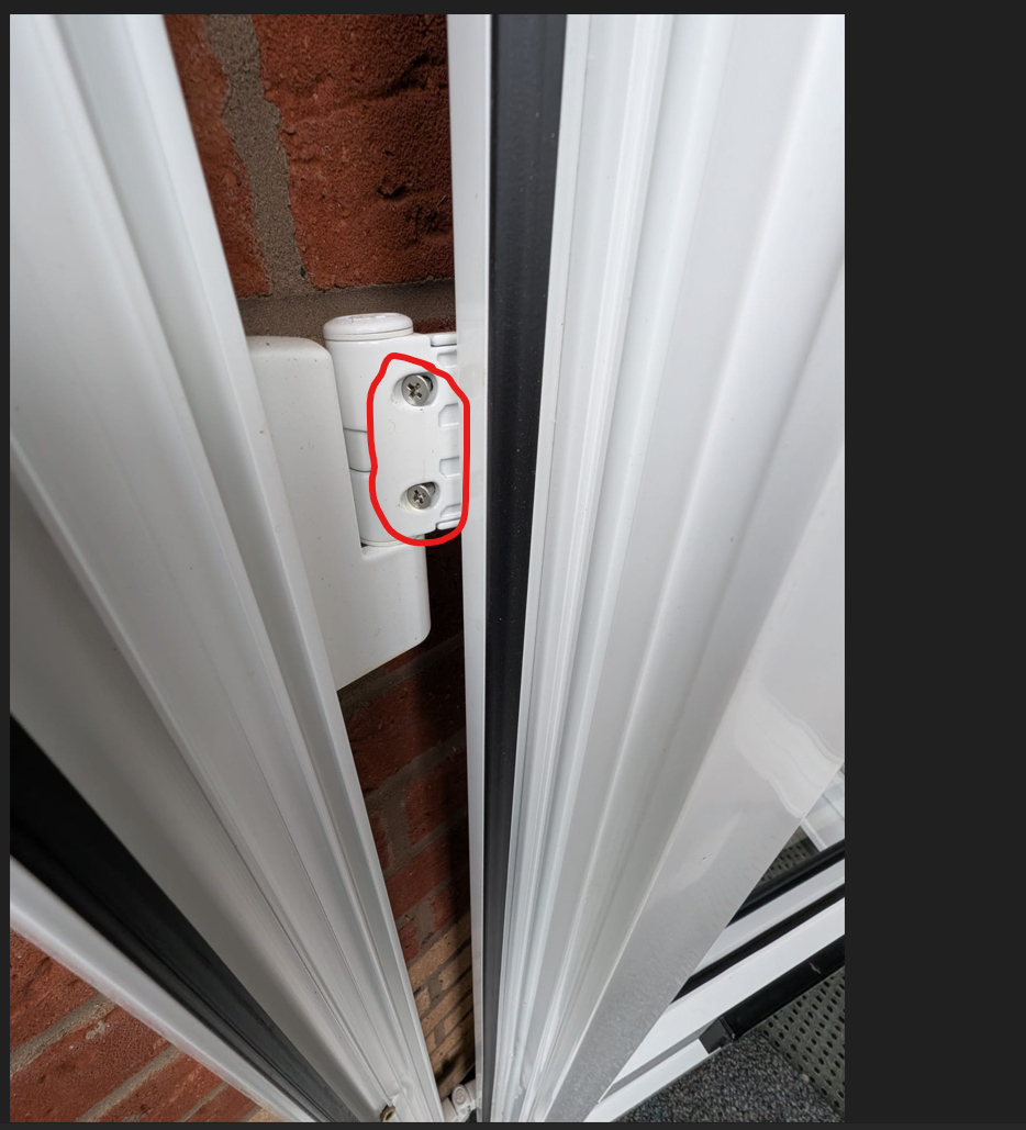

Each hinge has 2 Allan Key screws at the bottom and Phillips on the side. The Phillips screws are all loose, should they be?
The gap at the top right is about 5mm, which seems to be just enough to stop the locking pin engaging, if I close the porch from inside, give it a little push at the top and lock, this works fine.
How can I fix this?
Picture attached

You need to get the installers back, hinge adjustments or toe and heel won't fix that, it looks like the frame is in twist causing the gap, certainly if you can lock it when you push against the door, if the hook boxes on the frame are adjustable then moving the upper one inwards towards the house can help but it will reduce gasket compression, you could also adjust the centre latch the opposite way outwards so when you latch the door it's pulling it in tighter which in turn helps the hook line up better with the hook box on the frame
