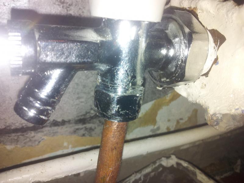

If you have a large pair of mole grips and the strength of a bear then the tail should unscrew.....but if you nack it, it will be a pain in the ass.
I'd go for the Screwfix key that newboy recommends.....it could also be used for fixing the new tail.
Keep us informed!

Success! I had to abandon the free method as I was getting no where fast.
I nipped out to Screwfix and bought the Hex key in newboys post and it came off in seconds with a bit of brute force just shows you, you have to have the right tools for the job.
I just need to make sure everything is water tight now! am sure I'll run in to problems and be back on here
I bought some Fernox LS-X whilst I was in Screwfix alonf with the pfte tape I already have.
