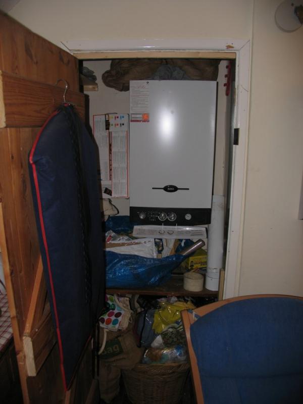

Or to increase the fun, how about a photo or two of the boiler installation itself :D
I will submit a centre-fold shot in a range of lighting conditions, and a range of manly scenarios. That is, Baxi 80E bent over the bonnet of a car, Baxi 80E holding a big gun, and Baxi 80E holding a pneumatic drill, all with it's front panel down to expose the components.
And a shot of the serial and model no.

In my OP TITLE, I detailed the make and model. Pics attached. The stuff on top of the boiler is there to stop the cold air from the loft blowing into the room- it does not normally sit there!

Pretty much sorted now- that is I haven't had one person suggest that the plastic pipe was correctly installed.
All done and dusted as far as I am concerned.
Many thanks
So what happened to the leaning condensing flue terminal which was unsafe, damaged and totally unsuitable?

It will all be fitted back in place by the heating engineers who's invoice I will try to pass on to the people who buggered it all up in the first place. What was critical* to my posting- and the comments-was confirmation (or no argument at least) that the plastic flue duct should not have been there and was the cause of the problem.
Possibly too close to the stack..... I haven't seen much by way of consensus on the forum, and the engineers that have seen the plastic pipe 1st hand, have not been critical of the position. We have bigger fish to fry- getting heating back after 3 weeks and counting, and forwarding the costs to people who we are sure*, are liable. .....something which I still expect to be difficult.
