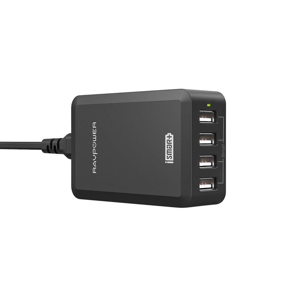

It would also depend on power requirements. I know with a 3.1 amp per pair double 13A socket with USB it will supply my wife's IPad with 1.5 amp, but from a computer it seems around 0.4 amp is the maximum. Most powered USB hubs will supply 0.5 amp you can buy these
massive 40W output, but not sure if I would want to hide it in the ceiling or wall, and if put in a box then why not use a grid system?
