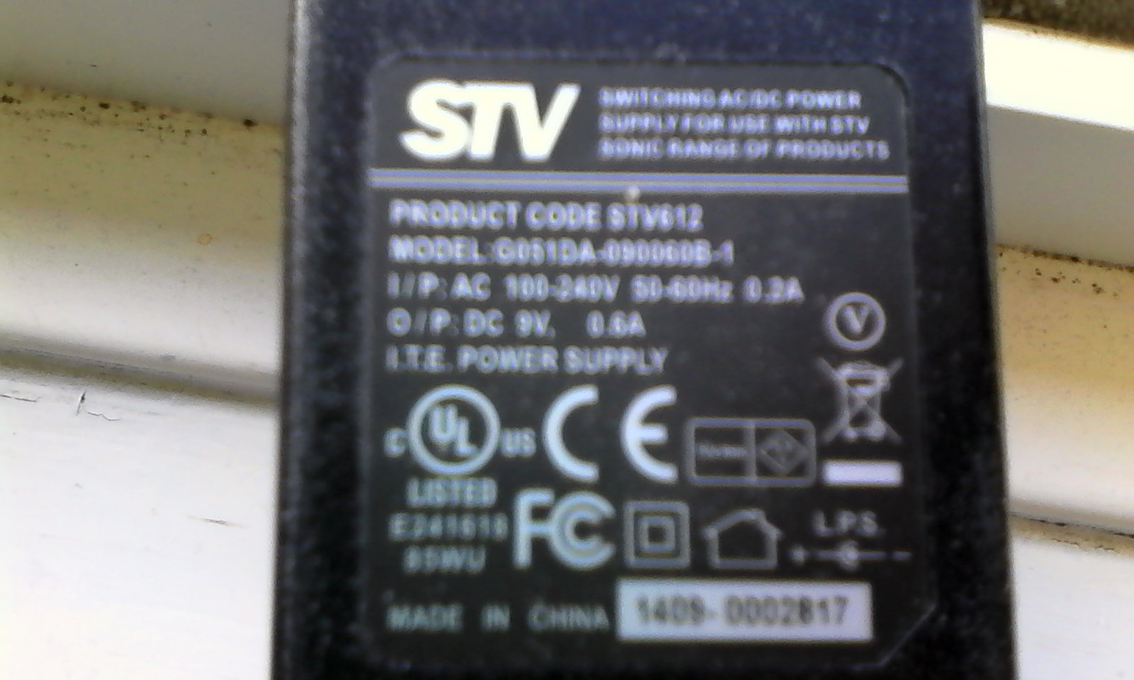

Ive a defender stv sonic cat repeller with a 9 volt, 6.4 amp adapter.
The adapter usually lasts a year before failing and are £14 to replace. It's ite compliant also.
Ive seen other adapters that not only cheaper, but more importantly I believe will last longer. A different make of repeller's adapter has lasted 12 years 24/7 and still running
One replacement adapter is a 9 volt, 1 amp and with short protection.
Are there any issues I've overlooked in replacing the adapter? It will be indoors, with the lead going through the wall to the repeller outside.
If the device requires 6.4 amps (which seems grossly excessive), an adaptor which can only supply 1 amp isn't going to work.
Are you sure it doesn't say 6.4VA? Do you have a photo of it?
What on earth is this repeller device doing that requires 6.4A?!?

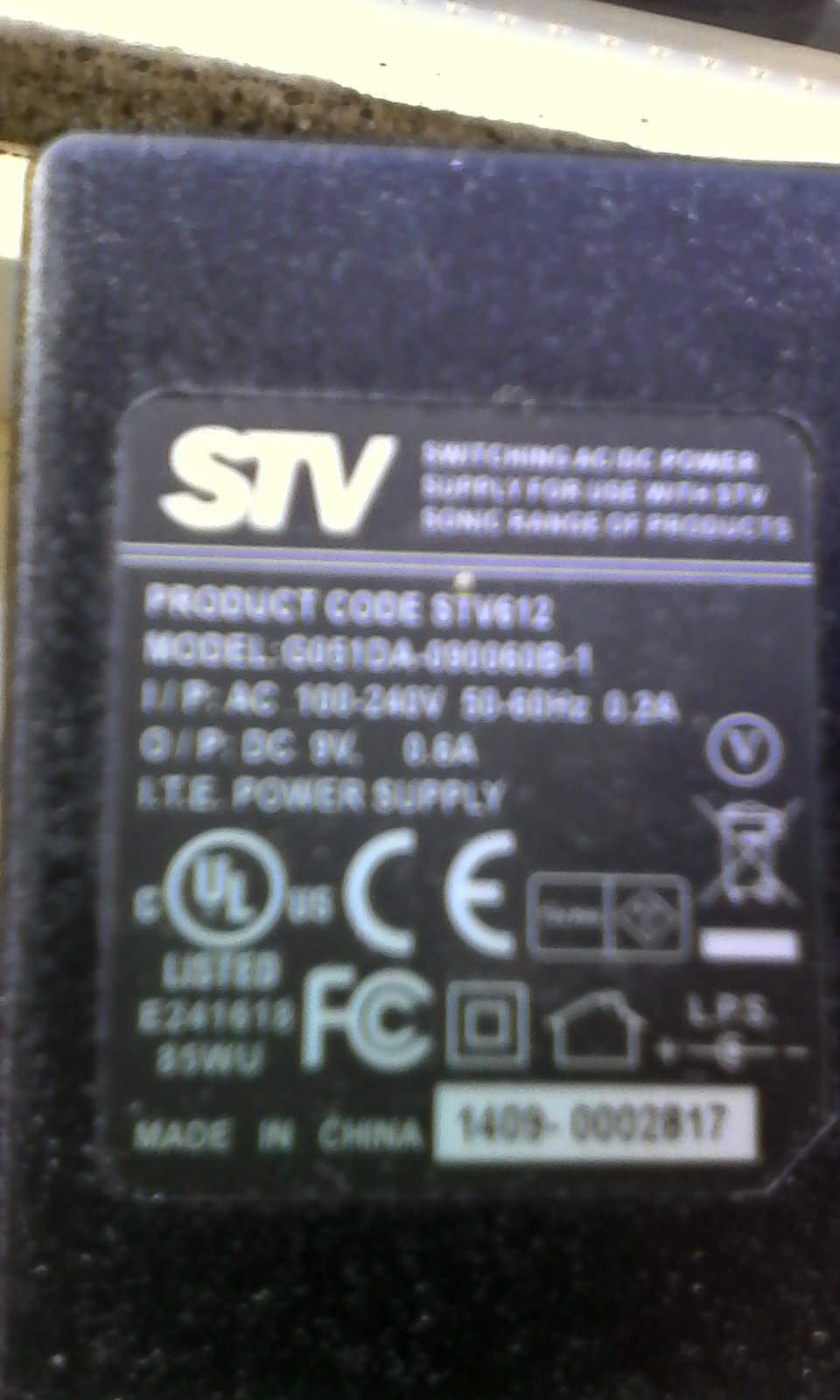

Pic, sorry , typing error 0.6 amp output on original adapter.

As long as this adapter you have found says it is compatible with the repeller, then it's fine.
In theory you can use any 9v DC adapter which is rated at 0.6A or more, as long as the DC jack on the end is the right size. But, I see in your picture that it has a negative centre pin, which may be harder to track down a replacement without you having to do some soldering.

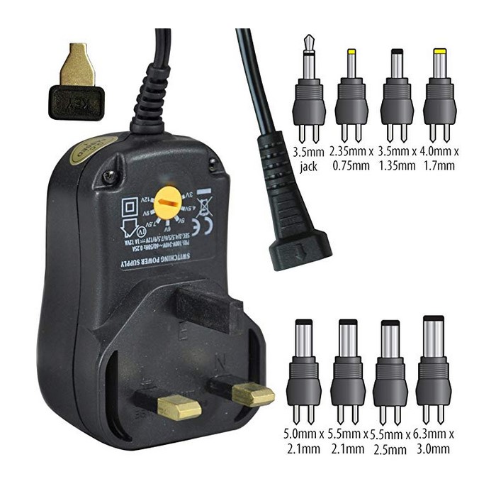

To solve the polarity problem, get something like this
For the opposite polarity, just plug in the adapter pin rotated 180 degrees. Simples :)

Great. Saves getting the soldering gear out. Thanks for the help everyone
