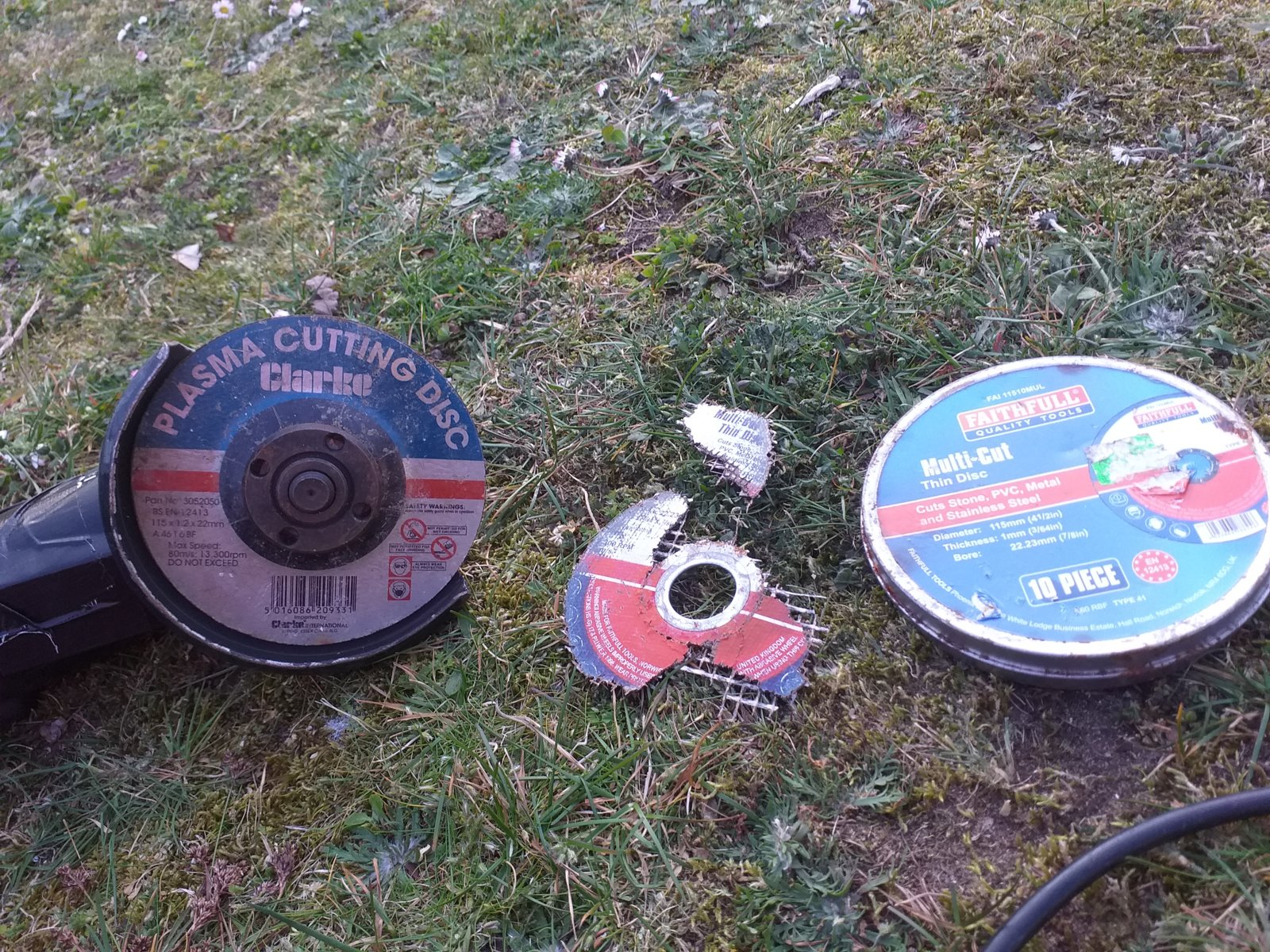

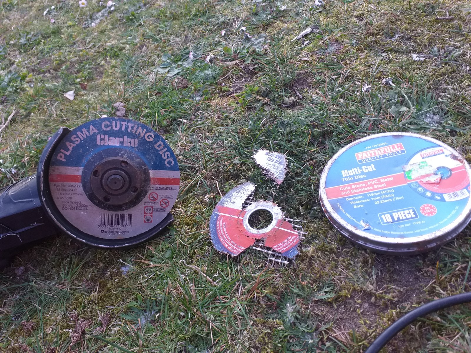

I used a multi cut disc on a thin bit of metal. It never felt like it would cut as well as metal disc then . I was trying to force it and wouldn't cut smoothly. Then the whole thing came apart. Is this the blade's fault?
I wore goggles for sparks but is there any other way you could injure yourself with this dangerous tool? Do u cit with the direction of rotation
going away from you?

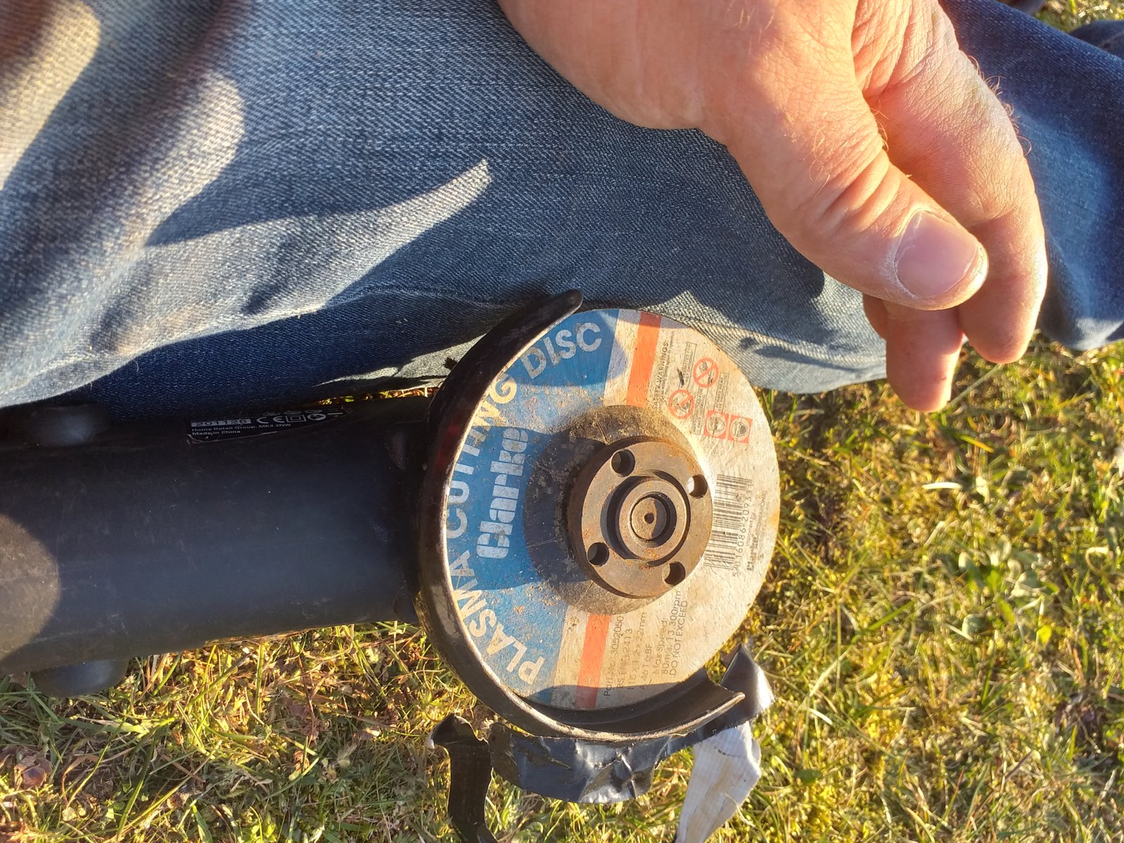

It's mounted the wrong way, dish goes the other way
Edit, maybe a trick of the light - are they dished?
Also, use only for slitting action, never loading the face of the disc. (Though by your description you may have been doing this anyway.)
Nozzle

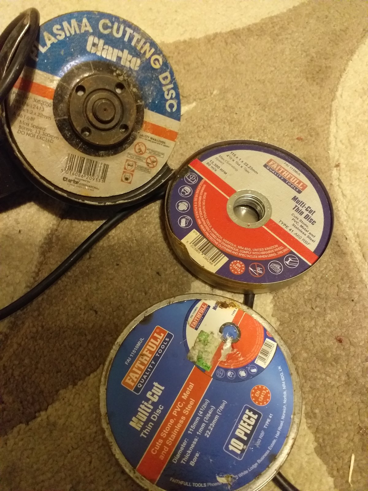

Edit 2 - The disc currently mounted and the broken one aren't the same brand, just in case anyone is thinking the Clarke is duff

User error
never try and force them and vibration and bouncing is a sign something is going wrong.
You can injure yourself with any tool, even a hammer.
Slitting discs are just fine if used properly, but allow them to twist or jam just a fraction and they split like this.
Resist all temptation to grind or smooth with them!

Also the discs/tin look old, they don't keep forever, especially in a damp shed
was the boss centred properly on the grinder? there is no dish on a slitting disc. You have twisted the disc in the cut, You should not have to force the blade, the weight of the grinder should be enough.

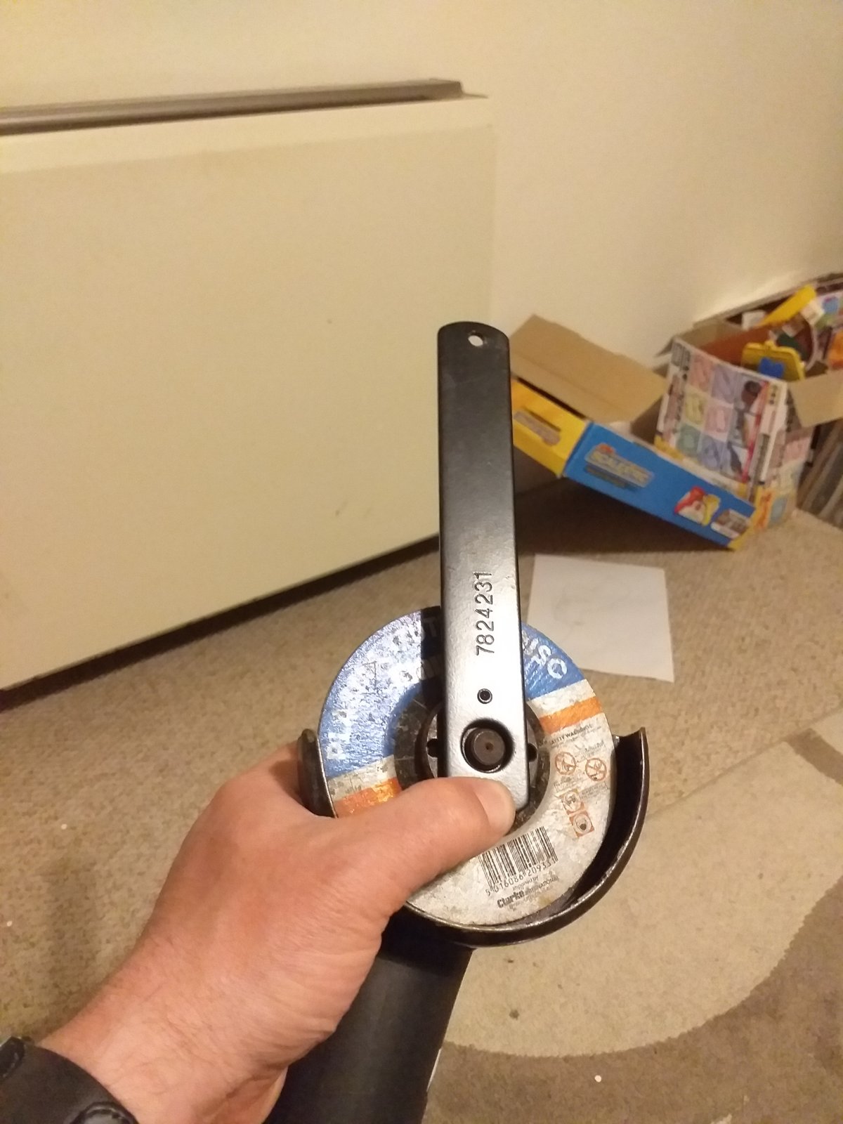

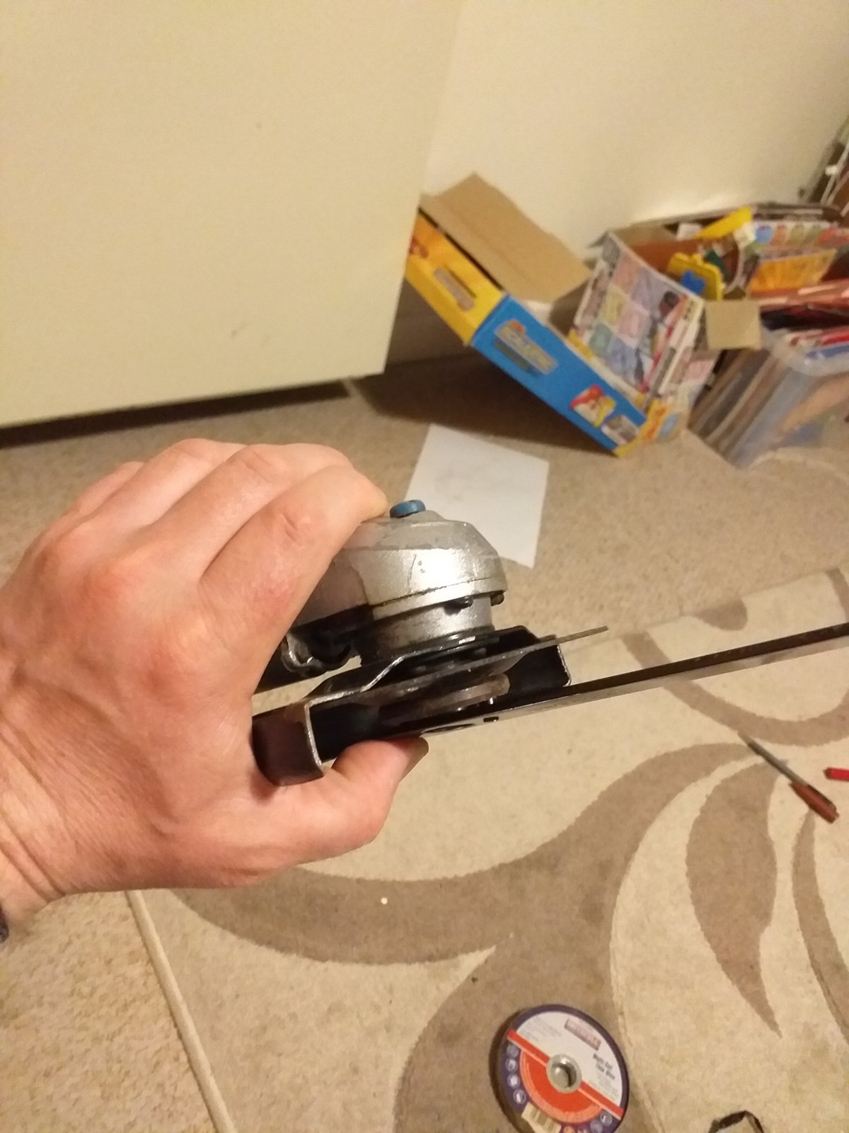

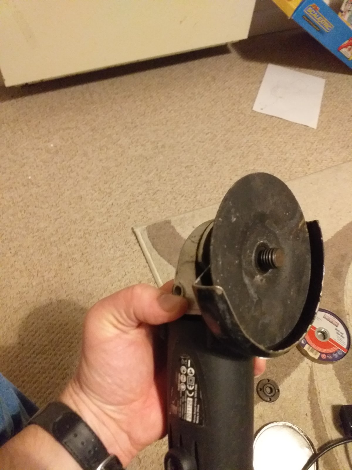

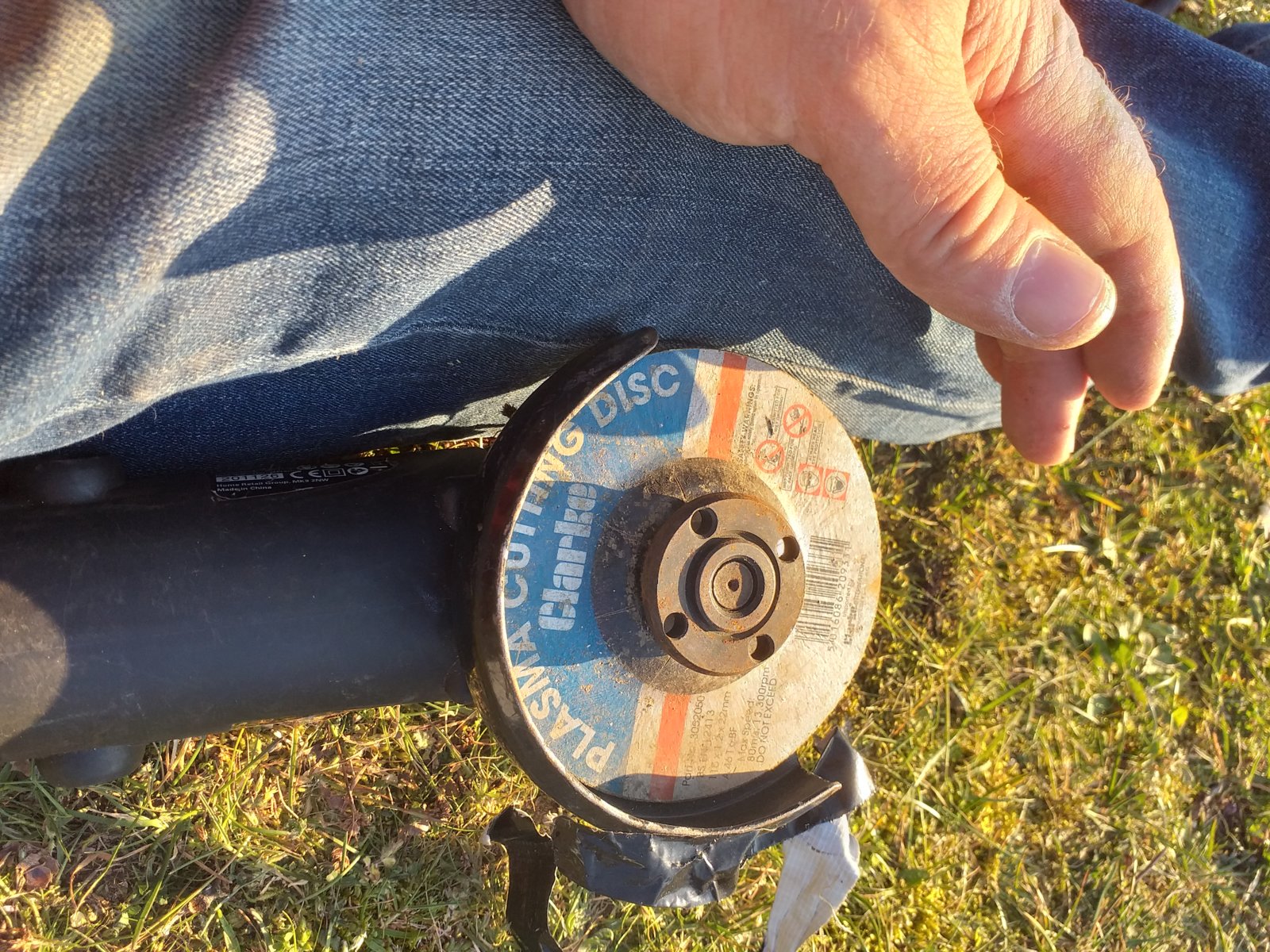

Think so. The disc is the correct way round, isn't it?in the photo i turned it round and it fitted ( see top photo), didn't plug it in just checked it fitted. Surely it should the other way with writing facing away from device?
I pushed the blue button in then when it locks turn with key thing to lock it. The disc won't come off with it?
No date anywhere
You have two different discs there. The one in the grinder IS dished and is on the wrong way round, Can you not see that it's touching the guard? The ones in the tin are flat discs, It doesn't matter which way they fit. the dished ones do. my other advice still stands, If you cannot see the difference, I respectfully ask you to put the grinder back in it's box until this lockdown is over and wait until someone can SHOW yo what you need to do. The NHS is on the brink already and they don't need anymore people in A&E
