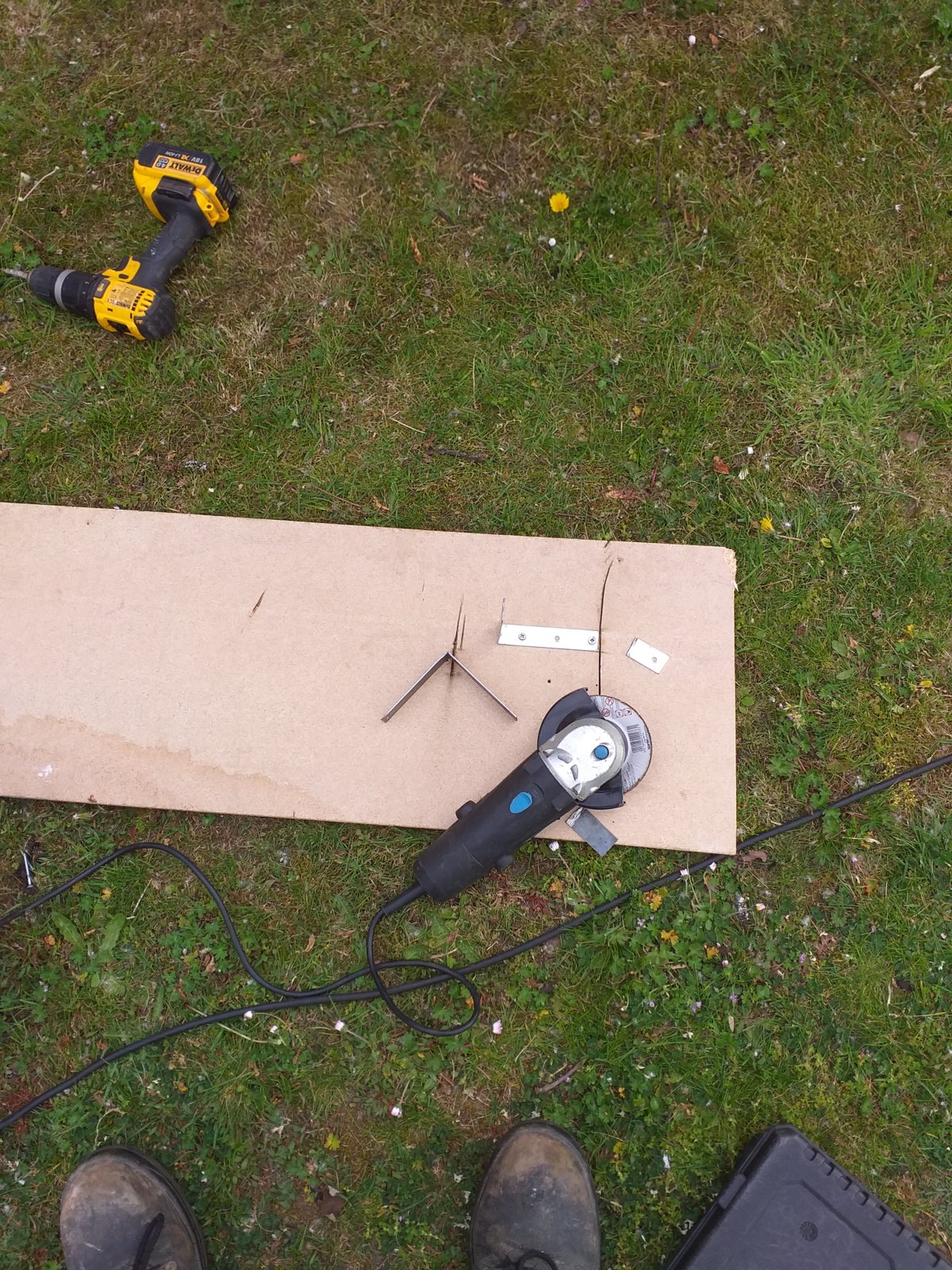

They seem like quite a dangerous tool. I was using it to cut some repair brackets on this bit of wood in picture. It did feel like it might slip and remember this guy saying you should cut with the blade going a certain way. Any tips?
Indeed, a dangerous but very useful machine.
You have the work well secured which is essential and on those pieces cut from top to bottom. You need to avoid the blade digging into the work but in this situation it's unlikely.
Always use two hands and keep the guard on.
John :)

As John said, ensure the work is secure.
Keep both hands on the grinder.
Don't let the blade dig in, slow and steady is the game.
Wear decent eye and ear protection, and I prefer to wear gloves as well. Respirator, if cutting stone, brick, or the like.
Probably though, most importantly is to plan your work properly.
Have plenty of room to work in, and light to work by.
Expect sparks, so don't fear them, but ensure nothing flammable is in range.
Plan your cuts, so you can ensure that the cable isn't (and won't ever be) near the cut.
If cutting heavier material and experiencing jamming, Google 'climb milling ' and the reason may come clear (y)
John :)
Alway ensure you are using the correct disc for the job! Tantamount IMHO.
Tantamount?! I meant paramount :lol:

For the above use I would not have screwed that bracket onto the middle of the wood to cut it as your also likely to catch the wood itself, IMHO its far better to have screwed it to where the bit to cut off is hanging over the edge so that there is nothing underneath to catch the cutting disc on.
An angle grinder is the most dangerous tool in the workshop, or out of it. Followed by the table saw. I only use mine when there is absolutely no alternative and I wouldn't even consider using it to cut those tiny, thin metal brackets.
I would remove the bracket from the wood and clamp it to cut it - I don't think an angle grinder and any kind of wood is a safe combination myself.
For those tiny brackets, put the grinder away and use a hacksaw.
