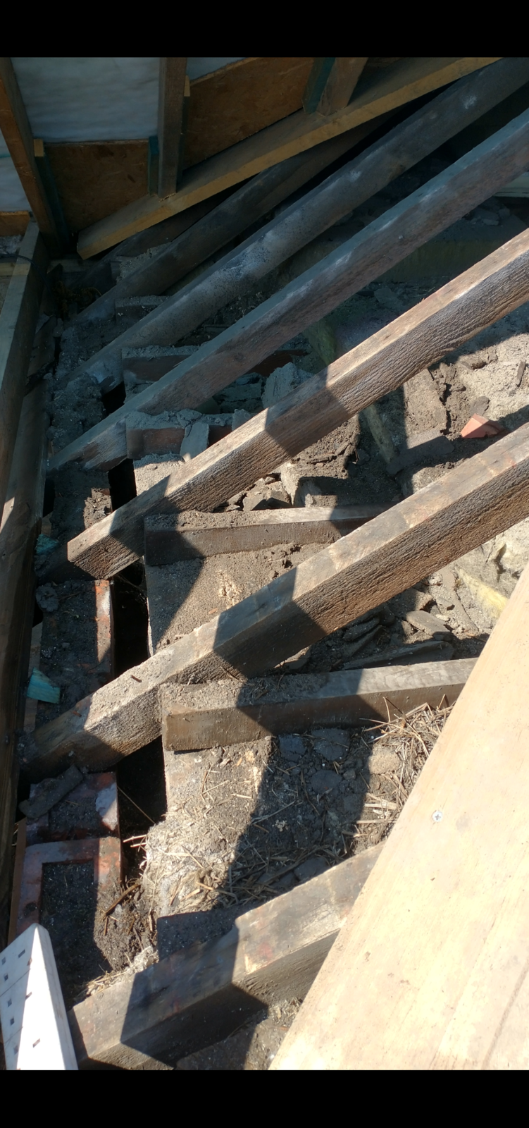

Hi all,
I'm helping a friend renovate an old house he bought and our next project is to insulate a loft that will be used for storage after replacing the ceiling. There is limited headspace up there, so to maximise usability we were planning on using kingspan/celotox type insulation board in place of normal roll out loft insulation.
We were planning on using 100mm of insulation board between the ceiling joists and then boarding with chipboard on top. Will this setup be sufficiently insulating?
Any input would be appreciated!
Thank you
Current standard for loft insulation is 250-270mm of soft, depending which type. Think you'd need a bit thicker than 100mm kingspan (300mm rockwool gives U of 0.14, 100mm pir only gets to 0.23). Plus it's very expensive at the moment & a horrible dusty job cutting it to fit- you need a snug fit.

Yes I'm certainly aware that it's expensive! I would have just gone for soft insulation and loft legs and just cope with a small amount of headspace but he (and the Mrs) are pretty set on wanting to use board insulation. We could go up to 120mm as that's the joist width but it seems harder to find.

One quite good compromise (if you can afford to lose 100mm) might be to put 120mm rockwool between the joists, floor with something cheap and thin (10mm OSB or that sort of ilk) then cover with 100mm PIR and chipboard on top. Saves a lot of cuts on the Kingspan (always assuming you can get 8 x 4 sheets into the loft :) )
The joists will be a cold bridge a bit, you really want to be covering them in insulation
The big problem with rigid board insulation for that use is that it is difficult to get a snug fit between all the joists and against the ceiling, and any gaps may well mean that you may as well have just used cheaper quilt instead.
Use a higher performance cavity batt rather than rigid between the joists - much easier/better fit. Put rigid on top of the joists and then floor directly on top of that. Identify the floored area and swap to standard 300mm mineral wool in those areas that won't be floored (heading into the eaves), pay attention to the eaves - go back to the higher performance stuff, ensure it is fitted across to the cavity while maintaining airflow above it.

Also depending on age of house consider strength of old joists to carry even slightly more load without causing ceiling cracking - might be worth considering sistering some deeper joists with a lower ceiling to avoid this and give extra depth for insulation.

If you use kingspan or similar, you can lay it on the joists (no intermediate floor) then lay floor on top.

I did as suggested above. Rockwool between joists, cavity batts (small 4x2 PIR boards) on top then cover with hardboard. Ideal loft floor.
If you stand on one foot on a sheet of PIR you probably won't dent it, although you might at the toes or heel if you walk on it. In a loft with 2" rafters then there's a fair amount of surface area to spread that force over.
