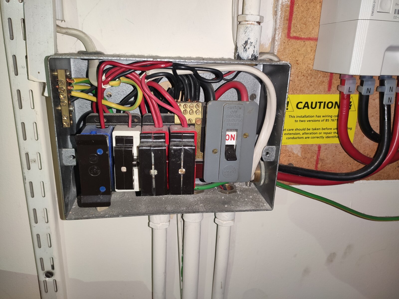

Using pre installed cooker circuit for 13amp or 16amp oven.

Yes it's a domestic kitchen there is already a dedicated circuit with 6mm cable going from 32mcb to 45cooker switch then 45a cooker connection plate then 6mm cable to cooker. But we are getting a smaller single oven which is only 16amp but need be hardwired. So should I change 32mcb to 16mcb I'm consumer unit or just get electrician to wire it straight into connection plate with cable supplied.
