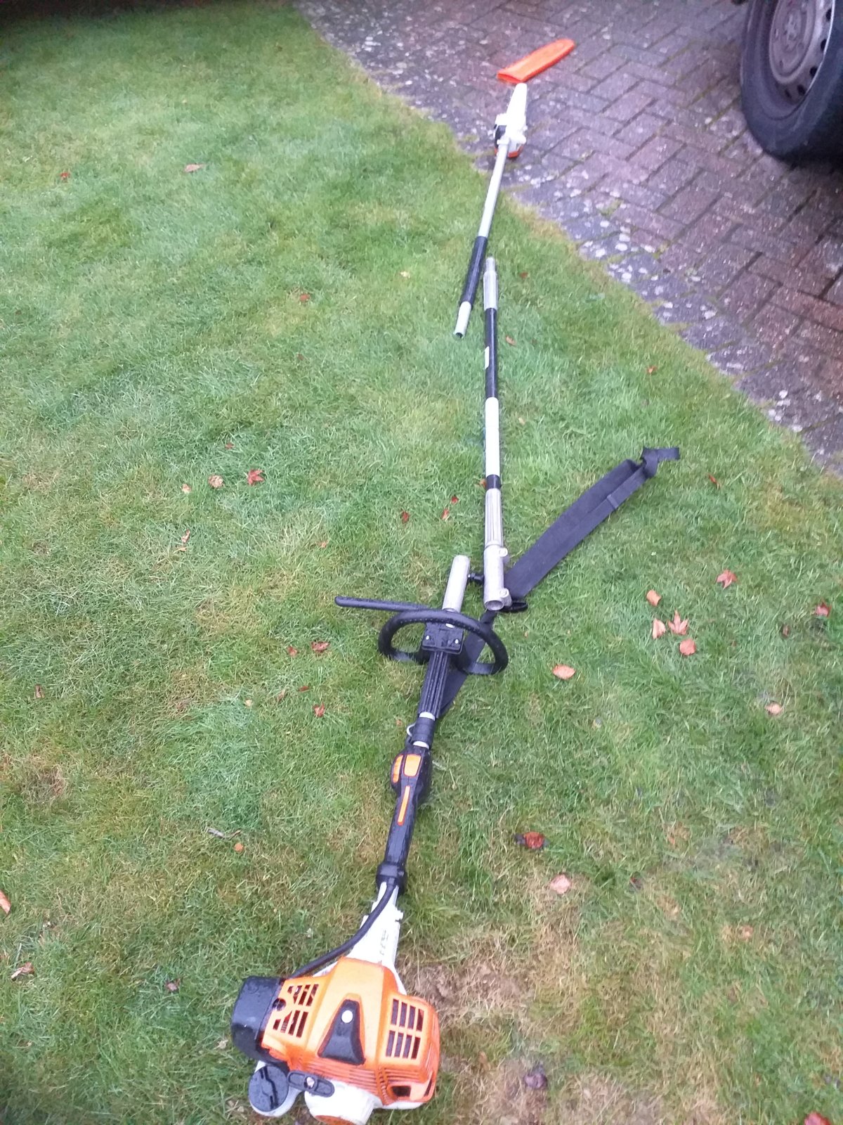

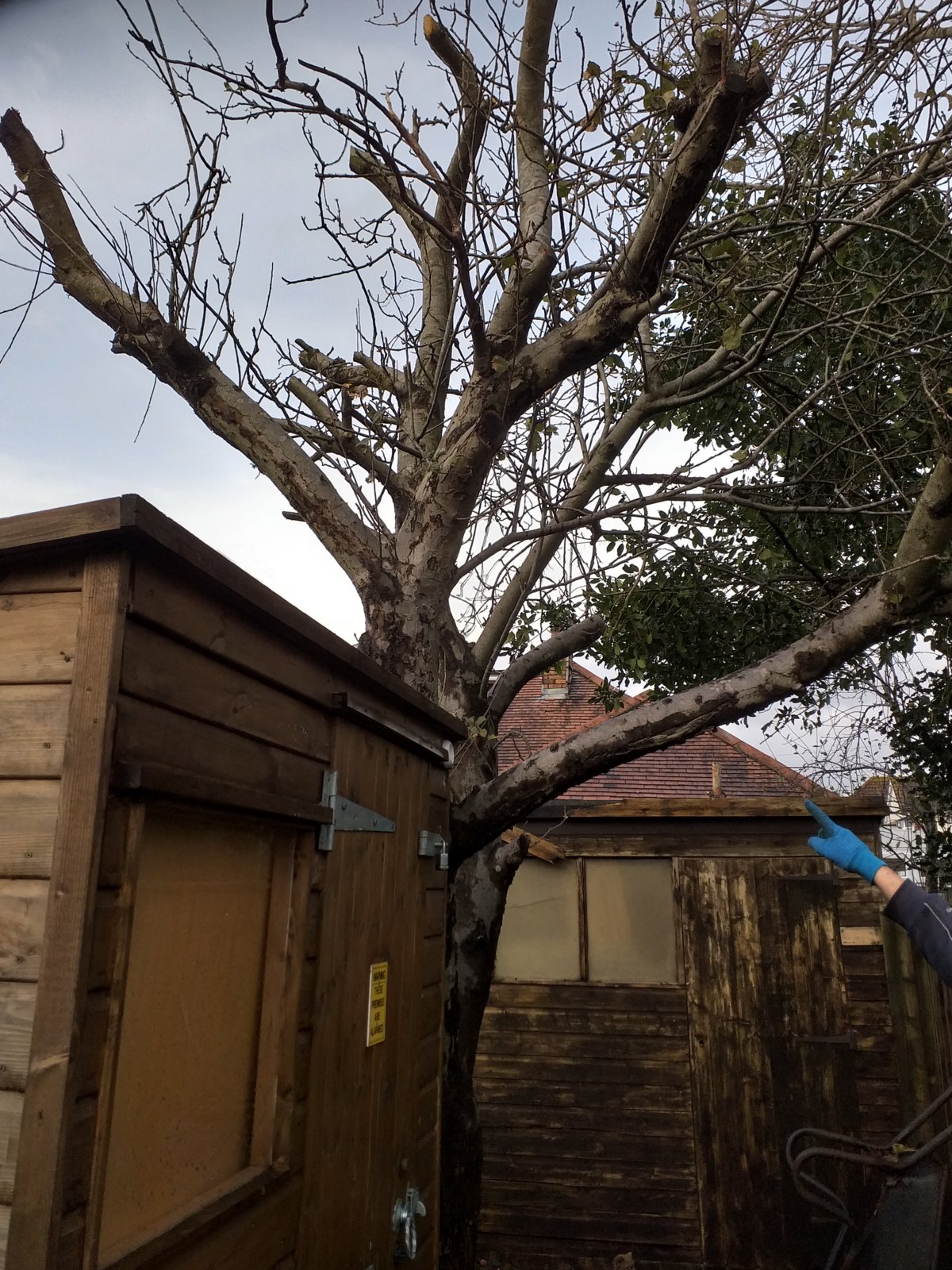

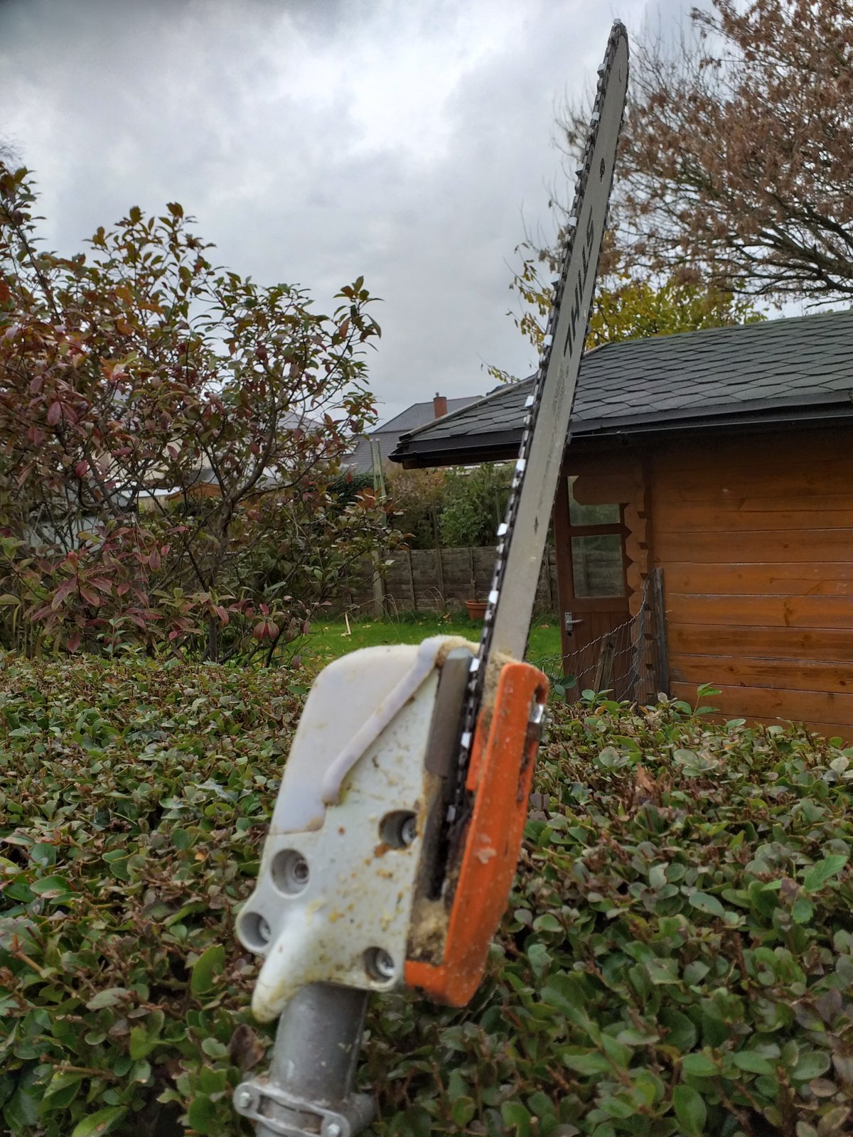

I was trying to cut down some four or five inch thick branches from an apple tree and when I'd cut a certain way through it pinched my saw and it got stuck. Any tips? Had 3 sections including middle extension so was very long
Also, how useful are these mini chainsaw?
What would be the next stage up for a chainsaw to cut slightly thicker stuff?
I think you are pretty close to the limit of your pruner - brilliant though they are. Try cutting a wedge shaped notch to prevent jamming.
A pro would probably climb the tree to attack boughs of that size and get stuck in with a chainsaw (not recommended!).
If you want to burn the cuttings, you need a small hobby saw, such as the Stihl MS 171 to chop them up.

Is it ok to mix different brands if chainsaw oil in it?
Is there a technique for using it? I mean is there a way round to use cutter when attacking branch?

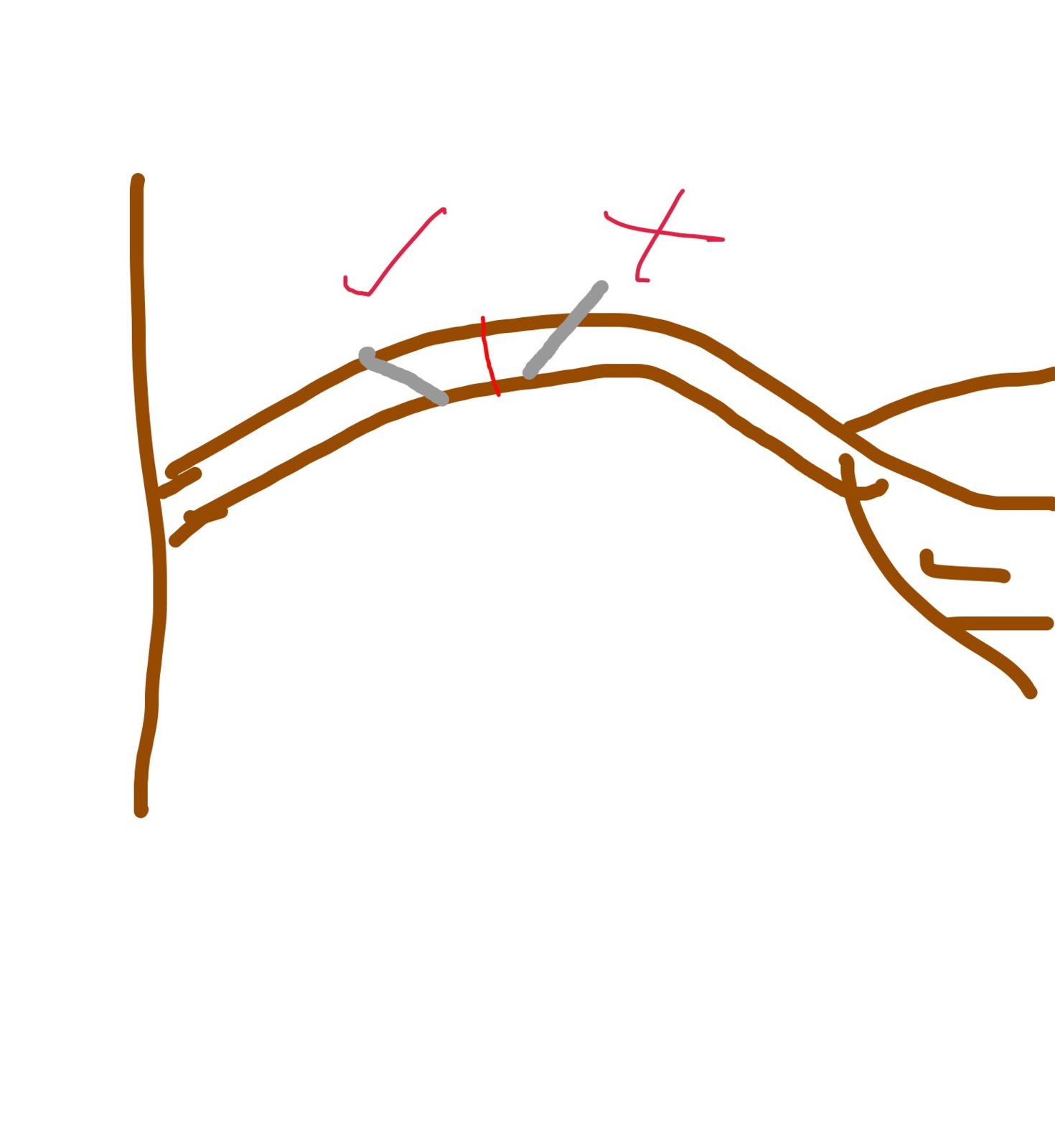

With rep saw, I always try to go from above (top of branch) so weight of branch causes split to open as you cut.
Got stuck when going from side (but with rep saw can remove trapped blade and try again with spare blade).
So position chainsaw blade directly above branch and lower chainsaw onto top of branch.
I also put cut on underside so that bark does not peal back too far.

Trial and error, cutting wise...I sometimes undercut a branch before slicing through from the top - as the branch weakens the top cut can open as there is a gap below.
Every branch is different though!

If you cut sloping to the left of the vertical red line, as the branch splinters and drops it clears the blade but its more likely to trap the blade if you cut with it sloping to the right.

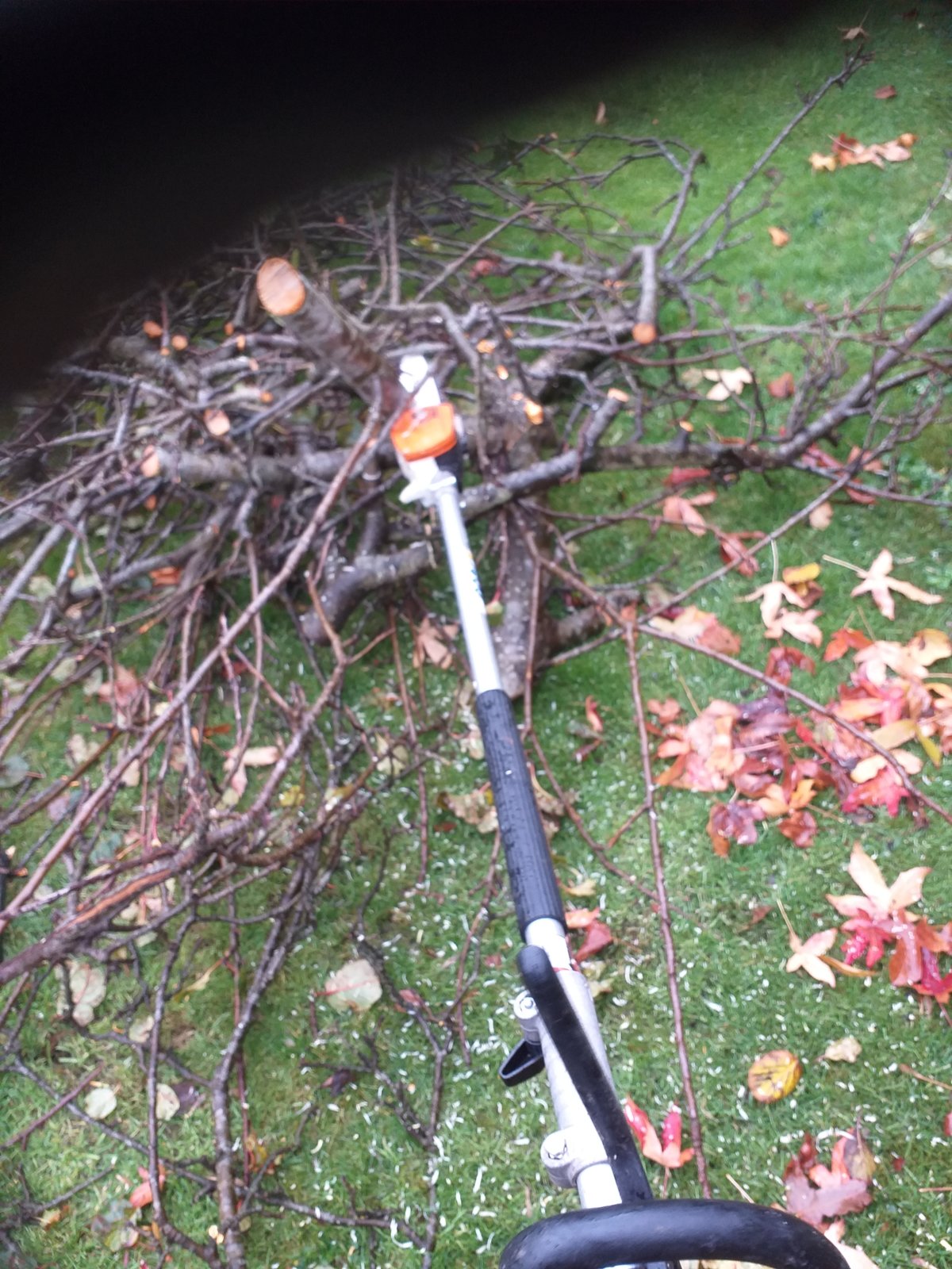

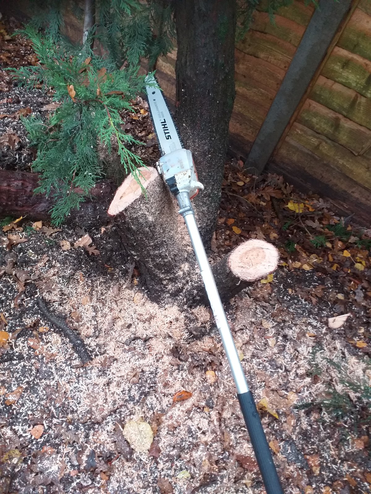

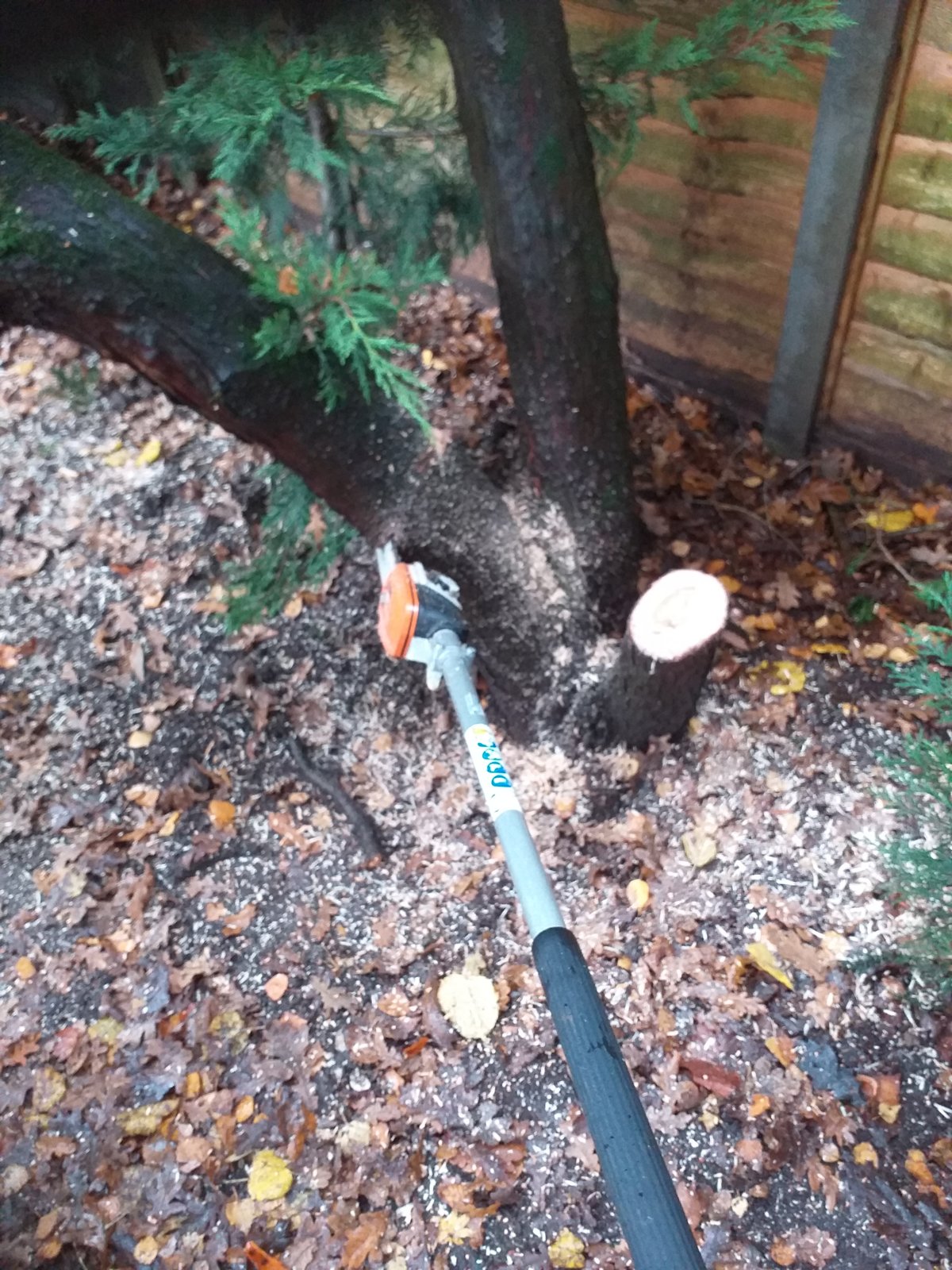

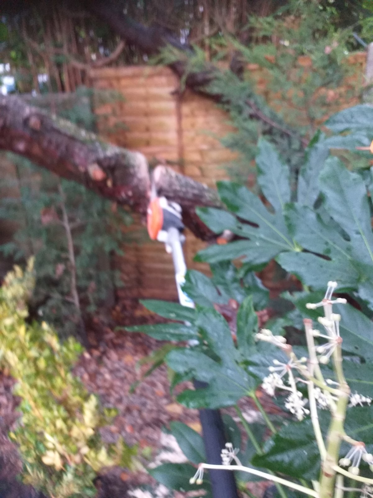

This was a really thick branch I cut with it. Kept cutting wedges to stop it jamming.
I wouldnt be wearing out a pole pruner cutting where it can be safely done with a chainsaw. The art of not getting pinched so much is identifying which is compression or tension side
