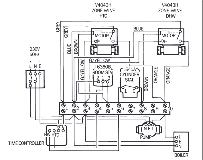

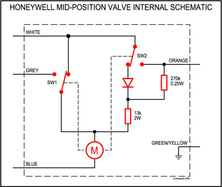

If one looks at a S plan S-Plan.jpg it seems the motorised valve isolates the boiler supply from the valve supply, this is not the case with the Y Plan, so with the S Plan you should be able to drive the valve completely independently from the grey and orange wires which work the boiler.
We have the same with a thermostat, with no volt contacts the supply to drive thermostat should be independent to supply to motorised valve or boiler.
But look at a mid position valve
and it is clear there is no isolation between the motor supply and the output to the orange wire, and here we are looking at Honeywell, not all makes are the same, so be it the motorised valve or the wall thermostat the big question is would a like for like replacement always have the same internal wiring? Is there a version which does not isolate?
The question has raised its head many times, should you plan for what some one may do in the future? Be it change a 60 watt tungsten bulb for a 10 watt LED and the resulting impact on a dimmer switch, or part of a central heating system. We see it again and again, some one thinking they are making an improvement splits the down stairs and upstairs lighting, and as a result we have a borrowed neutral. (really a borrowed line)
@stem has pointed out most manufacturers say all the low voltage (230 VAC) supplies should come from same source, not well written, as very few houses have multi-230 volt supplies, they one assume mean the same circuit, i.e. uses the same overload device, so if there is a fuse inside the boiler then supply would have to come from the boiler, and I think that is not really their intention, so we again come down to the English used in instruction manuals and wiring regulations rather than the actual electrics involved.

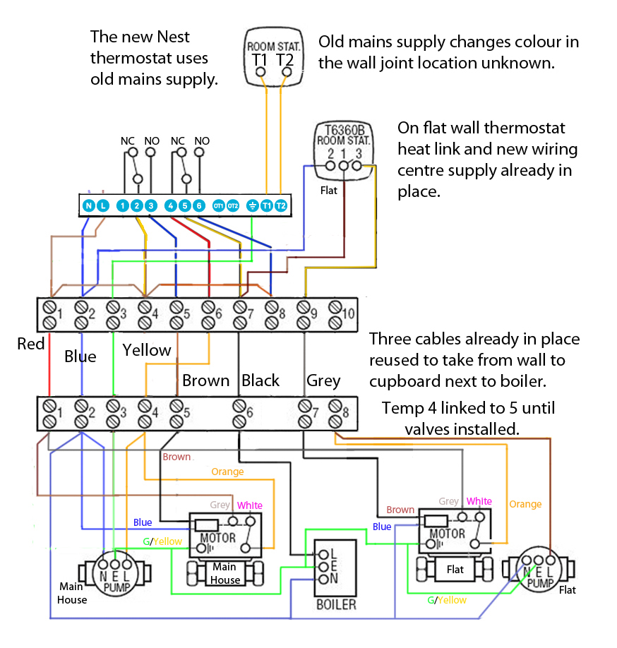

So as a system designer you can produce a circuit diagram so anyone who follows can see exactly how it is wired, this is what I did, so this C_Plan_My_HouseD.jpg is one of the plans I made for my own house, however even that is flawed, as I kept altering it, and now can't remember which version I used, but time to work on central heating is the summer, so time to correct errors without risk of freezing.
However if you make an as built plan of your heating, then you or others can study it and see errors or prevent errors in the future. So as long as there is an as built plan in the boiler so anyone in the future can see how wired I see no real problem. However been in this house now 18 months, yesterday say some thing in the boiler, and on retrieving it, found it was boiler instructions, with mothers bosch boiler there was a place in the panel designed to hold the paperwork, but this oil fired bosch boiler does not have a built in pocket for paperwork, so I was unaware it existed.

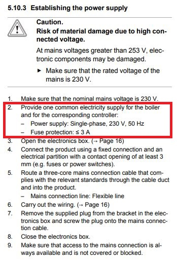

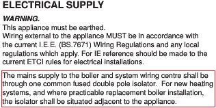

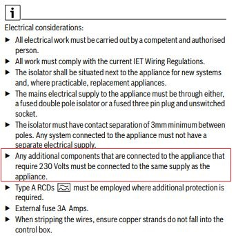

So the next is manufacturers instructions, which need to be taken into consideration. @stem published four examples of manufacturers stipulating supply types this
but these
makes leaves no room for debate it does not even allow a plug and socket, the first one Worcester Bosch say what type of RCD must be used, and so how much consideration should be given to manufacturers instructions? Should a heating engineer tasked with fitting that Worcester Bosch tell the customer he needs his type AC RCD swapping for a type A, and I see no reason why a boiler should not be plugged in with standard 13A plug.
