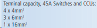

6mm cable? Two into the feed side? Can it be done?
Well, I didn't install it, and it may not be 6mm² cable (4mm² is usually fine for a 32A cooker circuit), but they've certainly done it somehow.
In any event, looking at the spec for MK ones, there would seem to be no problem with 2 x 6mm², if that';s what one wanted/needed ...

Do you not think that a decent qualty socket would be capable of carrying a lot more load than the spec. says. That was the point I was trying to make.
Often as not, it is the plug, rather than the socket, which overheats and causes the problem, damaging both the plug and the socket it is plugged into.
