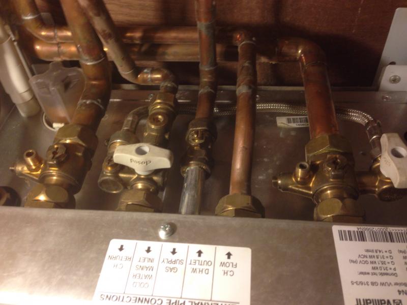

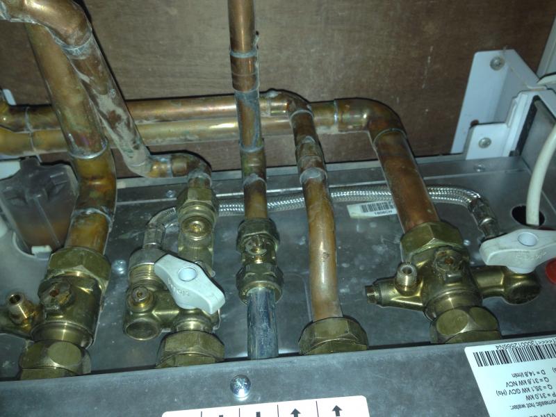

Thanks again gazdaz36 and bunnyman, I think you're both right. Before I swop hot and cold pipes around can someone confirm from the picture attached that the cold IN should be the plain copper pipe to the left of the central chrome gas pipe (not as the order in the label) and that the hot OUT should be the one with the currently closed grey valve (again not as the order indicated by the label). The system is currently plumbed the other way around - as in the order shown on the label. I can see why the pressure may drop with a hot water tap left when the cold IN is switched off. Apologies for random capitalised 'chance' word in last post. Please ignore that one word. Otherwise I hope all else makes sense and the image does not appear back to front. It's not how things appear to me when lying on my back in the loft space but as a camera phone recreates, as if taken looking up at the boiler as if hung high on a wall - viewed from below the boiler facing the wall on which its hung...
