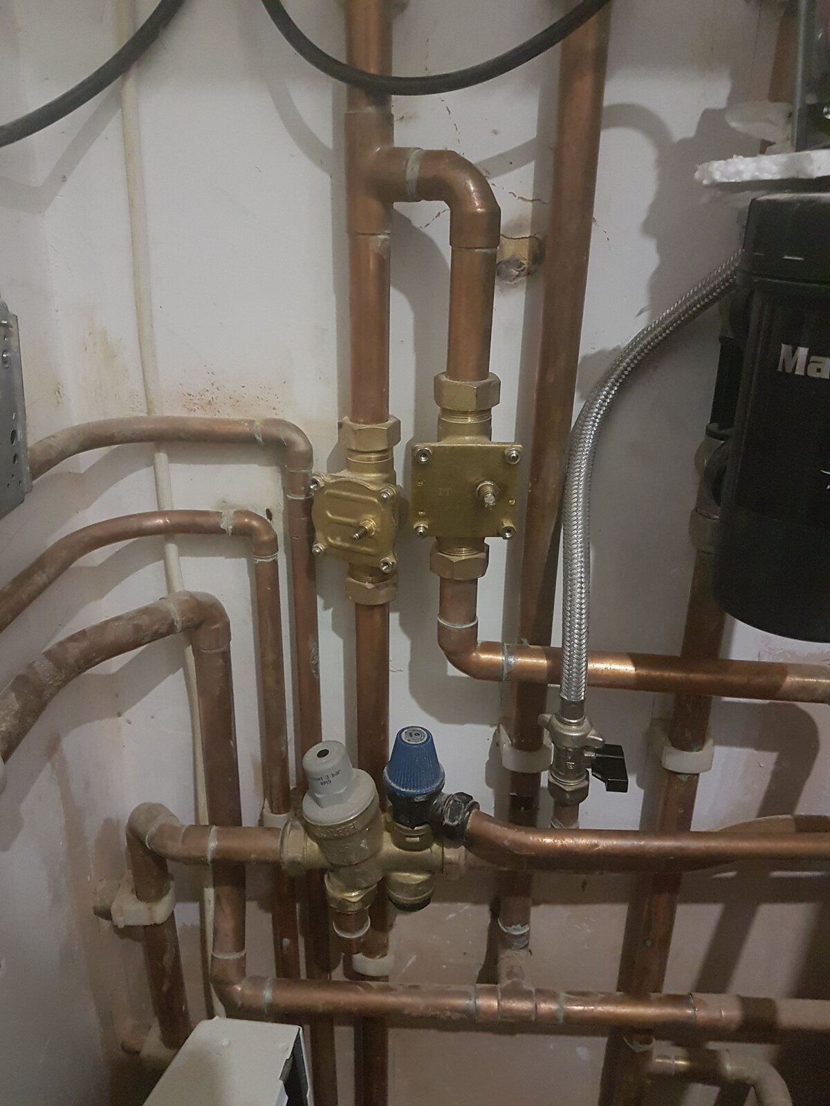

I have a pressurised unvented system. Vaillant ecoTec plus 630 system boiler with telford tempest 300l tank. Turned on the heating a couple of weeks ago and found that the upstair radiators were not heating up. Went round bleeding the upstairs radiators without realising that the boiler pressure was at the lower end of operating limit. Bleeding the radiators resulted in the upstair radiators heating up. All well and good. Following morning no heating and hot water. Boiler displayed F22 fault code (0.7 bar). Topped-up the pressure to 1.2 bar and this resulted in boiler firing up, pump coming on. However the temperature of the boiler quickly rose to 84 degrees and then the pump went into overrun mode. CH Pipe further down the 2 port motorised valve was luke warm. Assuming this was something to do with motorised valve malfunction. Removed the valve head and can turn the valve spindle with hand without any resistance. Have the same situation with the 2 port HW motorised valve as well. At present, i have run out of things to try. I will post a photo of the setup with description shortly.

Posted a few photos. Happy to provide description if required.
Is it the little grey cap behind the connector on the pump in the first photo? I do not recall touching it. Does it need to be like half a turn or so of being thumb tight? I have double checked and it is about a quarter to half a turn of being thumb tight. Does the pressure on the guage next to the pump look ok? What is the little red lever thing to the right if the pump for?
Increase the system pressure to 2 bar.
Then switch off electrics to isolate the boiler.
In the centre of the pump is a hole ,using a no 2 Phillips screwdriver ,into the hole ,push into the pump and rotate the screwdriver several turns whilst still pushing inward . This will manually spin the pump .
Then switch electrics back on and turn Ch on.
The heat being generated by the boiler is not being dispersed ,that has to be a fault in the pump ,or air present in the pump or boiler internals.
By the way keep an eye on the pressure ,if boiler runs ok now ,you may need to switch it off and release pressure back to normal level around 1.2 bar.
Thanks Terry for your response. I have followed your instructions, turned the pump a good 20 odd revs. The situation has not changed. Pump goes into overrun (as per live monitoring) in a minute or two which i take is expected to disperse the heat. The hot water flow out from the boiler is hot until the T joint (image 3 left pipe out of boiler) just above the valves. Sometimes it gets hot up until the valves. Still feel it is a circulation issue, i take the internal and external expansion vessel pressure doesn't come into play with this. Aah, one thing to point out here is that there is an immersion heater in the telford tempest sealed tank. When i switch the boiler off at the mains and switch the immersion heater on for a fair few hours, the flow out pipe from the boiler is hot and radiators upstairs are luke warm. I suppose this re-enfirces that the issue is inside the boiler somewhere?
