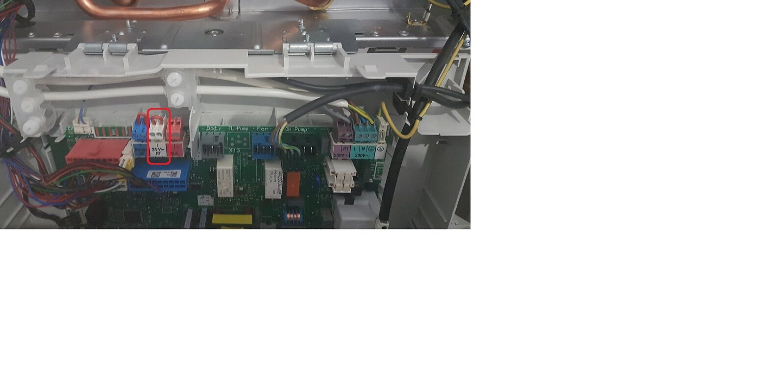

@Johnmdc - been away for work. Got back today and checked that 24VRT link has a little read wire linking two terminals on the connector (photo attached). I take you are asking for this to be removed to check if the short cycling still happens?

Yes remove that link.
The boiler will just run constantly with it in place.
Thanks John. I take it is normal practice to remove this link? The only reason i can think this link is put in place is to get the boiler going even without a thermostat? This cause of short-cycling would explain significantly higher gas bills even during summer months. Really hurts knowing that the installer should have removed this link as Hive thermostat was installed at the time of boiler installation. I will remove this link and report back on the boiler behaviour later this evening hopefully. Thanks again.
just a typo by @Johnmdc it is actually 24v as it says on the plug and yes it needs removed, very common for this to be missed by installers sadly
