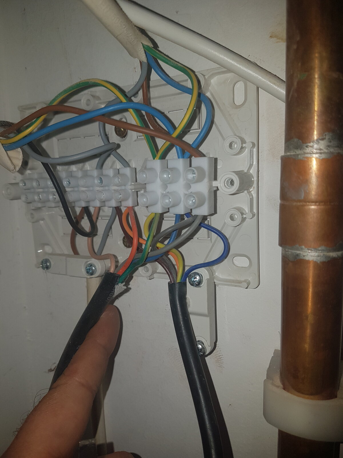

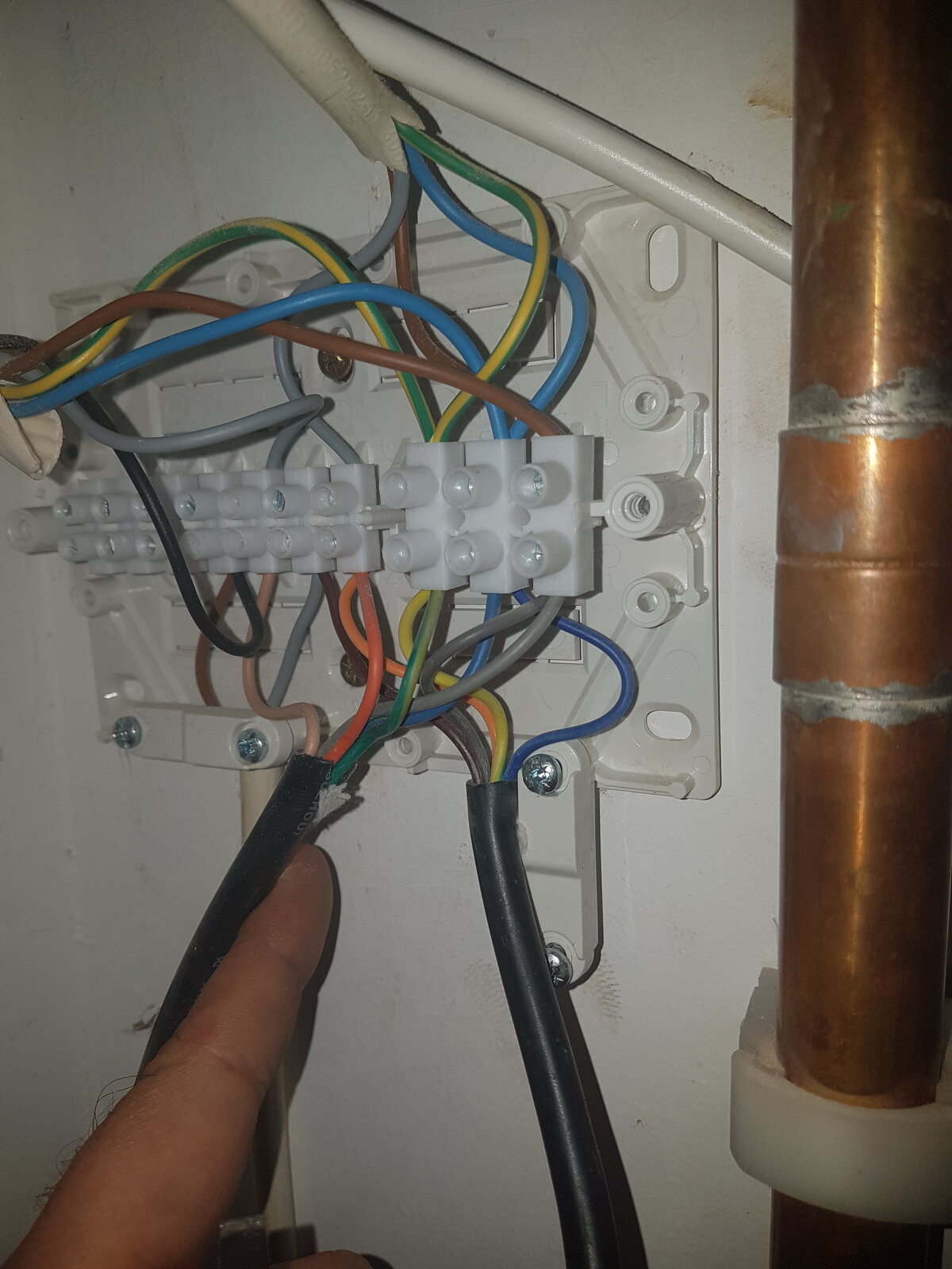

How did you remove the wires ? I know that you have posted a pic of both actuators removed from the valves, that wont make any difference whatsoever
I have removed the wiring from the wiring centre except the ground connection from both valves. Attaching images.
Grateful for your contunued assistance.
I hope you made a careful note of which terminals each wire was connected to !!!
There can't be a switched live to the boiler from that wiring centre with the actuators removed ,is there a frost stat wired directly to the boiler ?
NEVER rely on colours in heating wiring, what you are calling "ground" will be earth here , but the colour means absolutly nothing, looking at your pics some green/yellow wires are being used as lives
Which are Ian ? They all appear to be connected together in the same earth terminal block .

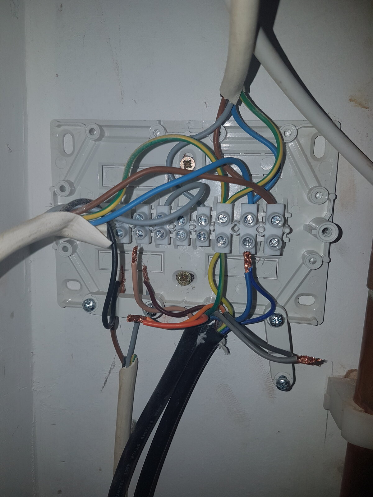

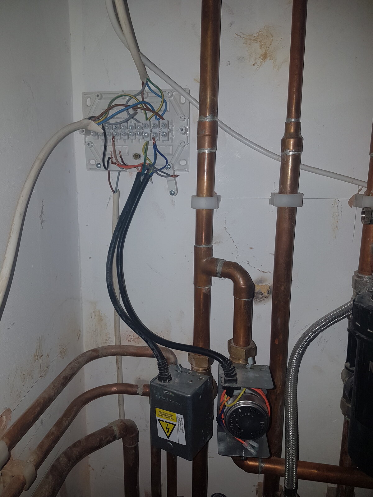

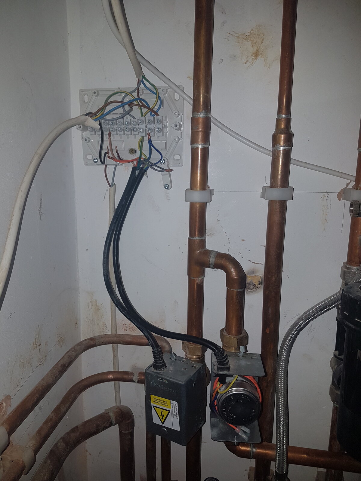

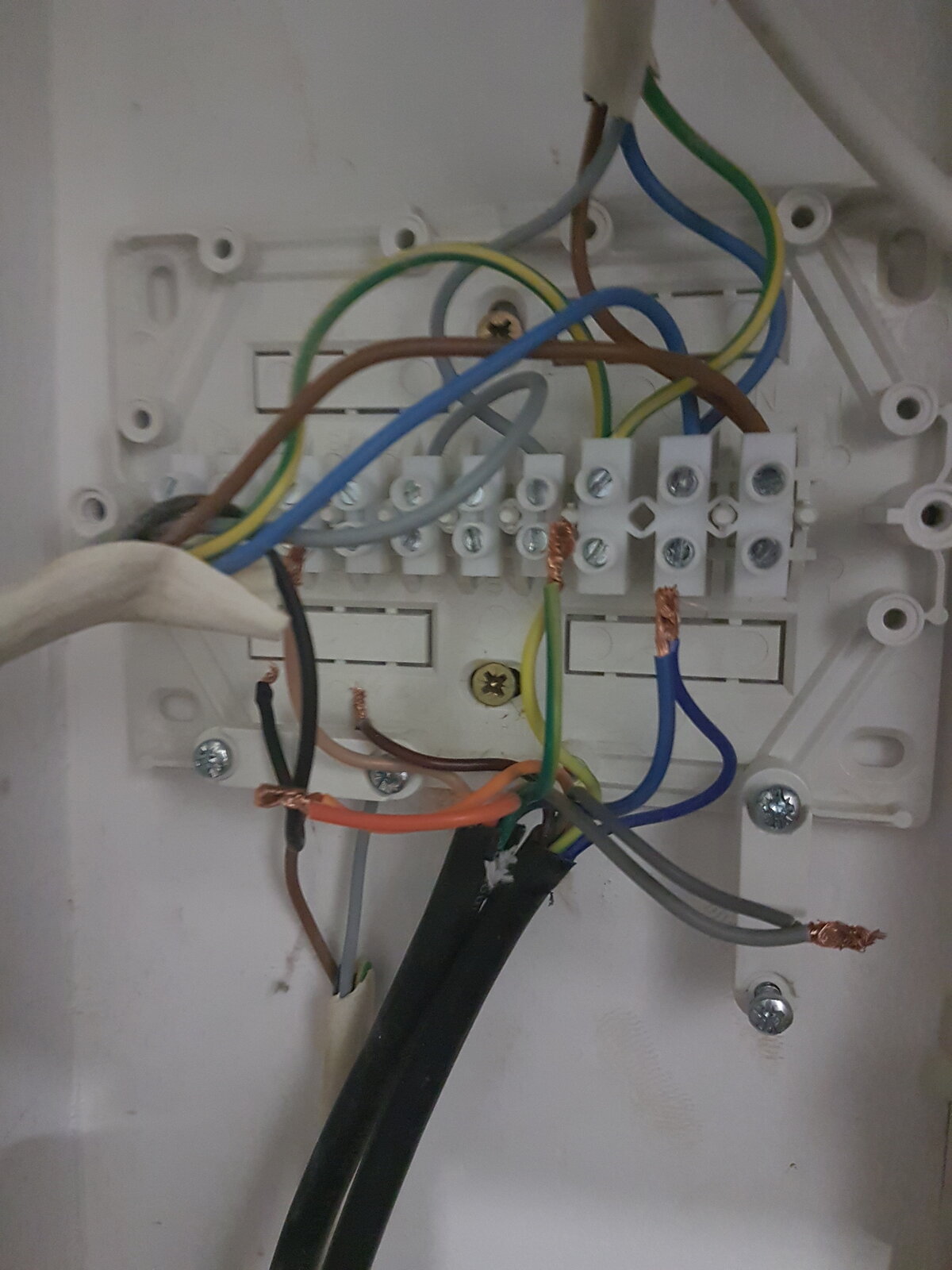

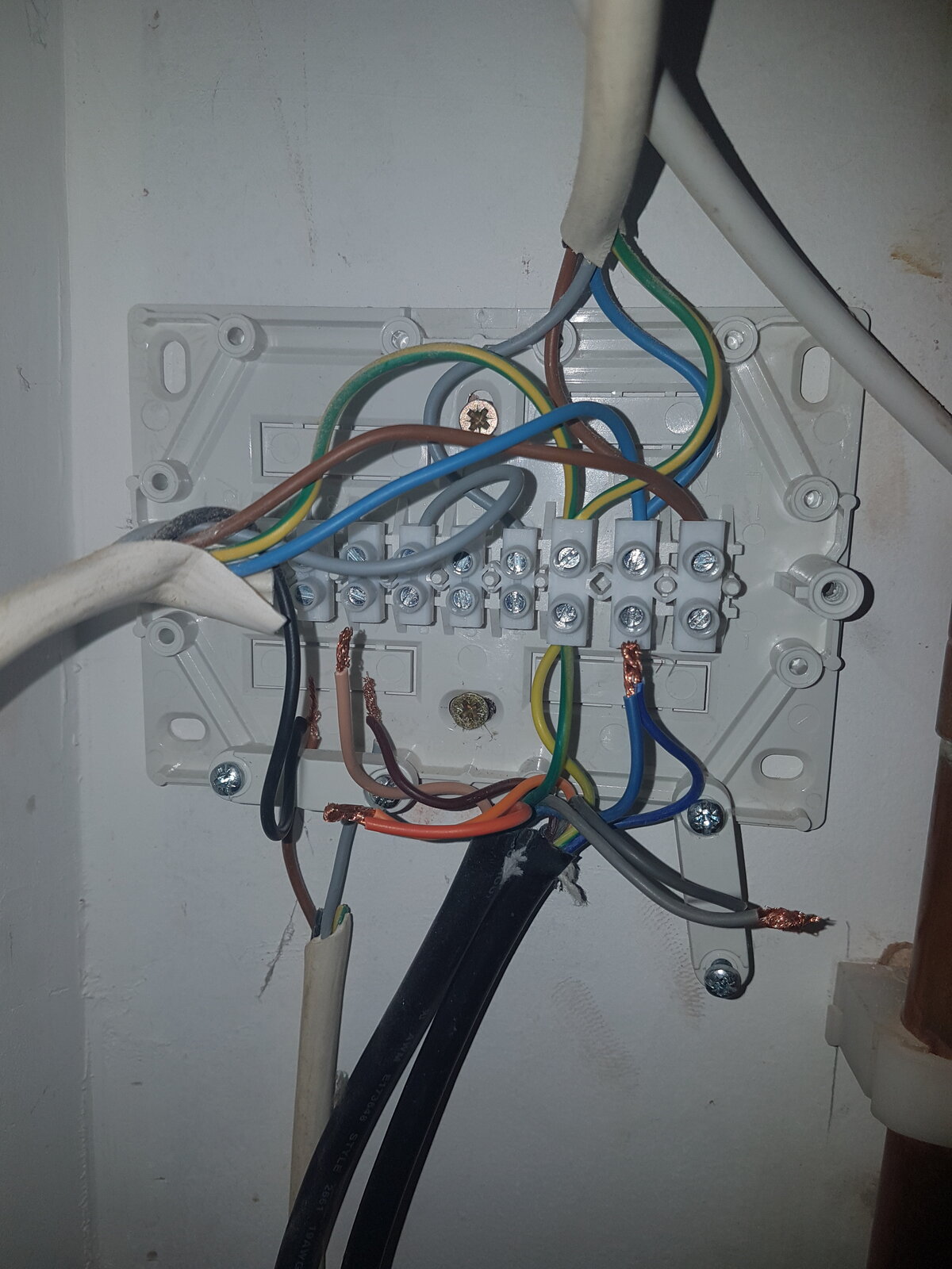

@ianmcd @terryplumb - i have now removed the only remaining connection from the two valves. I have attached the wiring image as it was befire i touched it and now. There is no change in behaviour.

The only switched live to the boiler from that wiring centre is the grey wire that is in the same terminal block as the two orange wires from the zone valves. With both orange wires disconnected there is nothing to energise it. The boiler does have a seperate permanent live ,but I can't envisage a way that could fire the boiler up ,unless there is an issue inside the boiler on the electronics side ( which is not my forte ,maybe Ian can shed some light on it)
One thing's for sure ,the issue is not the zone valves ,or the wiring centre. But an external component ,like a frost stat ,or the boiler directly.
