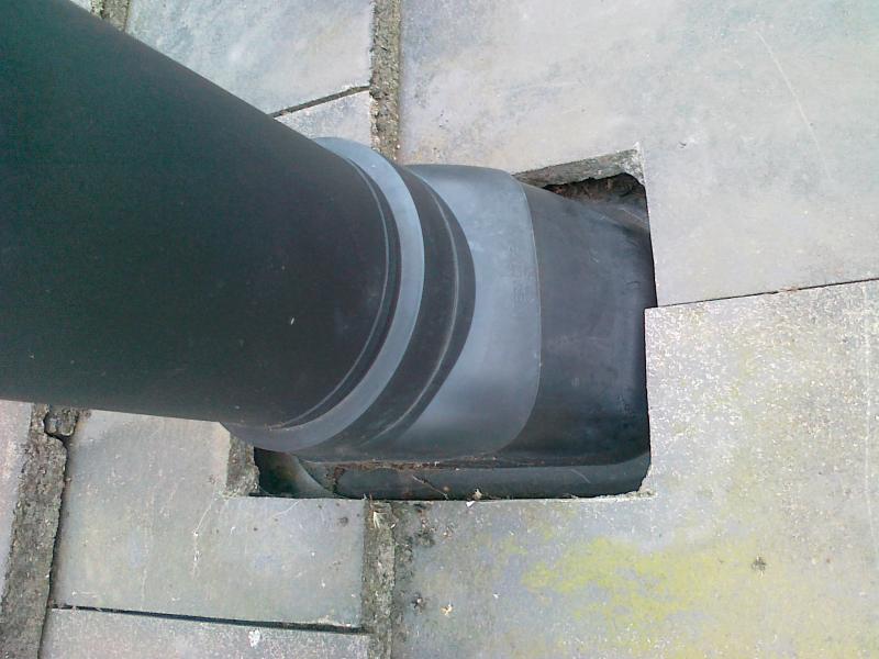

in your picture the tiles on the left (above the flue) should be over the lead slate, but the tiles on the right (below the flue) should be under the lead slate this is why you have problems the original installer put it in wrong!
