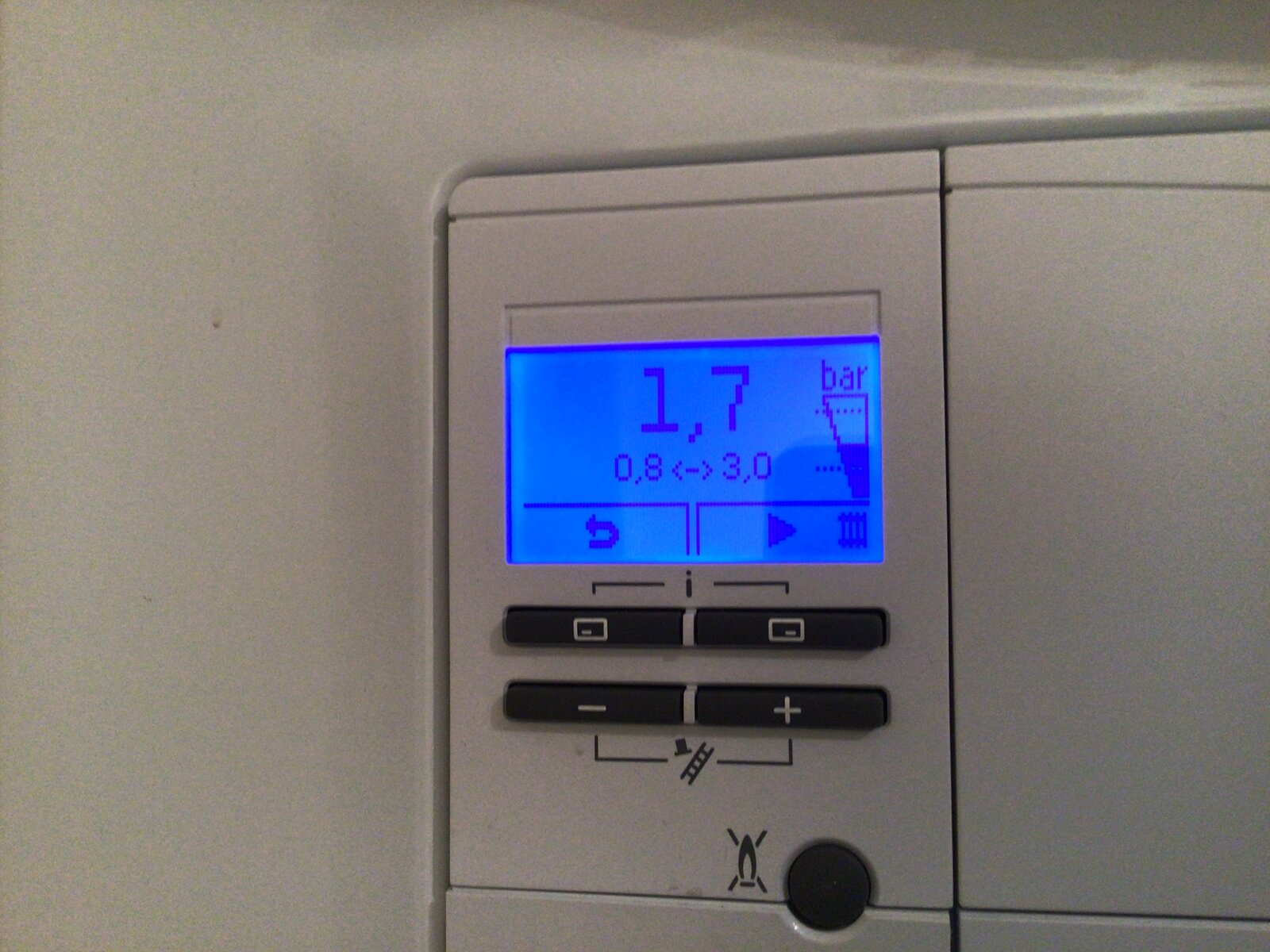

What do you mean by how much water are we putting in? The pressure goes down to .1. We get it back up to about 4.
Thanks for your help and sorry I do not know the proper words to use to explain what is happening. What is the PRV? The pressure drops suddenly overnight.
Are you raising the pressure to 4 BAR ??
If so you are creating your own problems.
Why is that a problem? It might not be exactly that. We are raising the pressure to just below the top dotted line.
Please see attached photo to show what it is right now.
Thank you.
Ok ,that's nowhere near 4 bar ,it's showing 1.7 bar ,which is fine if the system is hot ,when central heating is off and system cools ,the pressure will naturally drop to around 1 bar. As the water heats it expands and pressure increases ,contracts when cool and pressure drops.
The pressure ,when cold ,only needs to be at the lower dotted line. The system pressure should never get to the upper dotted line ,if it does there is a problem ,likely with the expansion vessel.

Next time we raise the pressure I will see what the number actually is when it is near the top line.
When it does its sudden drop, it goes right below the lower dotted line, and is on .1
When we get someone to look at it, I will mention the expansion vessel. Is this something that could have been damaged by the pressure going above the top dotted line?
