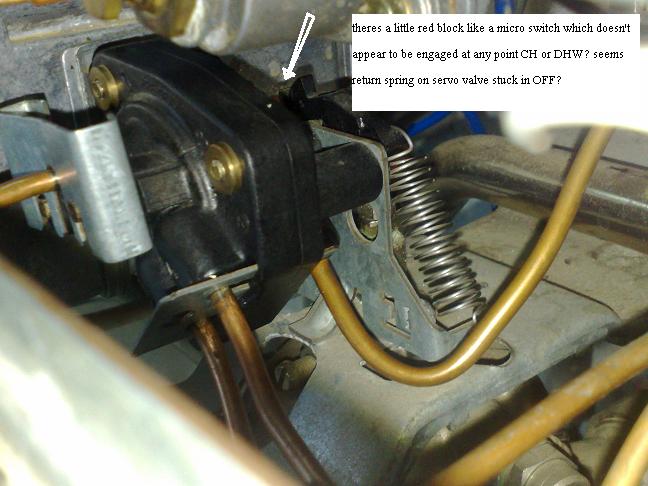

VCW 221 H - PROBLEM : pictures of microswitch + 'stuck' return spring
hot water works fine, demand, click sound, green + amber light on, boiler fires, pump on, hot water.
Central heating:no click, no green+amber, boiler doesn't fire, pump on.

manually poking microswitch behind servo triggers green then amber light and fires boiler but only for a few minutes.

Make sure the spring in the third pic has fully retracted after HW demand has finished.
As he says above, best way to check is to push down on lever as in pic so spring depresses as shown.
see if heating works as you hold this down, if so probably faulty water valve. You can adjust the pin sometimes to overcome problem, but the valve will prob need replacing sometime soon.

it seems the opposite case. the spring cannot compress any further than shown in the picture. the black lever (cam?) can be pushed in the opposite (left) direction forcing the spring to stretch and the cam to push the microswitch [this DOES activate the CH but only for a few minutes]

the push rod below the cam appears stuck(?) and at no point (ch/dhw) is it raised or lowered.

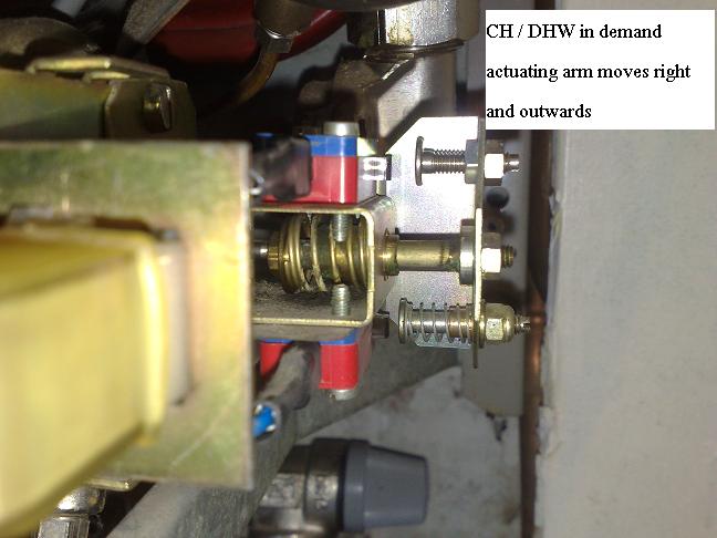

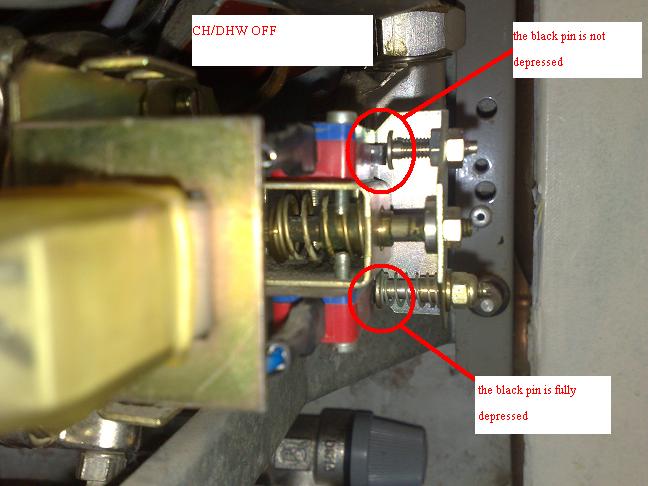

the 2 microswitches to the right of the boiler - the top one is never engaged? should this be? I ask cos one of the final steps in the manufacturers fault finding manual for the diverter valve says "check actuating lever is correctly adjusted to actuate both micro switches" this does not appear to be the case with mine, does this need to be adjusted?
The cam that you are looking at is the DHW actuator. Pin should come out as tap is turned, pushing cam upto Left and makes red micro switch.
This can be adjusted but if it does not move at all then I would suspect thats this is faulty also, although I have not worked on these boilers much.

the middle picture is right for dhw calling.
both those microswitches should be depressed when ch only is calling.

thanks for the link spacethegas, looked promising but mines slightly different. re both microswitches being depressed, why would the top switch not be depressed when CH only is calling?
I noticed the lower arm is spring loaded and perhaps requires more pressure 'from somewhere' to it to depress leftwards enough to allow the top arm to push the microswitch... i dunno
can this 'lack of extra pressure' on the lower arm be linked to the servo valve not being engaged due to the push rod not being raised to make the microswitch behind the servo? I noticed this so I dropped the water section

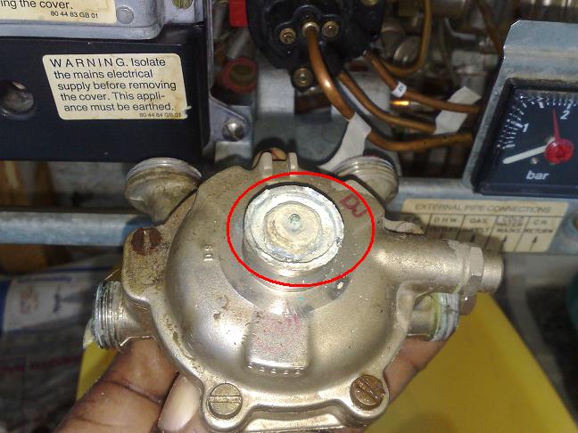

the 'pin' appears stuck and withdrawn and heavily calcified
could all of this lead to the pressure being raised unintentionaly?
lastly follwing the manual I attempted to clean the water section and have a look at the diaphram but 2 of the 5 screws are rusted/fused and wont budge, sprayed Wd40 to loosen no luck, tried carefully to unscrew but the slot is wearing away so I may have to buy a new water section (if that proves to be the fault)

so the pin on the water section must travel out when the hot tap is opened in order to move the cam to operate the microswitch.
diverter microswitches
boiler off- top micro out. bottom micro made.
hw on- both micros out.
ch on- both micros made.
the servo valve & those little tubes make that happen.

Re-charge the expansion vessel as per FAQs. It's a fiddle getting the pump onto the schrader valve on these boilers. It's also normal for a small initial quantity of water to drain from the vessel. If the pressure has reached 3 bar (or near) you may find the safety valve has opened...so check for leakage.
Tapping the screws with a hammer can sometimes free the threads. A cordless drill (impact driver even better) can also help free them. Good quality pump pliers on the screw periphery normally shifts them.
If you can get it apart replace the diaphragm and stuffing gland...clean the pin and the insides thoroughly (de-scaler?).
Check the adjustable operating pin is free to move...sometimes the plastic sleeve becomes ccontaminated and swells.
Pop off the spring and check the cam operates freely...sometimes leakage on the O ring seal prevents full return. Unless you know the condition of the servo valve you may want to consider replacing it. I have stripped them down and cleaned them up sucessfully. The tiniest amount of muck can prevent operation since the device consists of two ceramic discs (similar to a 1/4 turn tap). Different ports are lined up in each posistion to revese the control pressure on the diverter diaphragm.

anyway I seem to have got the CH working ...for now. the top micro now makes on CH where it didn't before - ever, apparently the bottom micro sort of makes in 2 stages on phase 2 the spring on the lower arm compresses further leftward to make the top micro.
gasguru thanks for the massive rundown. fortunately the air vent, and pump were replaced by BG about 18 months ago. I tapped the screws, even put a lighter flame for a few seconds under the 2 corroded ones, no joy, I did still immerse the water valve in descaler, stripped the servo, it appeared to have a rusty film, used a soft brush, checked the spring, cam was moving freely, descaled and lubricated the push rod behind the servo, re assembled and it fired up nicely. the upper micro made for the first time.

thanks for the tip Agile, I do have an impact drill though my concern was that the problem screws happened the two that didn't go straight through? (ie 3 of 5 are visible from both sides and the stuck 2 appear to terminate within the body of the water valve) anyway I'd imagine it easier to drill and pick out the debris if I was drilling straigh through. but that's for another day.
to help me understand what happen (should it happen soon again) before I stripped the servo and descaled the water valve replaced some broken washers the microswitch showed a delayed and sluggish response to DHW and CH demand and when demand stopped it held for a while and then slowly depressed so the lower micro made and the upper micro didn't.
after: the micros react smartly on demand and return smartly both micros being made when DHW is stopped.
given all my symptoms and pictures is any of you able to put a finger on the exact part that makes this possible.
I'm worried the present working state may be a fluke and would like to be sure the steps I took are directly linked to the upper micro now making.
also Agile, where's the best place to source replacement screws for the water valve ie is there a code or measurement to google? as they are not everyday screws.
Impact driver for the screws or gas axe at kwik-fit.
