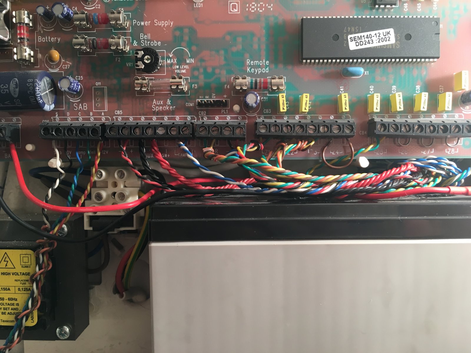

Just for my information, so I get the wires have been doubled up from the pir to CP Z4, I assume the red and black from the pir go to the CP AUX, but I’m not sure where the white and blue wires from the PIR end up at the CP. Should they be running to the tamper on the CB5 terminal on the CP (I believe this is the global tamper)? Since I only see two wires here maybe there is a hidden terminal block where all the tampers are joined? Sorry if this is nonsense, just trying to learn.

On the panel it looks like the global tamper zone is Blue and White cores, the N/C alarm zones are Green and Yellow cores.
If that’s the case on the terminal block you have linked the G and Y together to form a closed Zone circuit (correct) but you have separated the B and W (tamper circuit) so this will show a tamper fault, you need to link them together.
Ok, yes that makes sense now, so I’ve broken the global tamper circuit by not joining the blue/white together.
One step at at time ....remove the blue and white wires in the pcb marked TAMP ....put in a link ( as you have on zone 4 ) box it back up and press reset ....if it clears all good ...move on to the next step ...

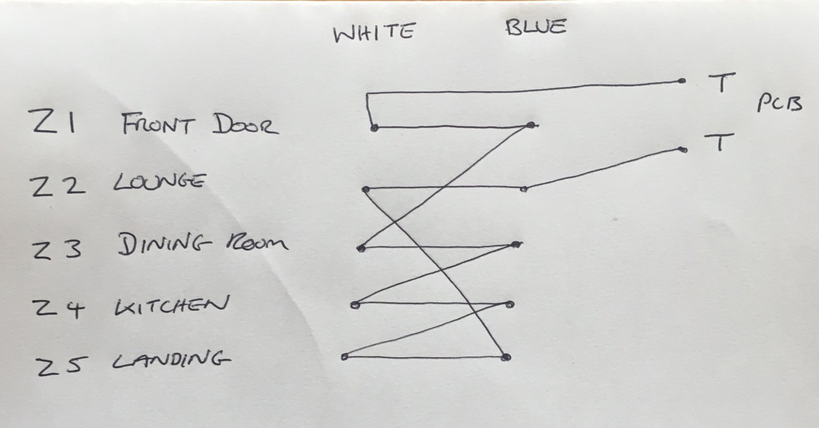

I’ve made the complete tamper circuit by tracing all the wires
Then I checked the continuity. Checking white that connects to PCB tamper didn’t work when connected to the dining room.
I checked blue from PCB tamper to dining room and it was fine.
So i think this tells me there is a problem with the cable that runs to the door contact. Didn’t get time to take wires off door contact and join them to test if it’s the cable or door contact at fault.
Does what I’ve done make sense?
